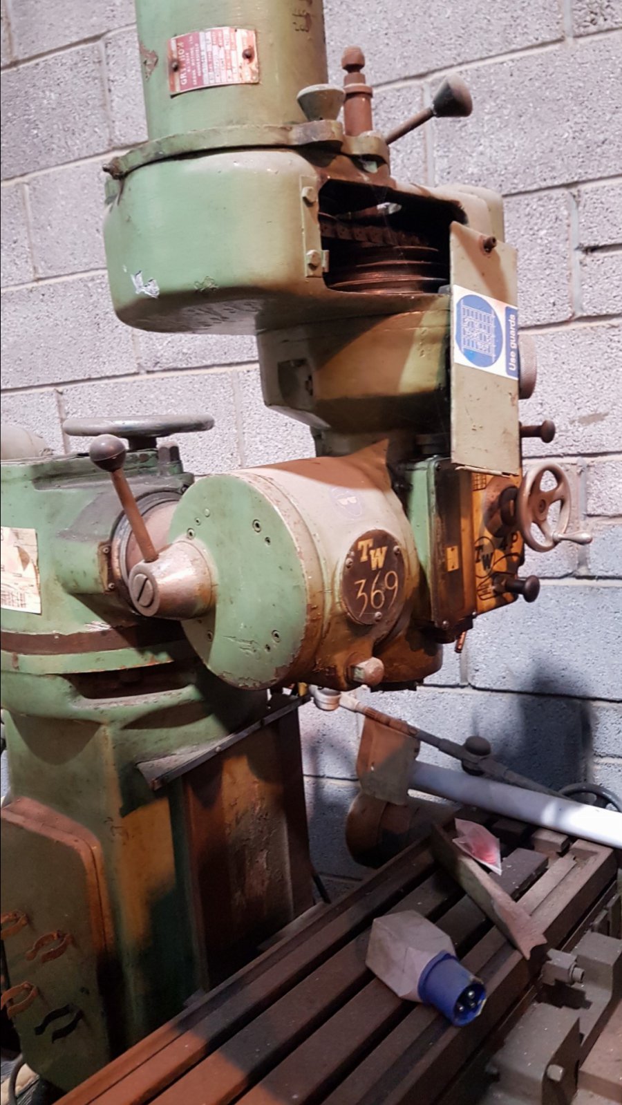

I have had this milling machine in my warehouse for quite a few years. I run Speedshift which is a pallet shipping company. This mill was subject to an insurance claim as it fell over in transit.

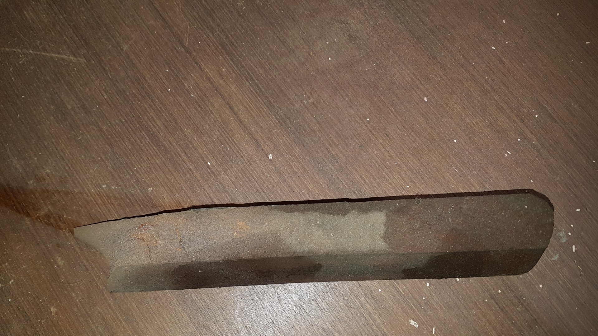

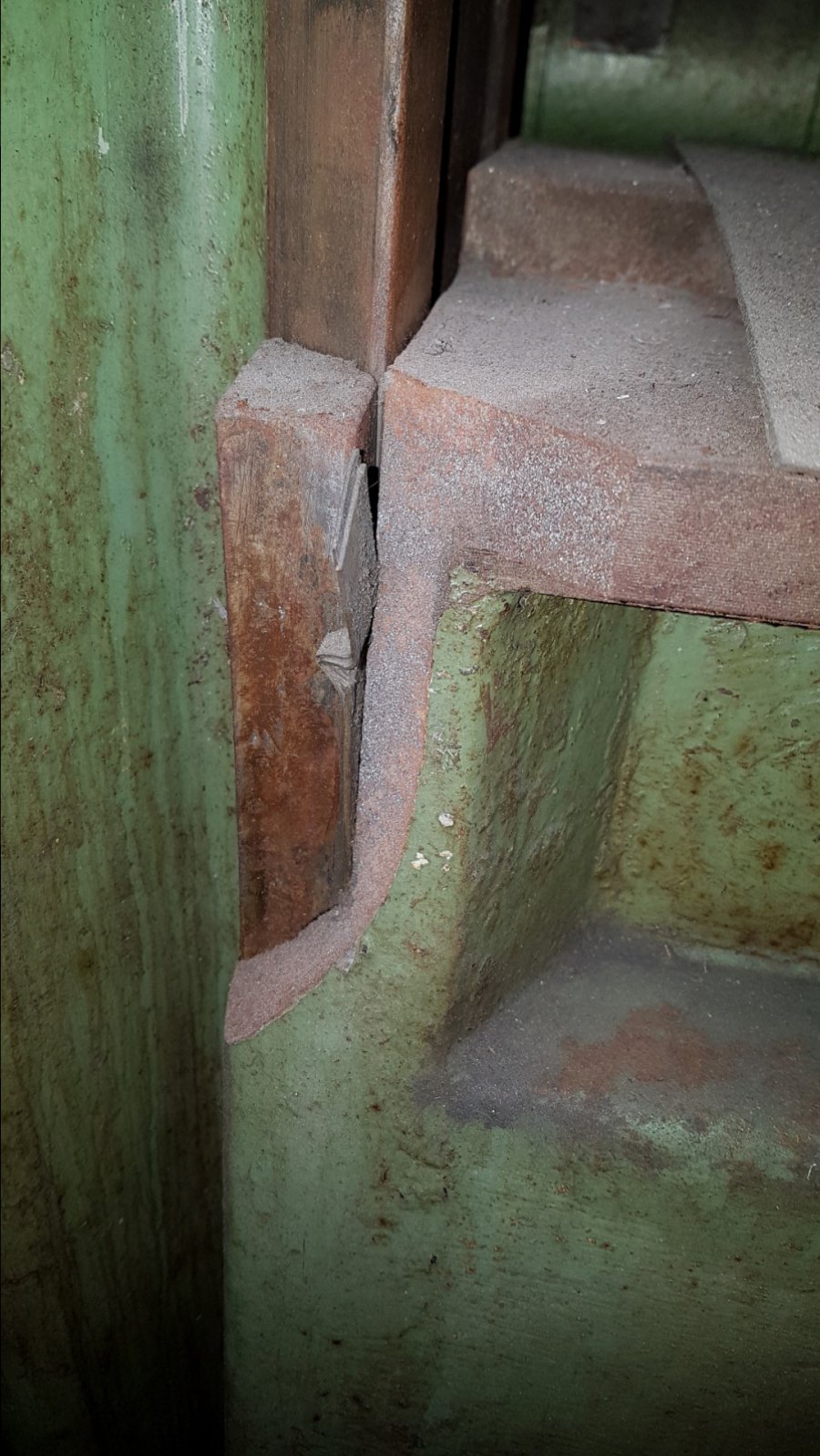

When it went over the table hit the ground which twisted the knee. It bent the table leadscrew at the end. The knee casting broke at top left and bottom right. The head had a whack but seems fine. The quill works ok.
It looks like it was a lovely old machine a bit bigger than a Bridgeport. I don't have a vertical mill so can it be fixed? I doubt there is much force where the castings broke. Perhaps braze or stick weld it?
