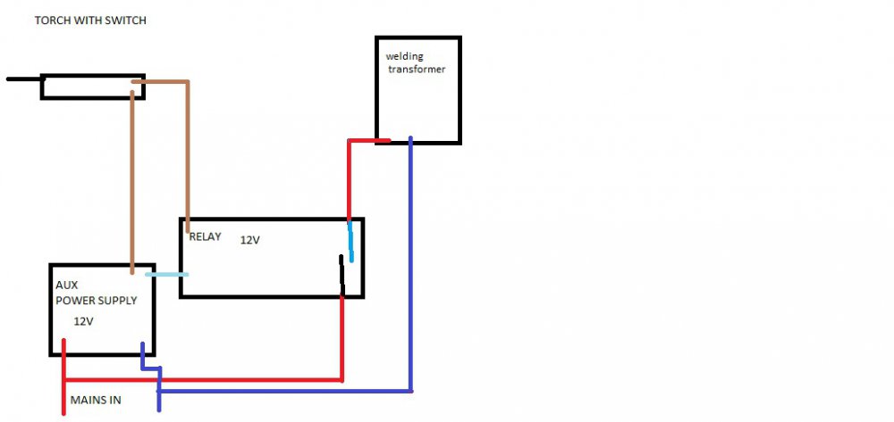

You can use the switch you already have on the torch I would imagine that since you will be using the new circuit to power on and of the main transformer you could simply join the existing wires together in the welder as there will be no power to make the motor run until the welding transformer has power
