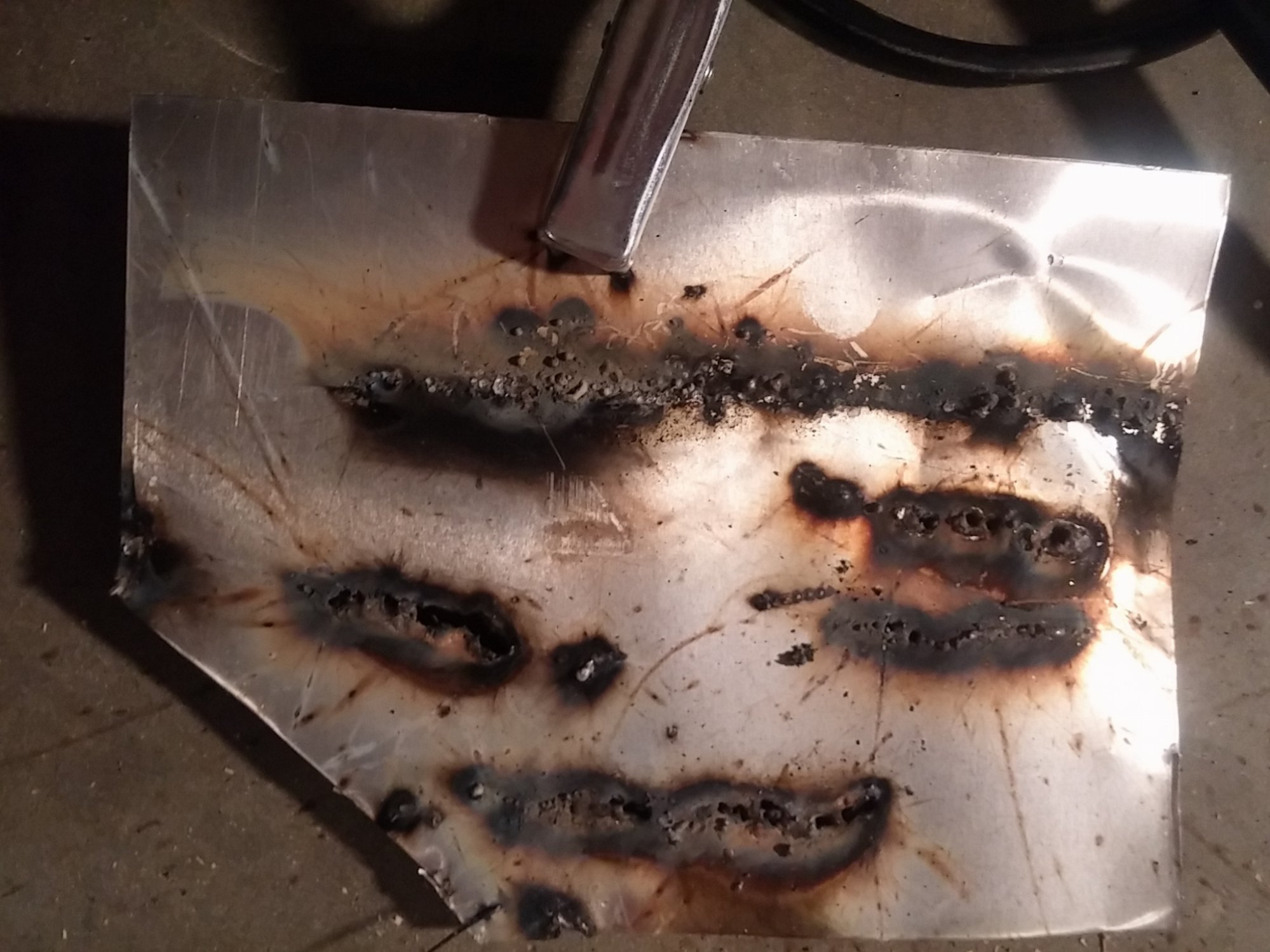

Hi, I'm new to this forum & new to welding of any kind (I've done some braising). I need to make multiple stainless steel boxes that are welded, so I bought a cheap gasless welder off of eBay (I don't have a lot of disposable income). It's black & called the "130". It's always "on" (regardless of whether I push the button) & has no polarity options. I was practicing on SS sheet metal but no matter what settings I change or how fast or slow the wire comes out or what angle I hold it at, the metal turns black, burns through & spatters. I've watched video after video but none of what I'm doing looks anything like what I see in the videos. What I was hoping someone could tell me is if I keep practicing will I ever be able to weld this SS sheet metal with this machine or should I just return it and try to save up for a better welder? Please see image (this was my fifth piece of practice scrap) & thank you in advance.
unfortunately stainless steel flux core wire is rather expensive and usually only available in 15KG reels. Plus.. flux cores wire runs hotter than has shielded wire and on 20 gauge you'd most likely end up blowing holes even at low amps.
