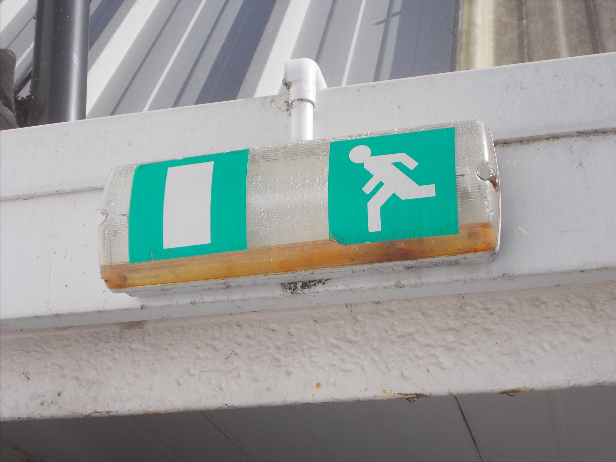

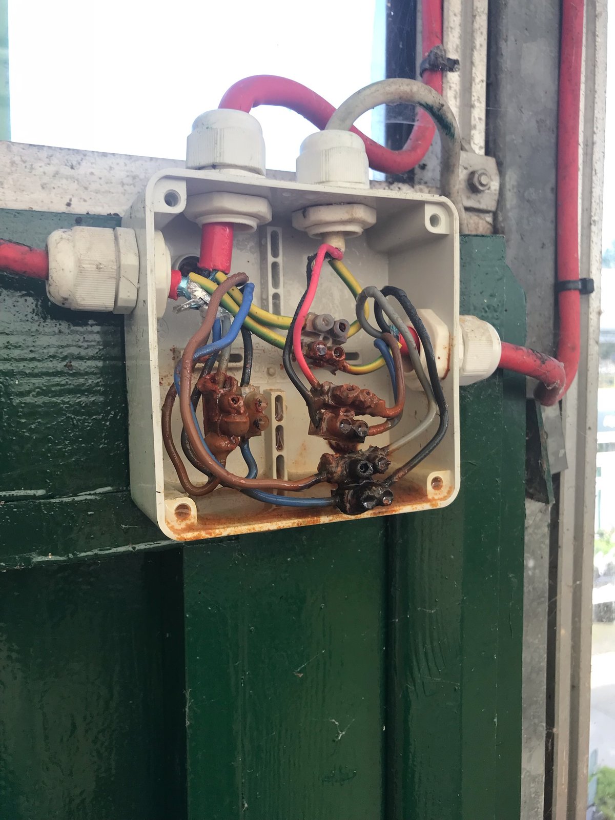

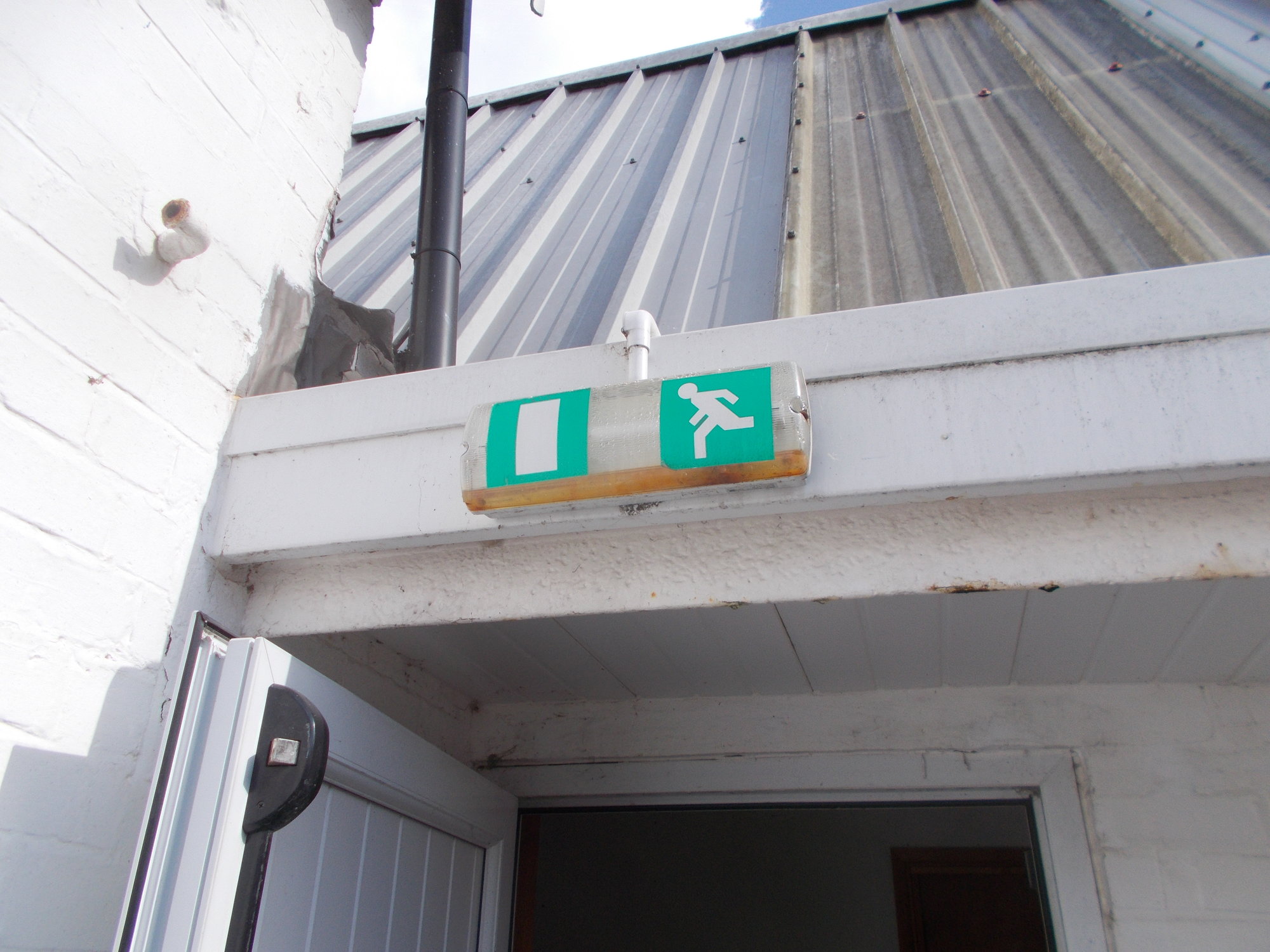

I drill a small hole in the bottom of the emergency lights I also seal round the fixing screws and back entry with silicone
