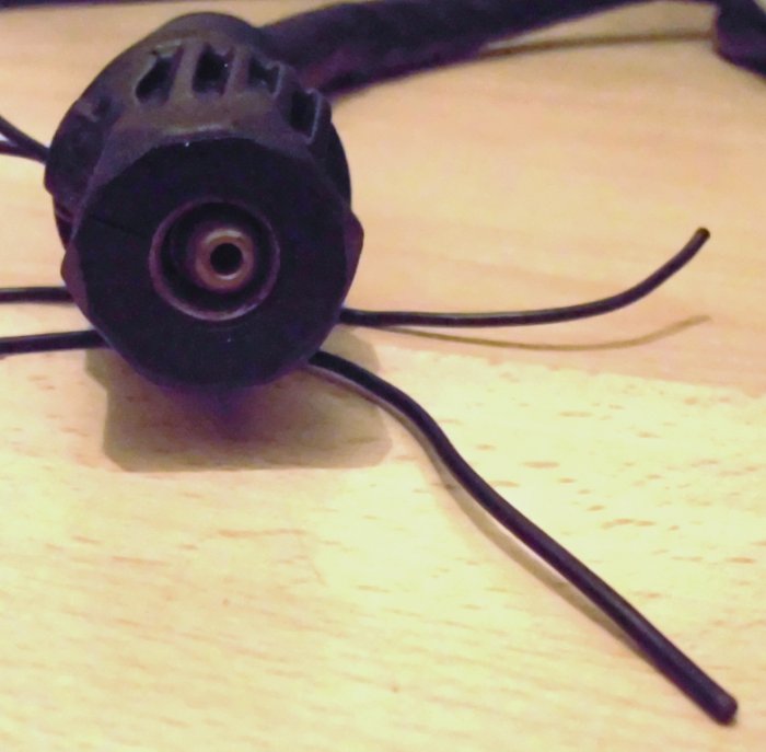

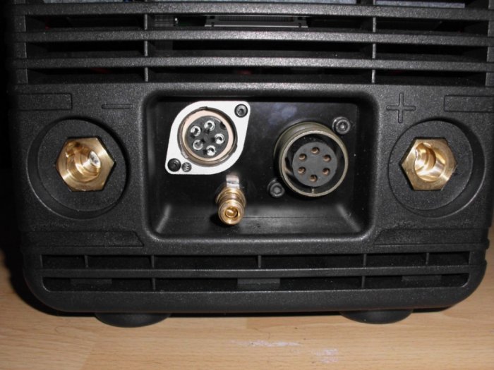

have just purchased a invertec V160-t inverter and want to use a kemppi torch with this machine but connecting them together is not straight forward. have already picked up a connection for the trigger which i will in due course solder onto end of torch. the problem is the gas and current connections. the kemppi torch i have has the gas and current into the same connection and then the two wires for the trigger. the inverter has a different system, the terminals for current with separate gas outlet. so what i want to do is get the current and gas flowing into a single connection on the torch, i think i may need a piece (maybe adapter of some sort) with 35-50 male terminal at one end and the other end tread for fitting into torch (female, same one as on side of regulator) this piece will also need a pipe at the side for connecting for separate gas outlet on inverter. please view the pics for better understanding, has anybody had any similar experience as this.
