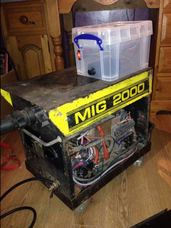

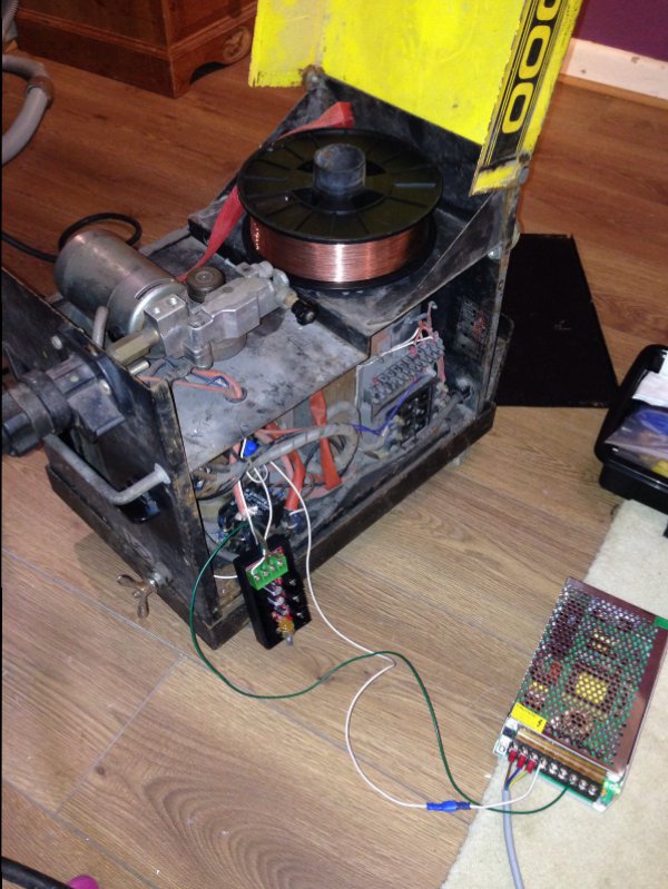

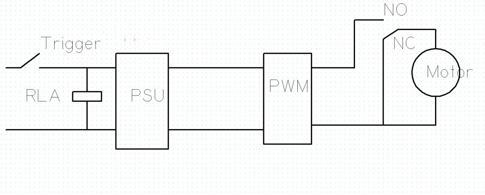

So after a few messages too and from with people who make pwm controllers and a chat with a really helpful chap named mike on the forums I've taken a route with (what I've welded with it so far) a fairly old decent welder.
Stitch timer was removed before my ownership but there was obviously a wire feed fault and previous owner removed the controller and diy'd a psu. I've gone the route of switch mode power supply and pwm controller. I've utilised a switching relay to activate the 24vdc output.
My question is do I create a small boxed up wire feed controller mounted on the lid of the welder or on a trolley. Or do I try an squeeze it all in and power it off the main internal voltage switch? Any pros and cons either way?
Also, any advice on a motor brake? I haven't put wire through it yet so don't know how much the pressure of the roller and the weight of the wire roll will slow the motor down, but currently it runs on quite a bit!
