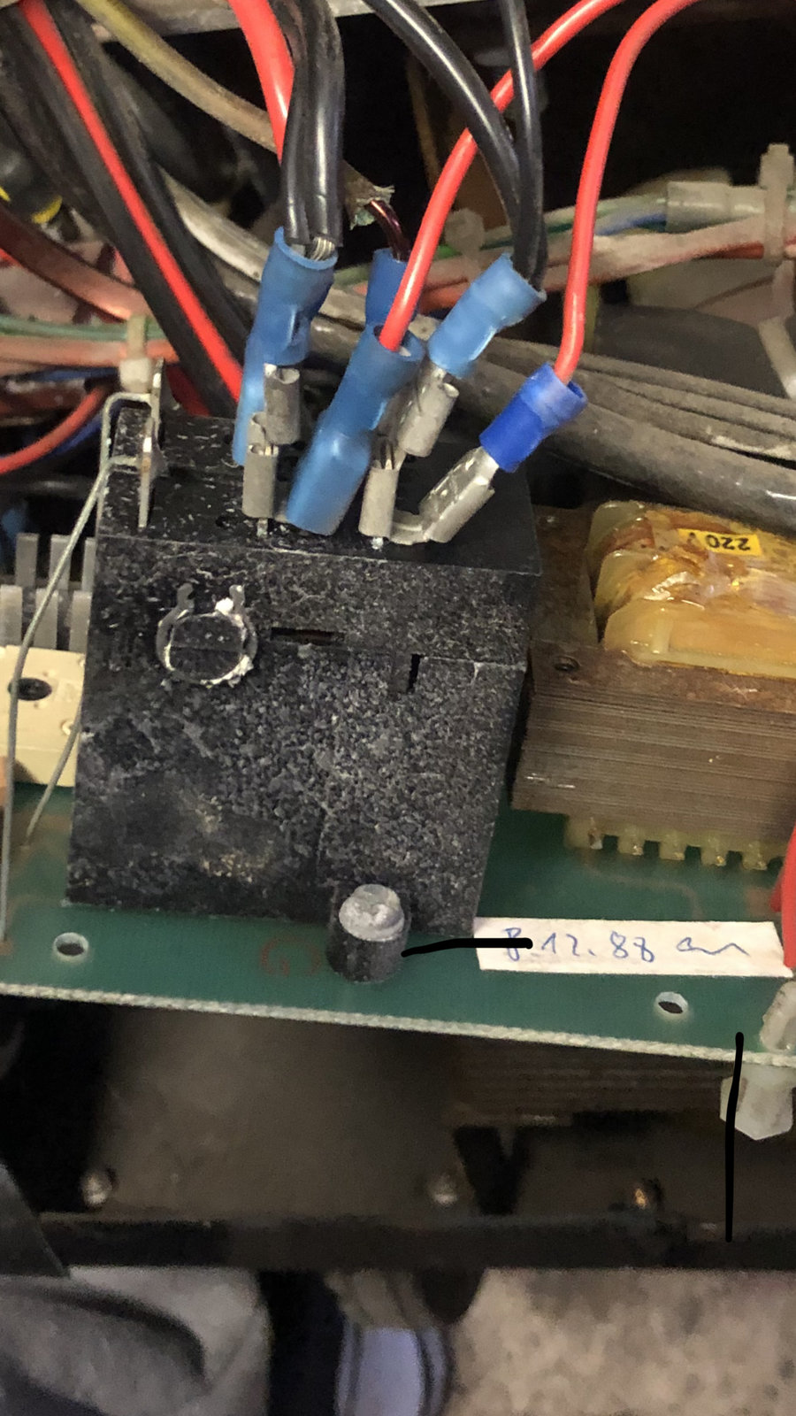

hello all and thank you for having me here i have recently acquired an old interlas solarmig 160 in very good condition.The problem i am having is intermediate power and wire feed issues sometimes the gun will feed and weld sometimes it wont i have narrowed it down to what i believe to be this part above but have no idea what it is or how to find a replacement. I have not got alot of experience with welding but do enjoy it so would like to fix this problem any help would be great.
