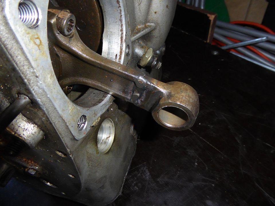

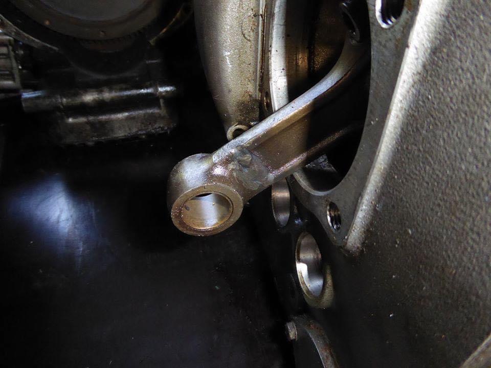

No, its modified,someone has shortened the rod, normally they are symmetrical with no grinding.So it's normal then? That would make sense....kinda. More sense would be to forge the cutout in the rod.

shortened to use different pin height pistons?

Back in the 70's an American chap used to bore and stroke the Honda XL350 to 500cc using the standard conrod by heating the middle and compressing it in a press. It looked odd but he never had a failure.

This is where I am with this , cant think of another reason to cutnshut a conrod. Its a forging at the end of the day so it should weld without compromising the integrity of the rod.

It's not often I disagree with what you type @80b, but in this instance I do - the weld will undergo cyclic compression and tension stresses, as well as any side load if the guy hasn't got it "cock on". Maybe for shows, pootling around on idle jets it might survive, but I wouldn't bet a penny on it surviving the full throttle treatment for long.
I like seeing a welded repair, but this is a bit beyond imho.
