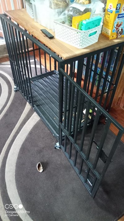

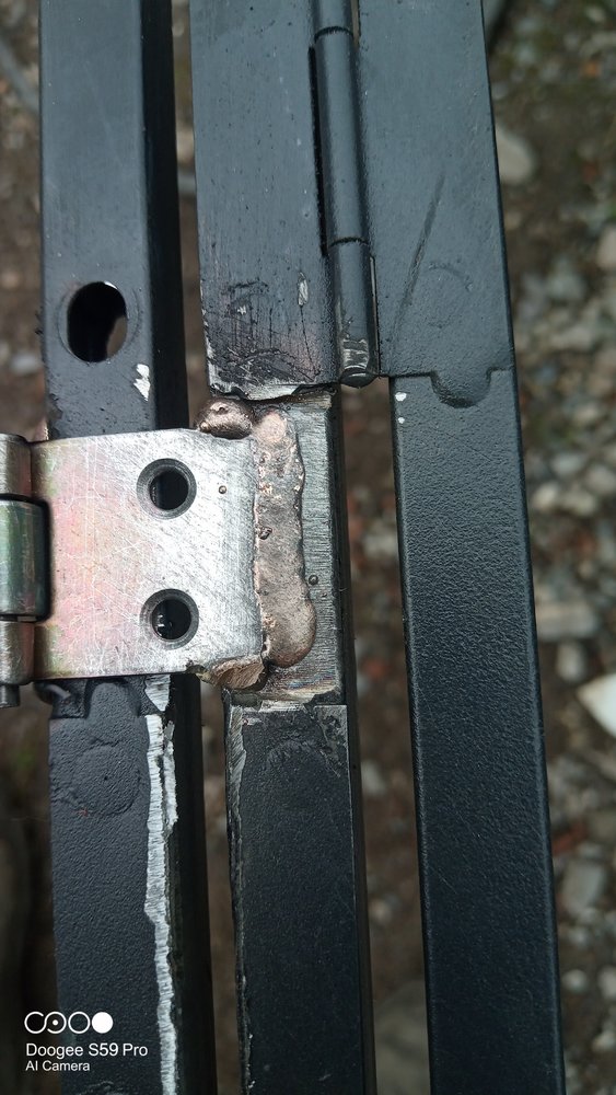

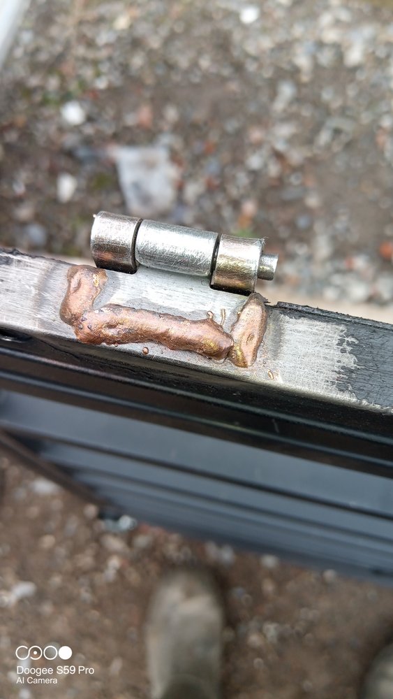

So after reading the cheap brazing wire thread and having fancied a go for a while I ordered a roll.
Being a tight git I did not want a second gas cylinder unless actually needed and I was going to do more.
So I used the cylinder of heavy mix that I have. Yes a little sooty but not to bad for a first go.

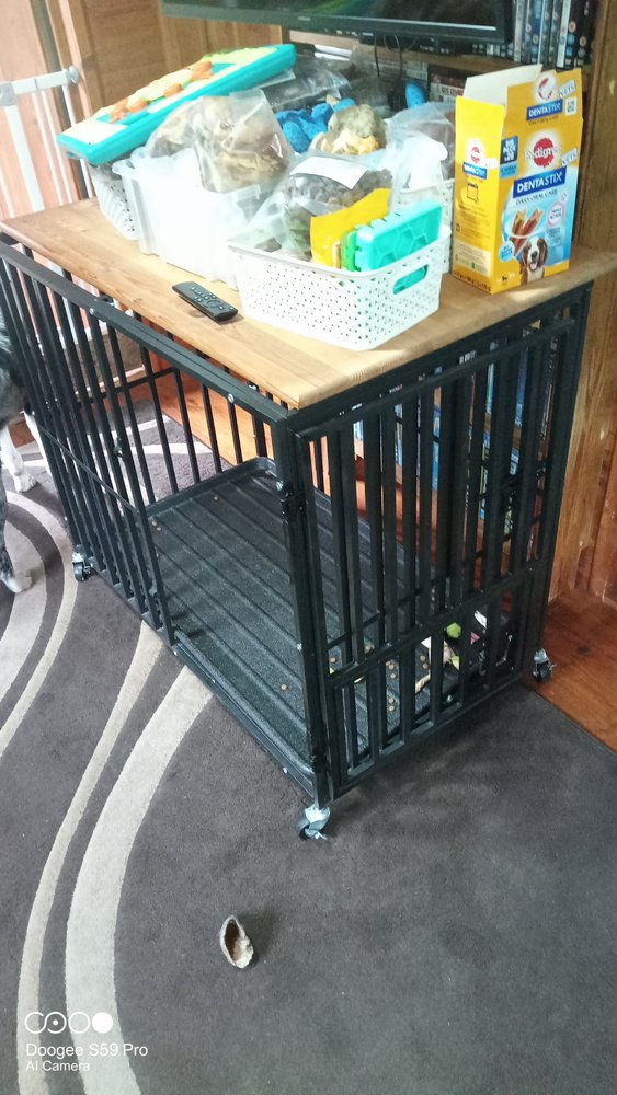

The job was a large dog cage that the hinges only opened 180 degrees. Total pain in the bum. So I fitted some bigger hinges to allow 270 degree opening getting the door out the way.
Yes I could have just welded it. But where is the fun in that?
This seems the best one.
