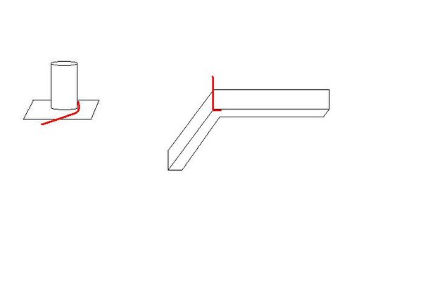

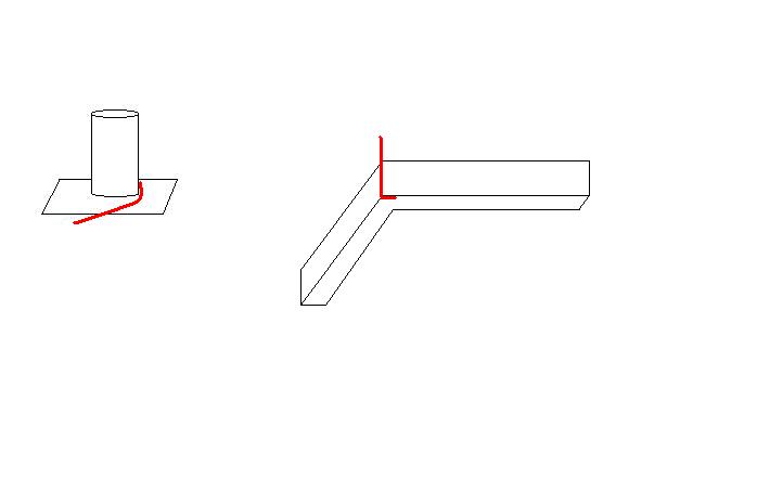

For accessibility you can just bend the end of the filler to keep your arms from getting crossed up. Picture a tube to plate fillet weld that you can't move around- to get the filler in at the rear of the joint your filler arm is going to be across your body, close to the torch hand and the filler is gonna be 'sprung' against your body but if the end is suitably bent...
the weld becomes a lot easier, especially if there are other obstacles around too
