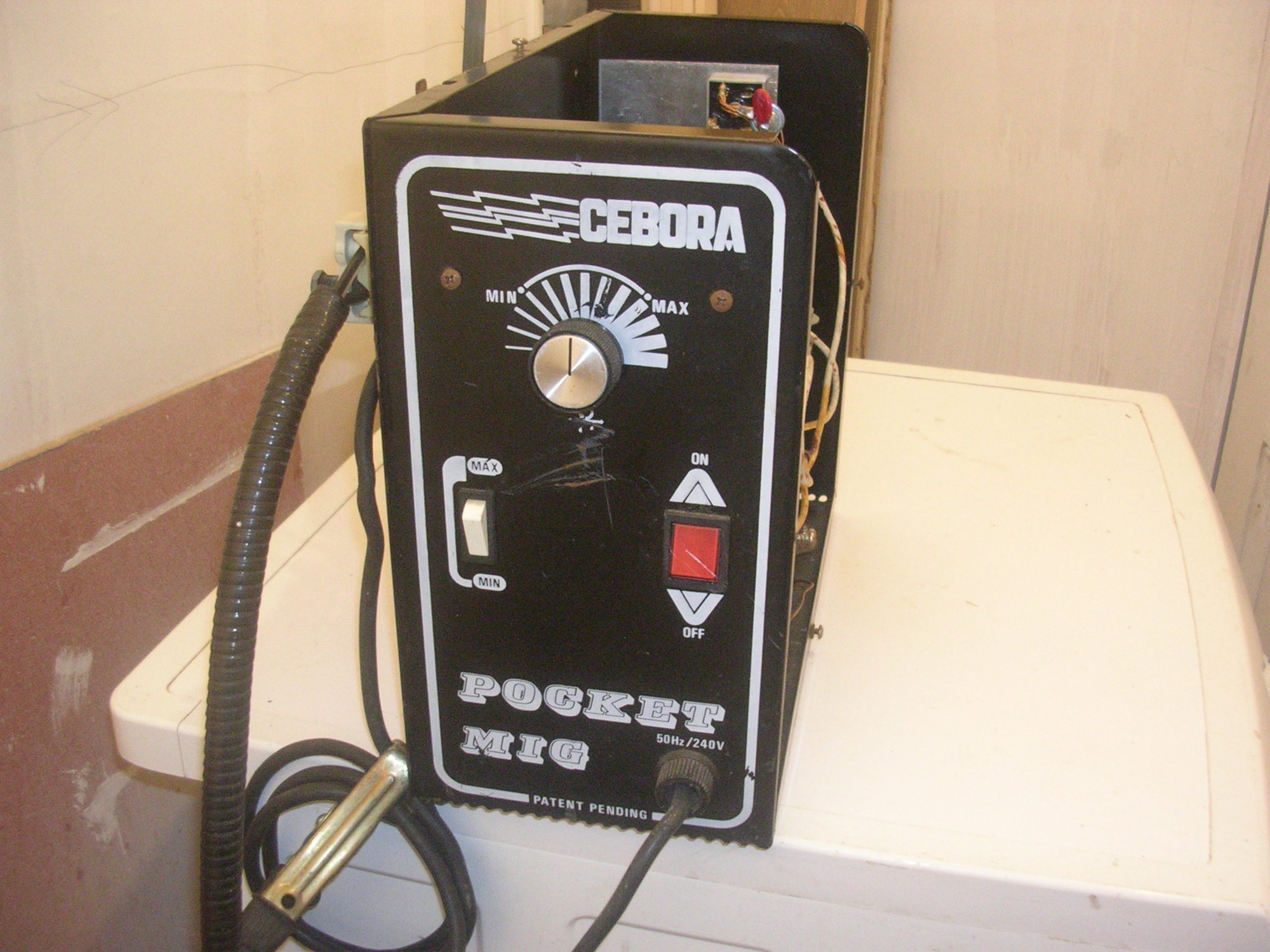

I think I've now found the definitive Paleolithic version:

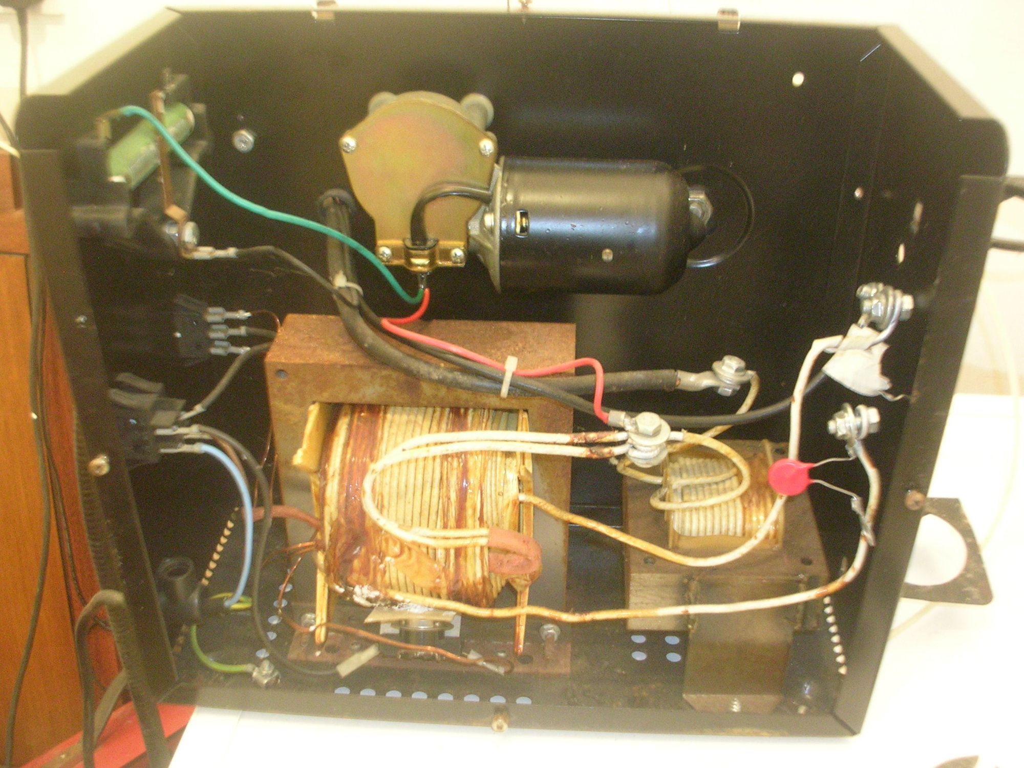

Dissection was revealing. Here we have a huge drive motor with a single wire groove on the spindle, no roller; you are to use 0.6 wire. Centre tapped transformer and a half wave bridge rectifier (removed)
There's no wire feed PCB, the astute may have spotted. That'll be a 'live' torch, then...
It's got a rectifier or transformer problem but I'll try and fix it.
