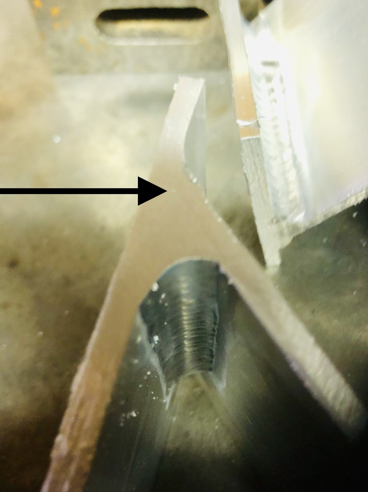

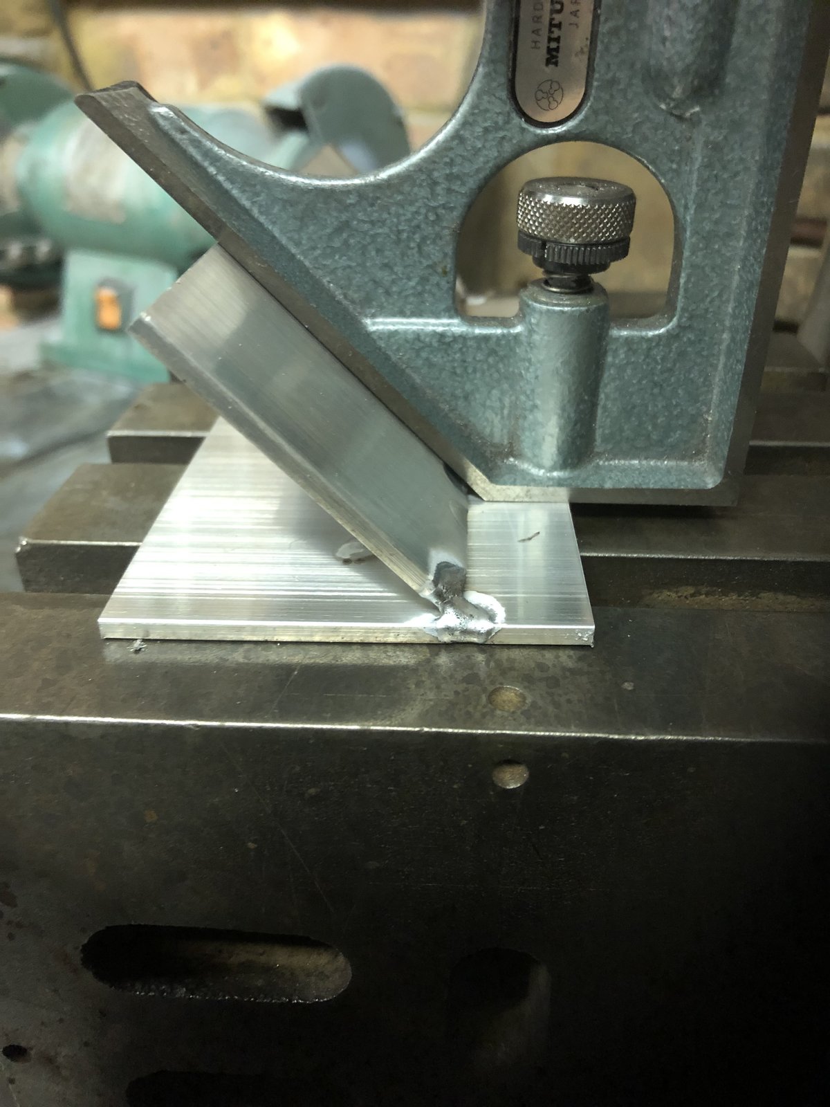

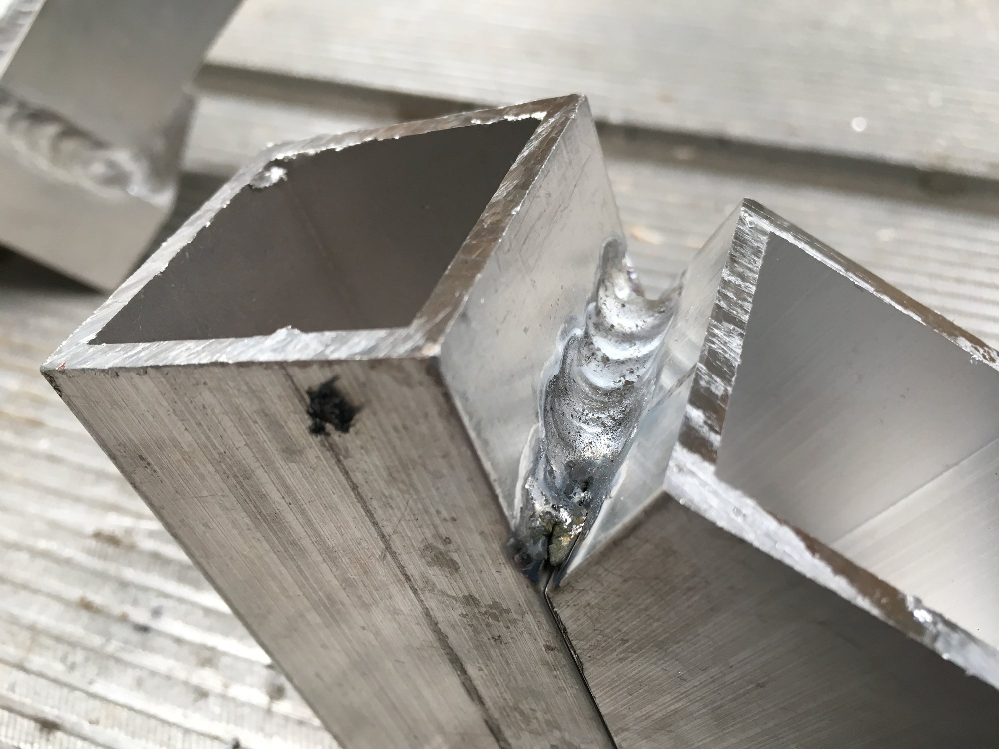

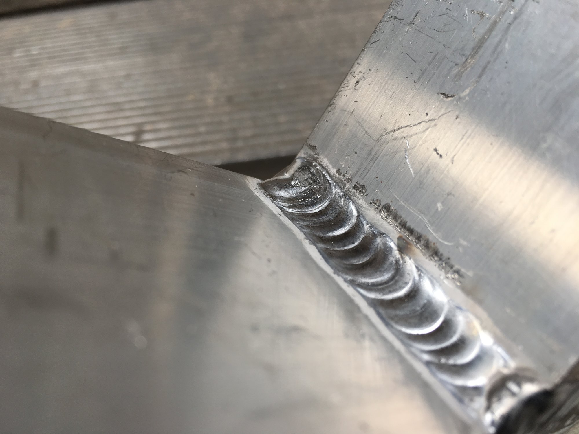

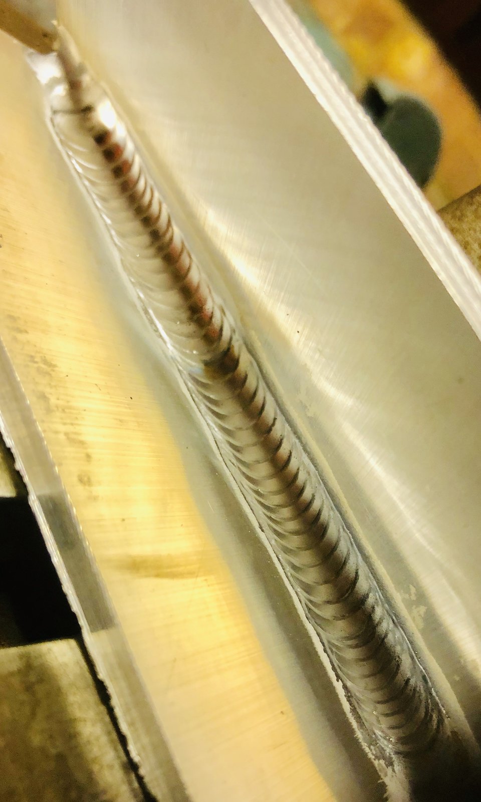

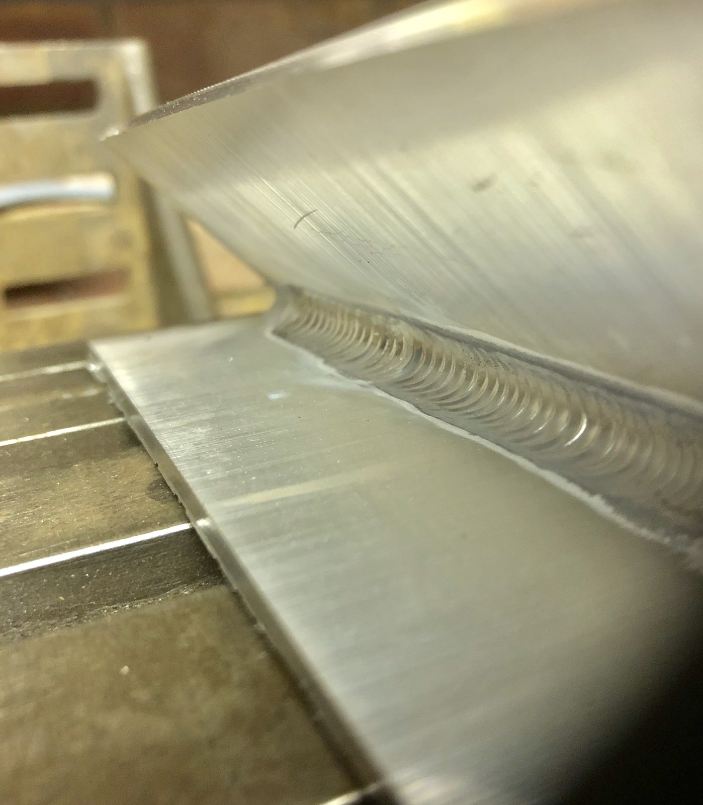

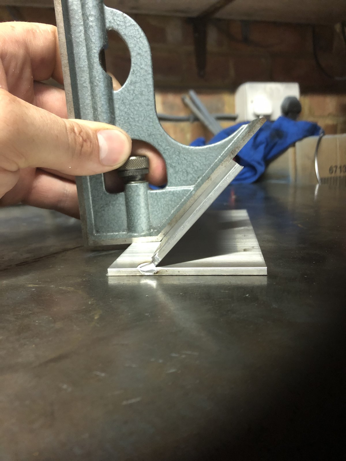

looking for some tips for welding 45 deg inside corner like in this video, but with 1/16" wall 1" shs

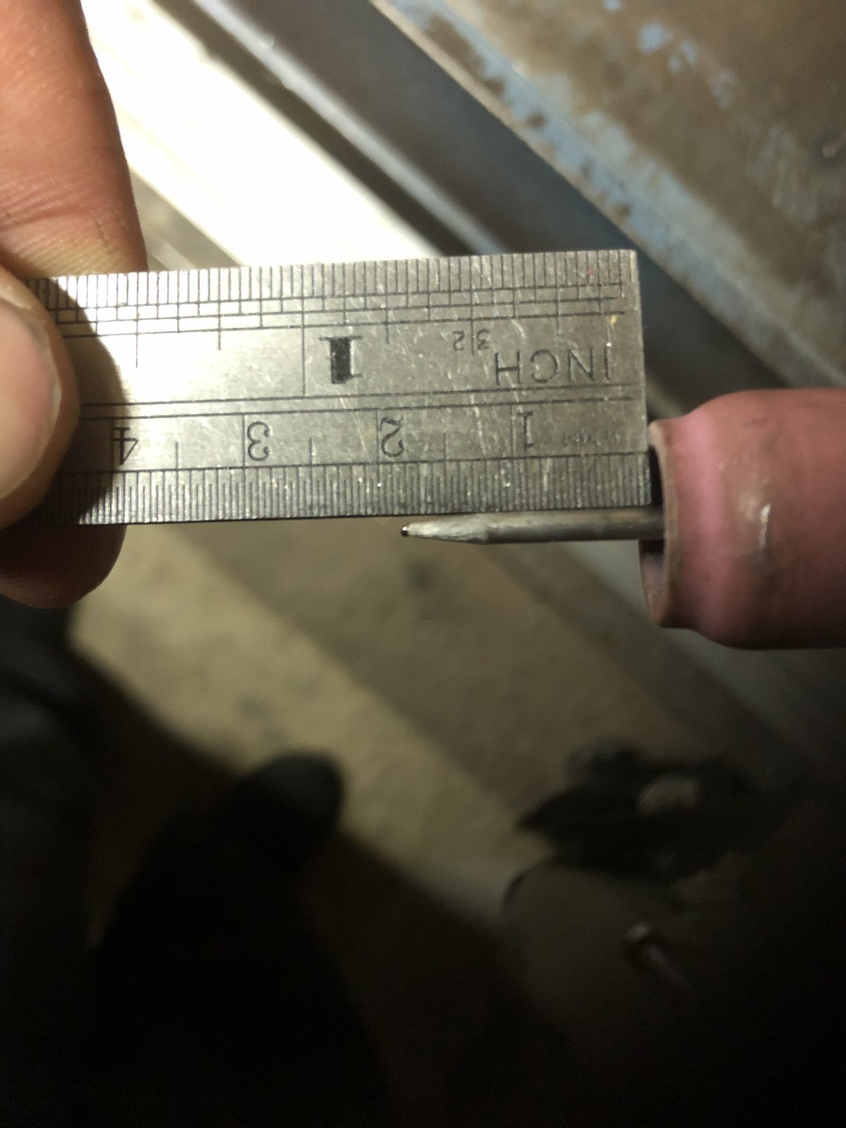

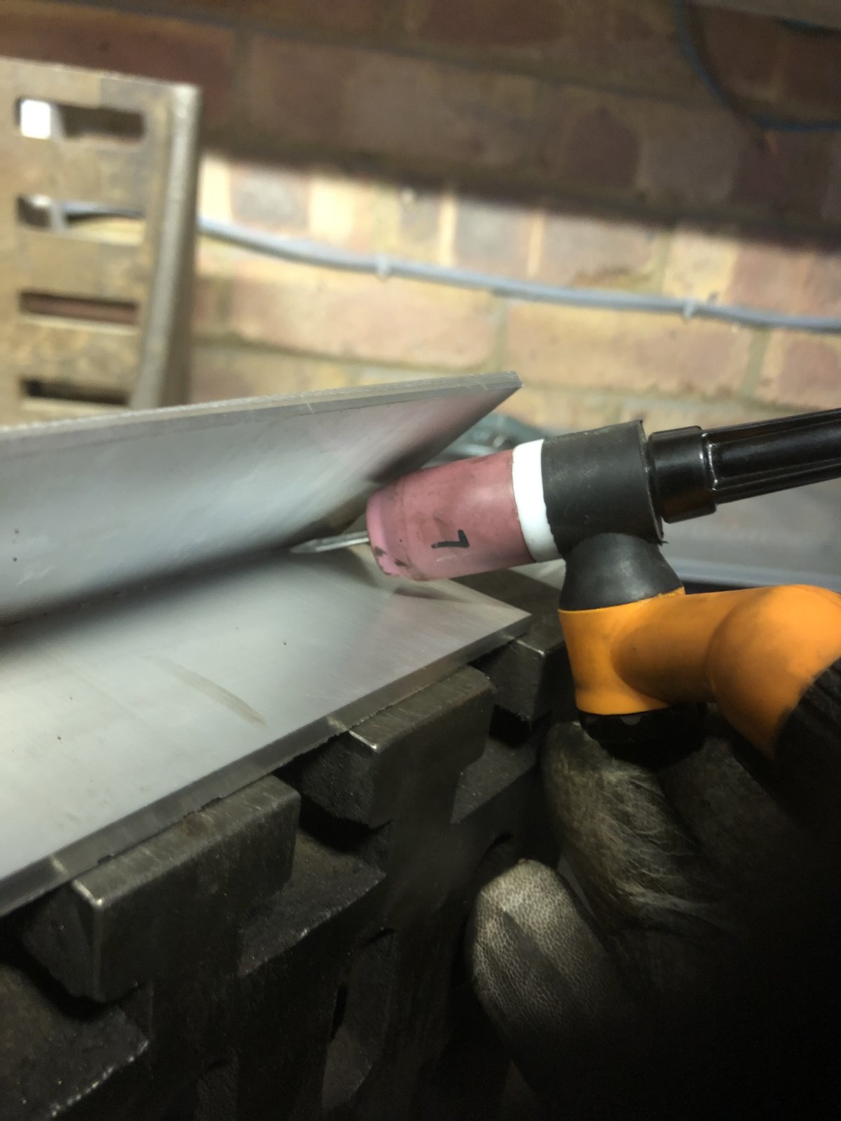

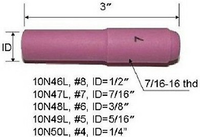

use a gas lens with as much stickout as possible is what I've read for 'tight corners' but with the cups I've got can't get the tungsten anywhere near the corner unless it's sticking out far too much....what kind of cup/size would give the best access? it's a Parweld wp26 torch I have
