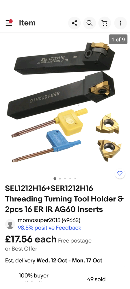

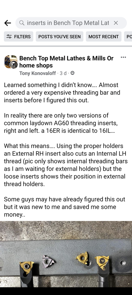

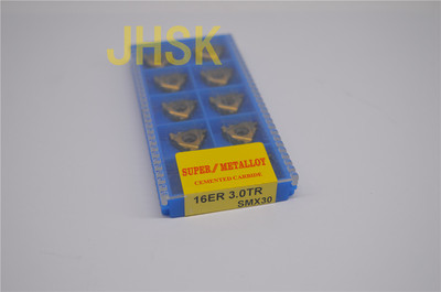

Pls can someone advise me on an insert for a 24mm trapezoidal left hand thread with 3mm pitch. I have a holder for metric external threads, I think it's er16 or something.
When I get my lathe back together I am going to attempt to make a longer lead screw for the z axis as I've extended the column on my mill.
Would I be better off grinding a piece of HSS?
