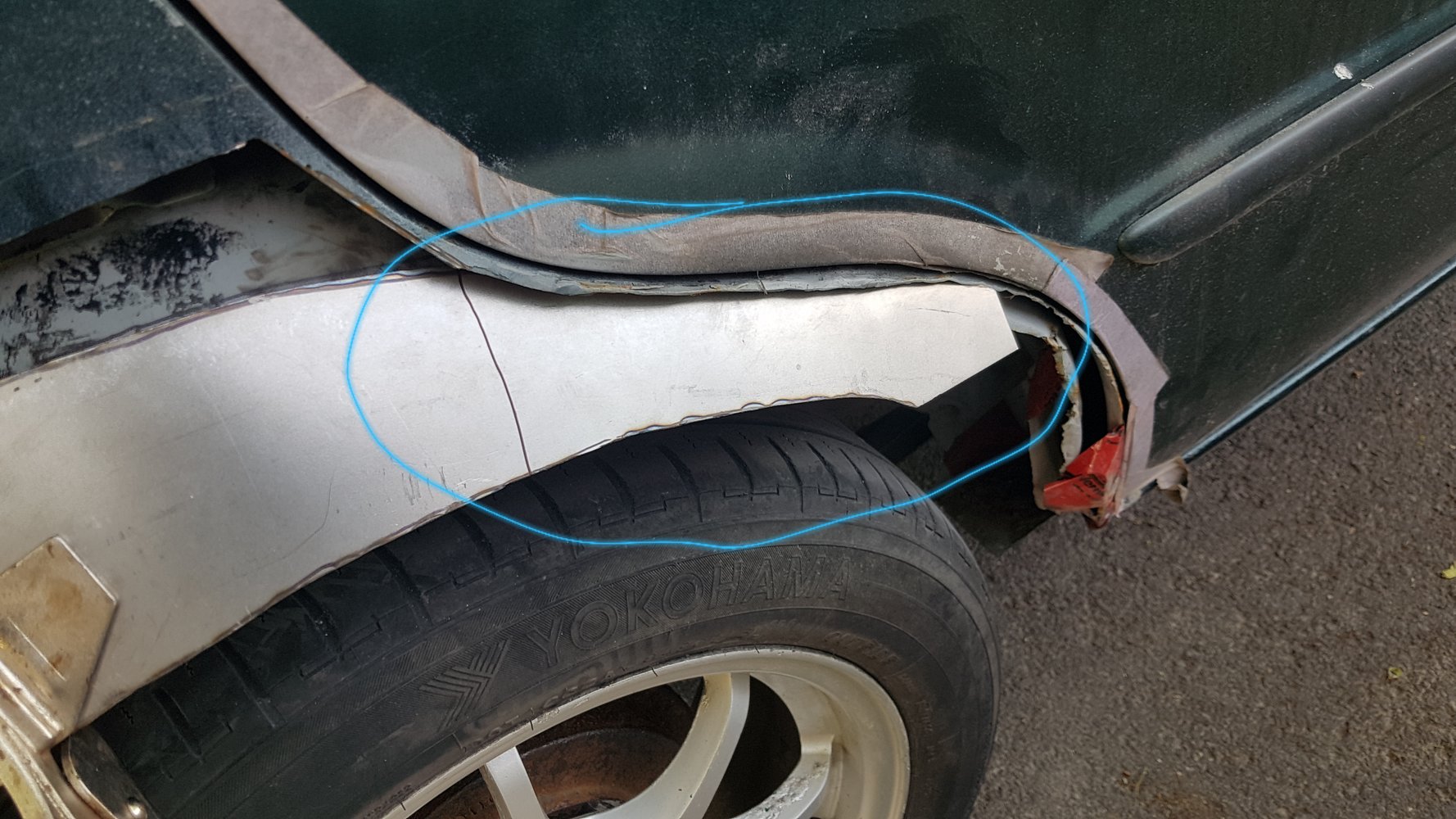

Just thought I would update you on my progress:
1) This piece I will cut out and make a new patch:

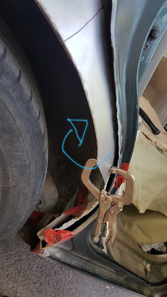

2) This piece of patch metal I will put underneath the inner fender (after cutting from the black line) :
I wont be able to clamp it properly if I bond it on top of the inner fender, not to mention the water wont be able to flow around the inner fender if there is a patch there.

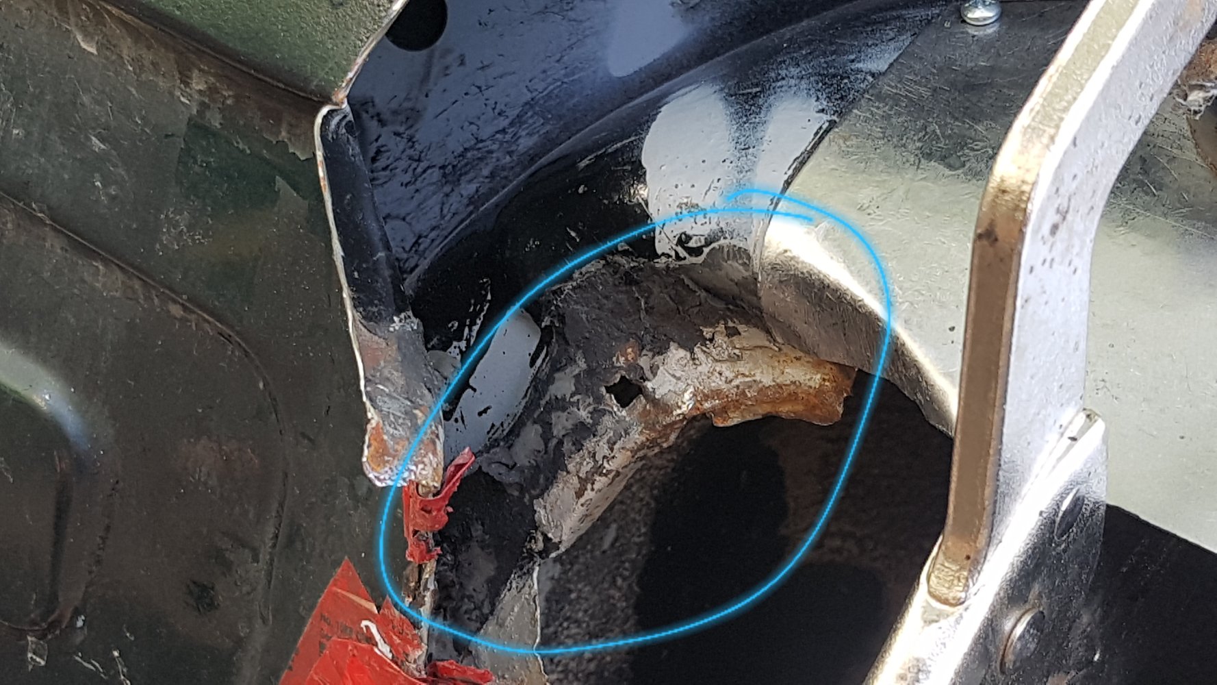

3) I used a 3/32 drill bit to drill a hole for 6x 3/8 inch screw tap , the screw tap on the patch metal is a bit loose so I need to get nuts for it.
Let me know what you think,
Thank you and have a nice day.
