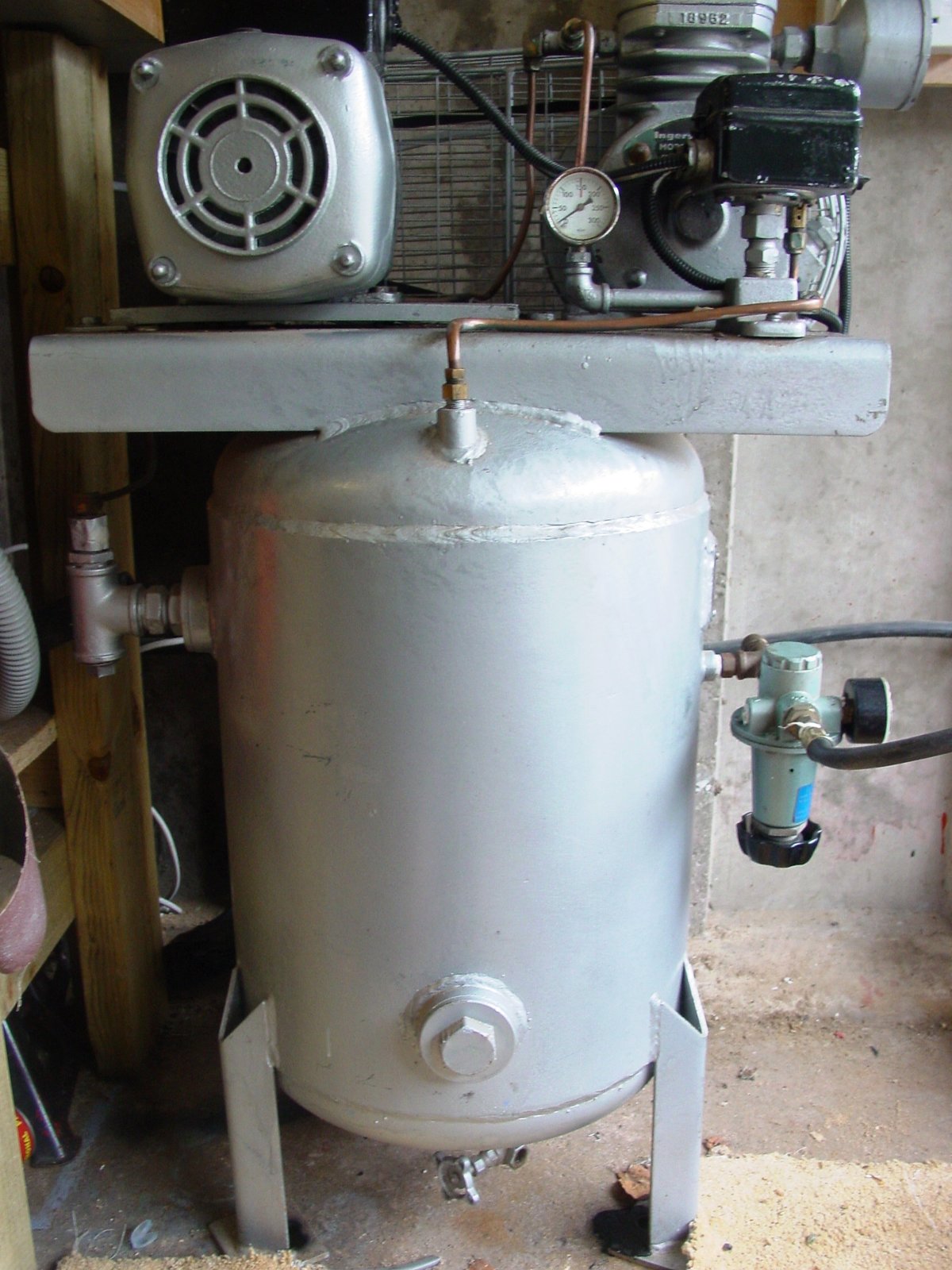

I’’ve had this for 4 years now & it has been very useful for tyre inflation & as a blow gun for cleaning up parts etc. I’m thinking it should be capable of running an impact wrench to save my wrists a bit & hope you may be able to offer some advice:

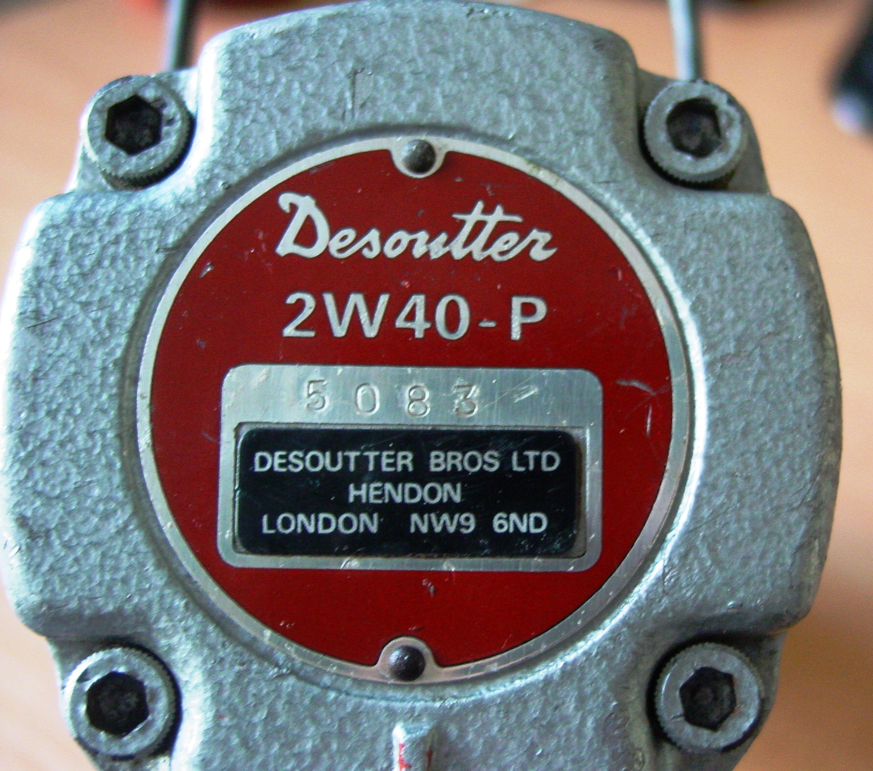

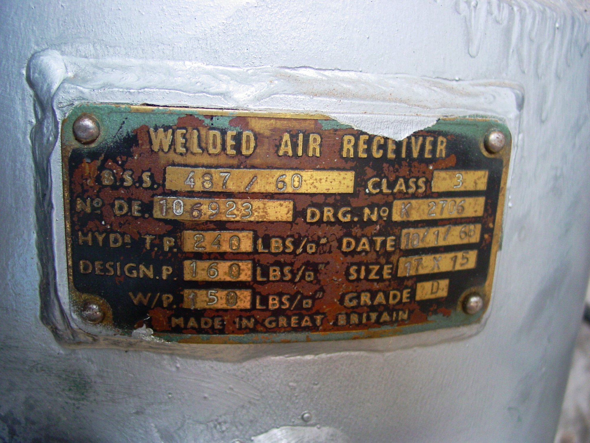

It takes 13 mins to run up to 150psi, will then cut in if the pressure drops by about 15psi. If left alone it doesn’t seem to leak down within an hour or so, but overnight will go down to about 30psi. The tank is about 600 litres. I don't know what the CFM might be.
Does that sound OK?
I’ve got an adjustable reducer on it at the moment (it’s been swung down for a photo of the plate) but for an impact wrench I expect I’ll need to tee off a connector straight from the tank.
Do you reckon it would work out OK for what would be ‘hobby’ use?
Also , I’m not sure if a ½ or 3/8 gun would suit best – it would need to cope with wheel nuts at 100ftlb but I think I’ve had enough of doing any heavy suspension work where a ½ gun might be essential & perhaps a 3/8 gun would be more useful in confined spaces.
Many thanks if you can offer any guidance, Julian.
