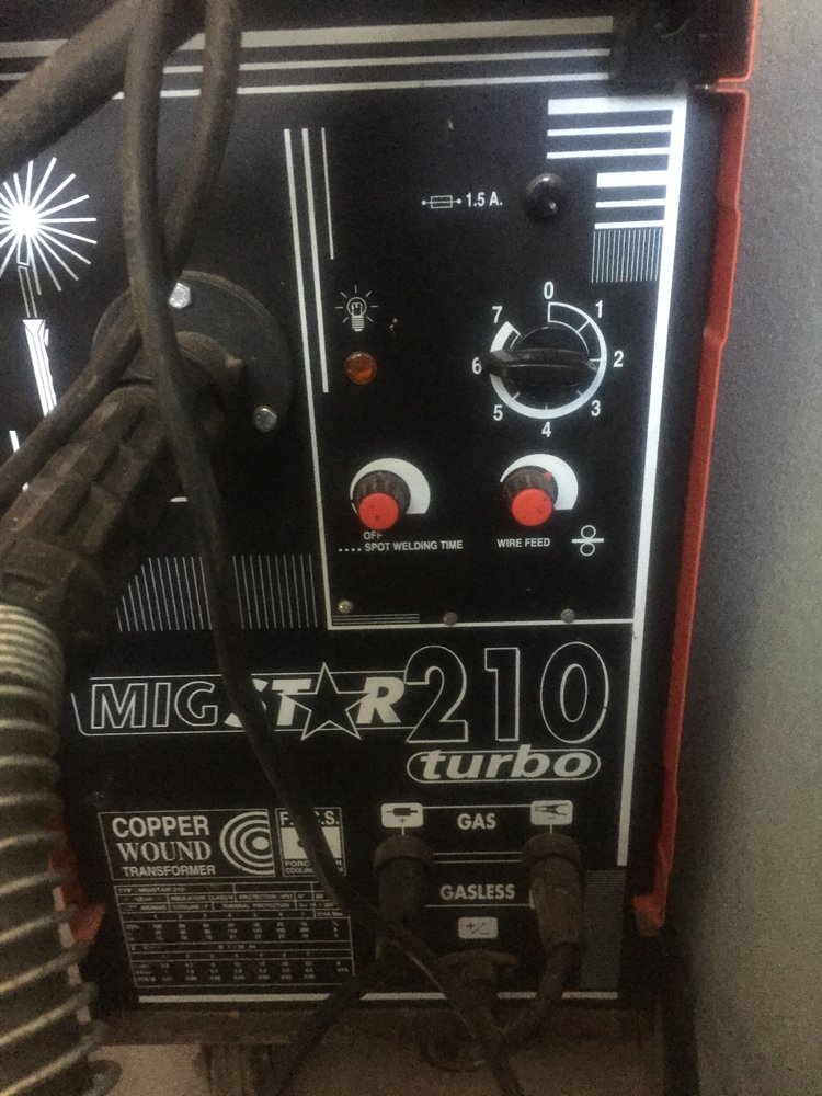

yep , set everything in the middle , follow the instructions on the front panel for earth as gas less mig is reverse polarity , you will find a manual online , it looks like a generic italian machine [ cebora ], so google snap on mig welder and pic a picture thats close , it will be the same machine in a different color . , practice on some 1mm on the bench till you get the gist , buy a joggler / punch for thirty quid , and learn how to use it too ,,, and dont expect miracles to start with ,, but you will get there , best of all , enjoy the process .yea thougth so too about gas.i plan to be doing lots off spot welds,no lines.any ideas about settings to use on this beast gassles.iv learned to use a mig last year with argon for around 100 hr learning on 3mm -6mm steel.any info would be welcome

thats the name i didnt remember ,,, telwin , all much of a muchnessIts definately italian, a Telwin rather than snap-on/cebora though, similar machines were branded here as "Sealey Automig" and such, if you can find a manual for one of those it'll likely be the same internally
