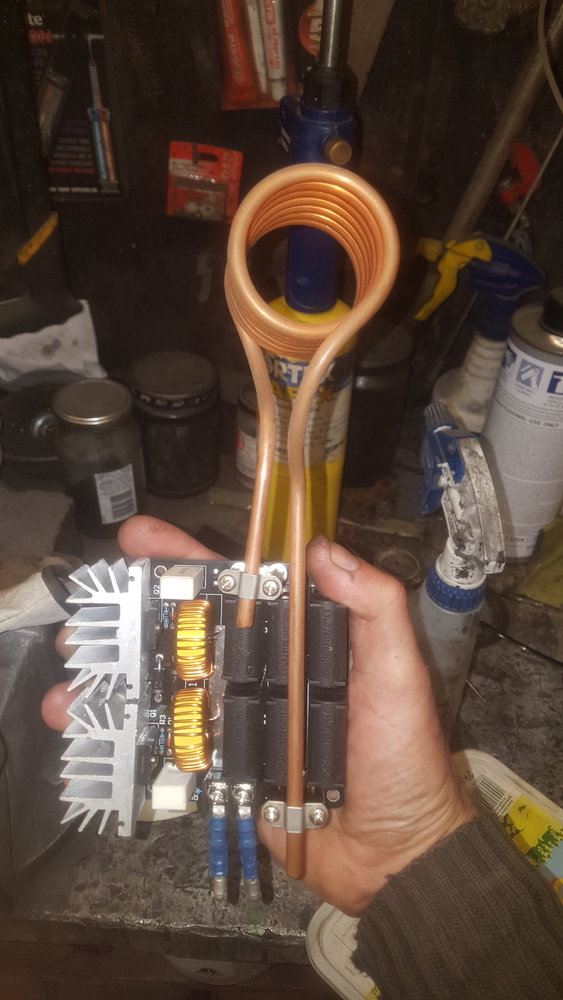

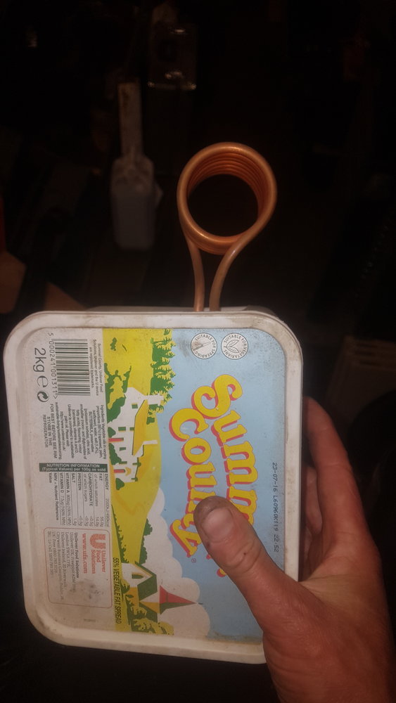

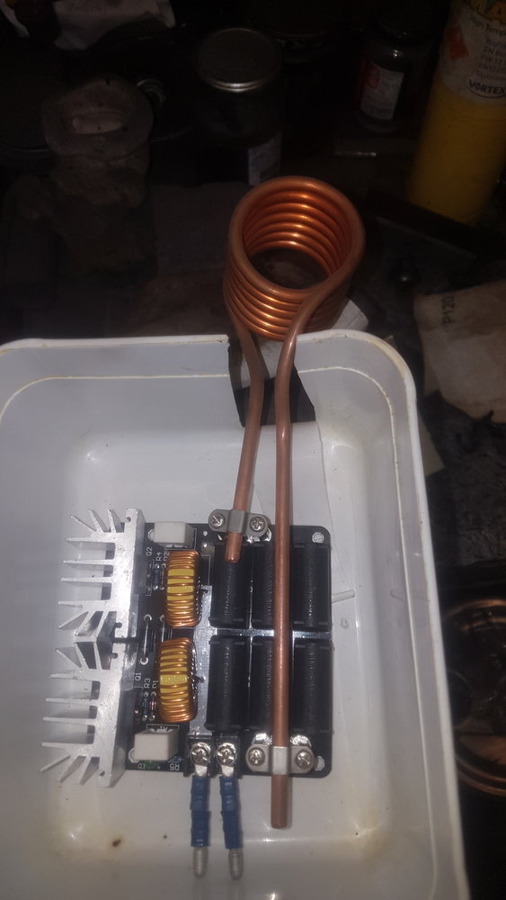

i need to make a smaller coil too can i use the core from copper cable?
the bought ones use solid copper wire ,, theres a flexible one in the box too but it needs the insulation .i need to make a smaller coil too can i use the core from copper cable?
how thick is the solid copper wire?the bought ones use solid copper wire ,, theres a flexible one in the box too but it needs the insulation .
its about 4mm maybe a wee bit more , once its heated a few times it anneals and bends very easilyhow thick is the solid copper wire?
my one is hollow like copper brake lineits about 4mm maybe a wee bit more , once its heated a few times it anneals and bends very easily
next time at that workshop I will measure it to be more exact
there are a couple like that too ,,, ill check the make . To be honest it didnt quite heat things hot enough for my liking ,,, but still its handy .my one is hollow like copper brake line
I guess the more copper the more it will heatthere are a couple like that too ,,, ill check the make . To be honest it didnt quite heat things hot enough for my liking ,,, but still its handy .
yep , i found that adding another loop to the coil in the set up helped ,,,I guess the more copper the more it will heat
mine aint water cooled neaither is the strap on one my mate has.
Just connect 3-4 12v batteries in series and connect a charger to them to charge them up when they get a bit low. Instantaneous power as soon as you switch it on.To get any useful power out of it the copper coil needs to be watercooled but nothing fancy, just a trickle of flow would be adequate.
For maximum power you want 50V and 50A input, and the only sensible priced source are telecoms power supplies, like the one I got for about £90, yes it cost more than the induction.
