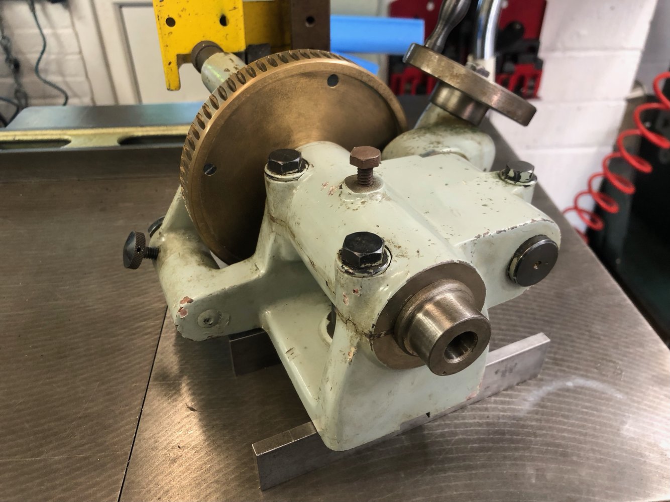

Measure some features of it so we can narrow down the places to look.
Centre height, T-slot width (and whether metric or imperial), threaded fasteners (metric or UN or BSW - hex head sizes will distinguish between the two imperial options), spindle taper, worm wheel ratio.
That would help to choose between British, European or American origins.
For comfortable operation, it has to be mounted on the right side of the table with the spindle facing left. That might pick it out in a photo.

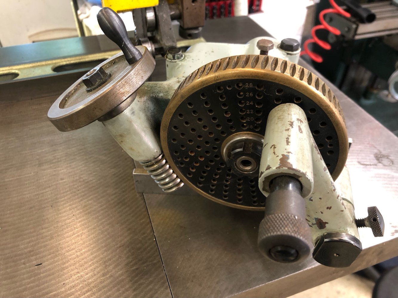

Hi gang, I bought this dividing head and centre recently. Can any one tell me the make and is it all there? also is it possible to find instructions or any ...

Measure the dividing plate (OD, ID, thickness and indexing pin hole diameter) and we could 3D model some new ones for 3D printing when you need a hole circle it does not have.
You can also 3DP linked bungs to block unused holes (e.g. when using the 24 hole plate for 6 divisions).
