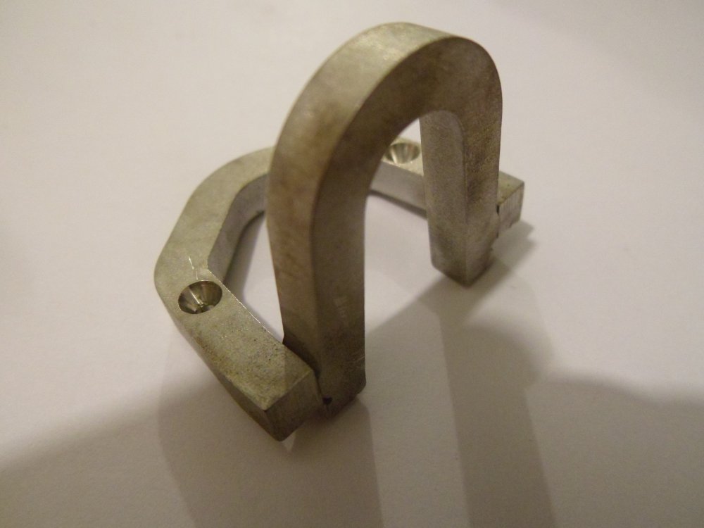

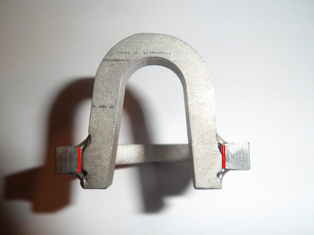

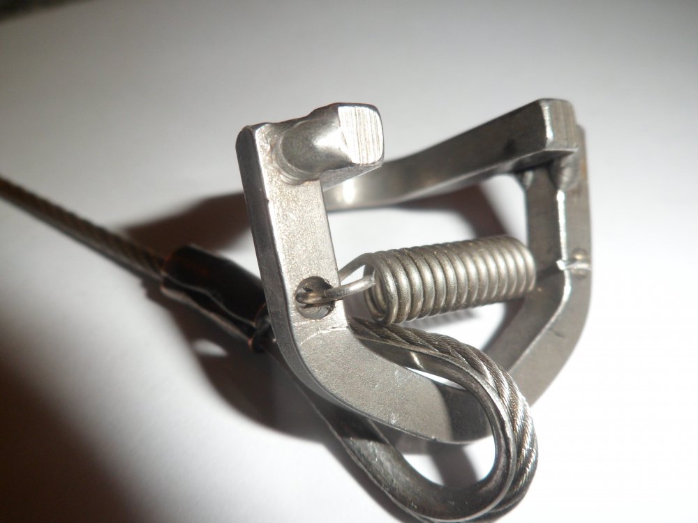

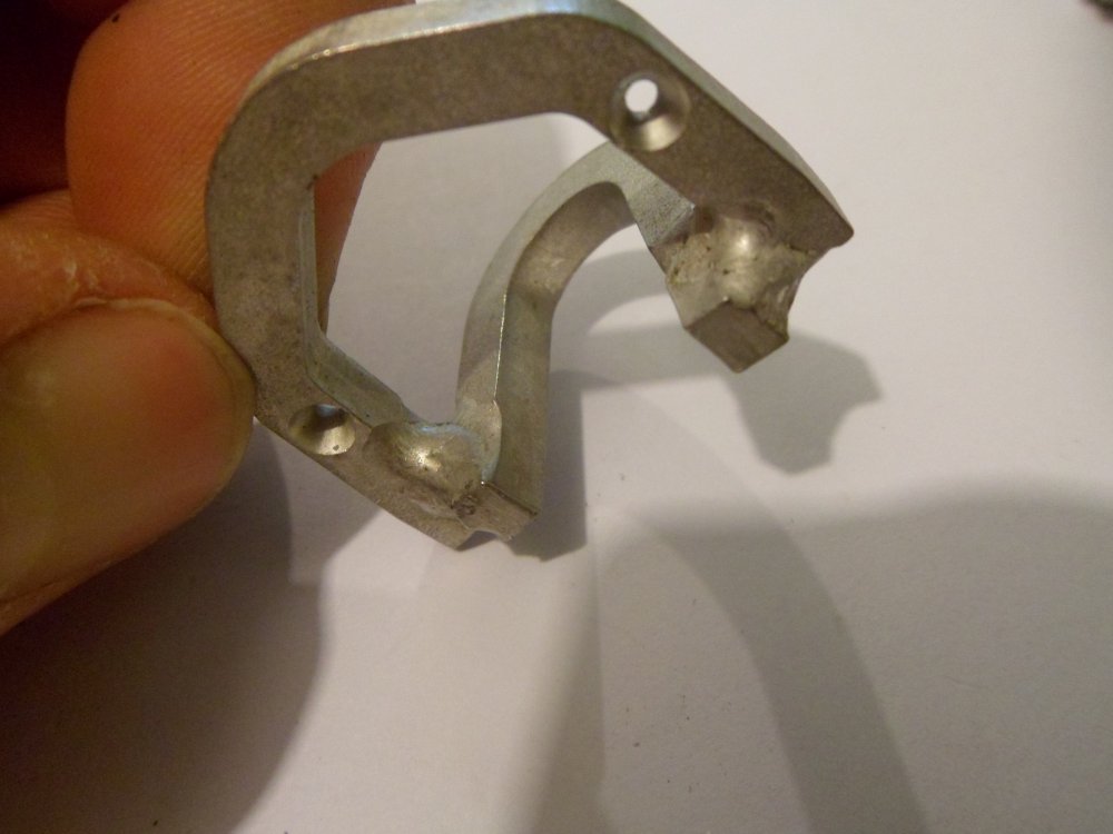

I recently had cause to copy some special stainless steel "spring clips" from a 20 year old sample I had. Basically it's a scaffold staging clip with a lanyard. The sample I had is to go on an Imperial fitting originally. I re-designed it on CAD to fit over a metric bolt and had the U pieces water jet cut. My fabricator TIG welded a sample up and when I saw it I commented that I thought maybe the original had been gas welded. The sample had been fully welded and in fact lost some of the "meat" of the U. It was very discoloured so I was thinking maybe too much heat had gone in to it?
I asked therefore that they only be welded on two sides like the originals.

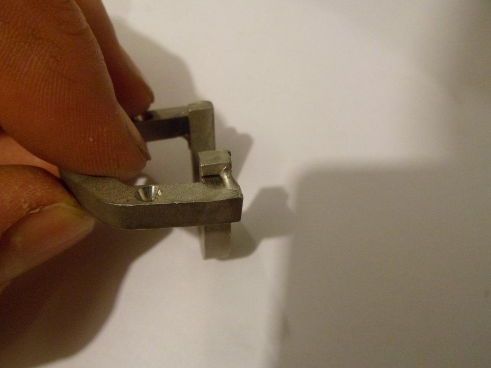

They have now all been TIG. Comparing them and in my opinion it seems to me there's not enough weld, enough penetration and the welding is generally inconsistent one to the other. My gut feel is that a better / more experienced TIG welded could have achieved better results akin to how the sample looks. They're going back to be corrected hopefully but am I being unfair to my fabricator on this? He was citing how fiddly they were but to me that's not an excuse for inconsistency:
The original sample, gas welded maybe?
Another view:

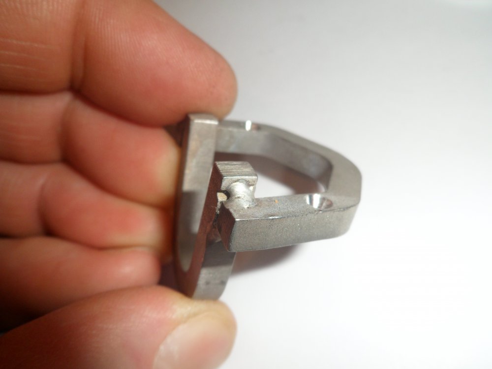

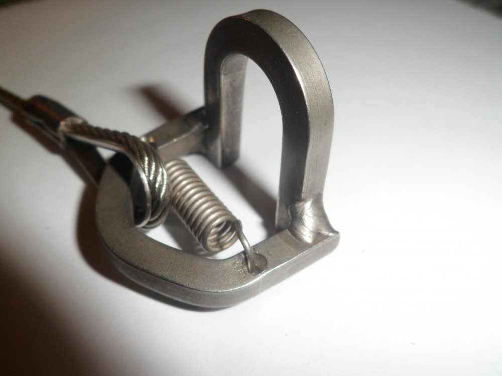

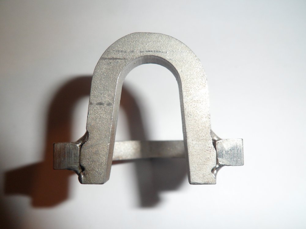

The fully welded sample - it's been rumbled and pickled:
Another view - you can see where the U has been eroded:

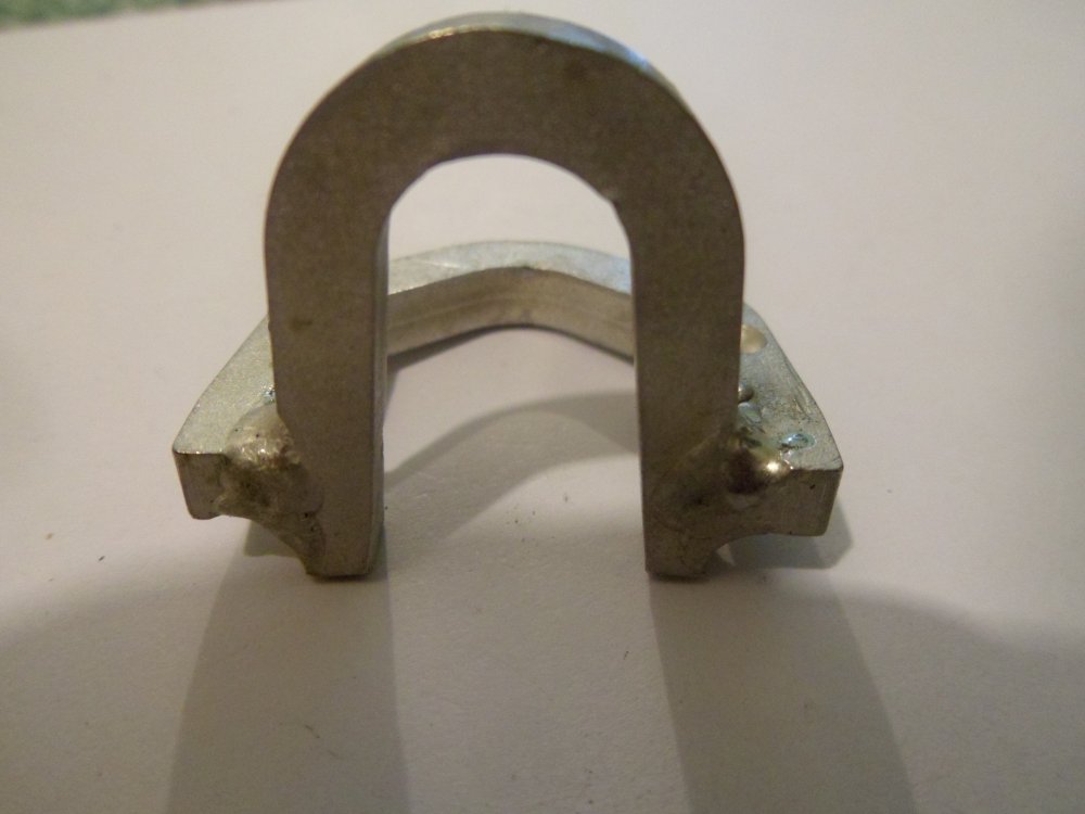

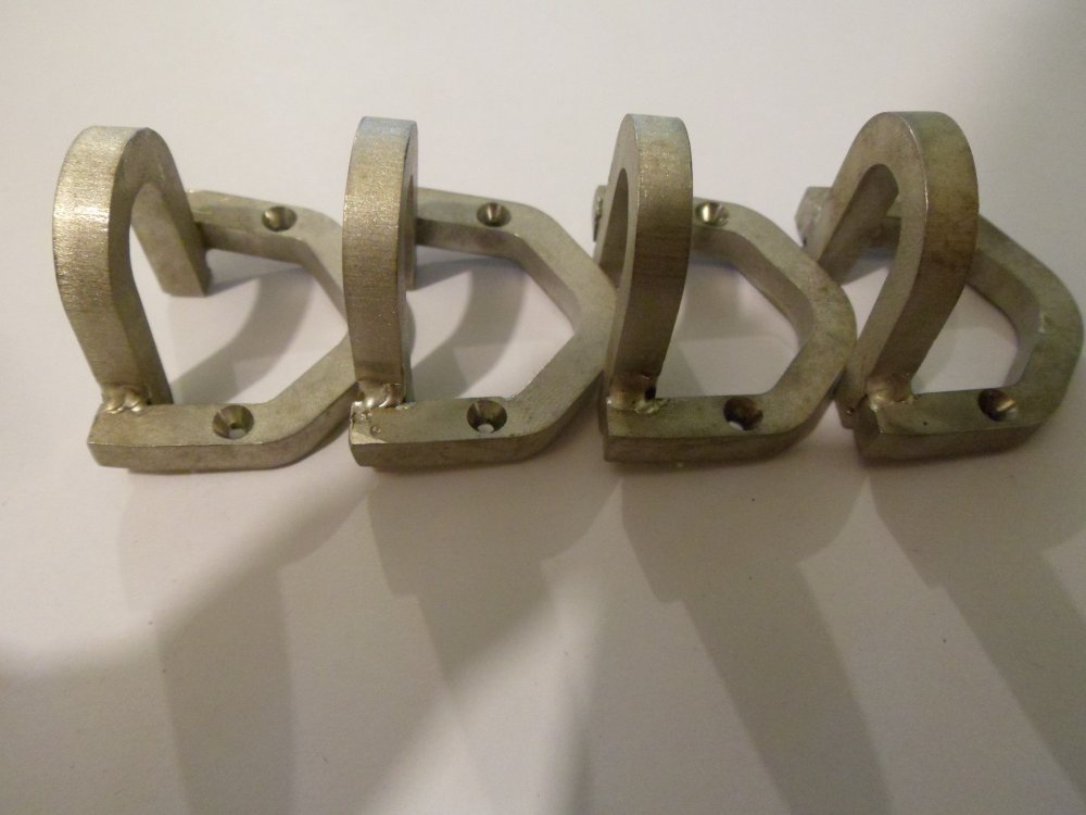

A line up of the TIG welded, finished items. Not welded all round, to me the welds look inconsistent, again these have been rumbled and pickled:
