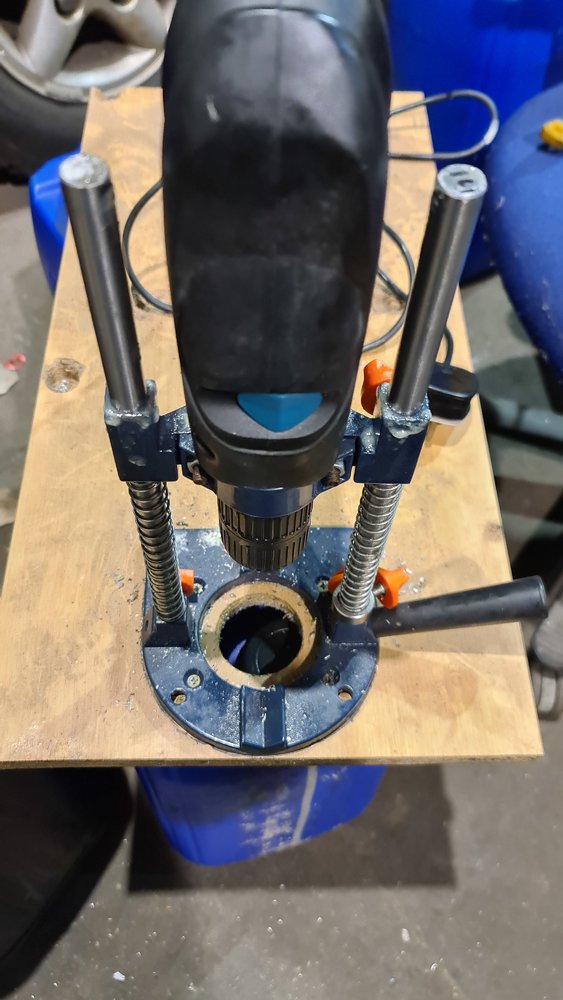

These are pretty useful but loads of play in the guides.
There isn't enough metal in the bracket to drill it out and bush it.
Guide rods are a tad undersized.
Used precision ground 14mm silver steel rod. Almost a perfect fit. Not 100% but 95% of the way there.
Silky smooth action after some white grease applied.
