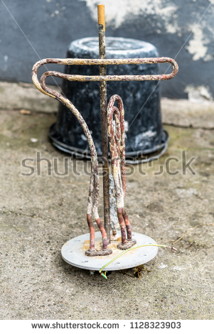

Immersions do not seem to last long in our house, got up this morning looking forward to a nice wash and a shave, and no hot water to be had yet again. I had kept the docket from the last time i had replaced it, december 2015.
Just to be sure i checked the switch (on-off, bath-sink) with a continuity tester and the two lives (L1,L2) on the output side of the switch when checked, set the tester off. So either a switch is shorting inside or the heater is.
Any sparks know why i do not get long out of a heater ? Are they just cheap tat now ? Barely three years is taking the wizz a bit imho.
