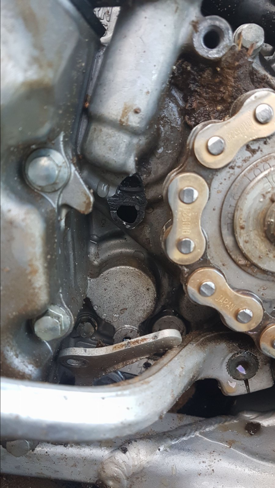

Nah, i could see it was almost the same as my HuskyYep now it's identified as a CR engine that would be right. They ran the pushrod through the input shaft since the 80's or earlier.
I don't think that's a waterpump though I could be wrong. Looks more like the clutch pushrod actuator housing.

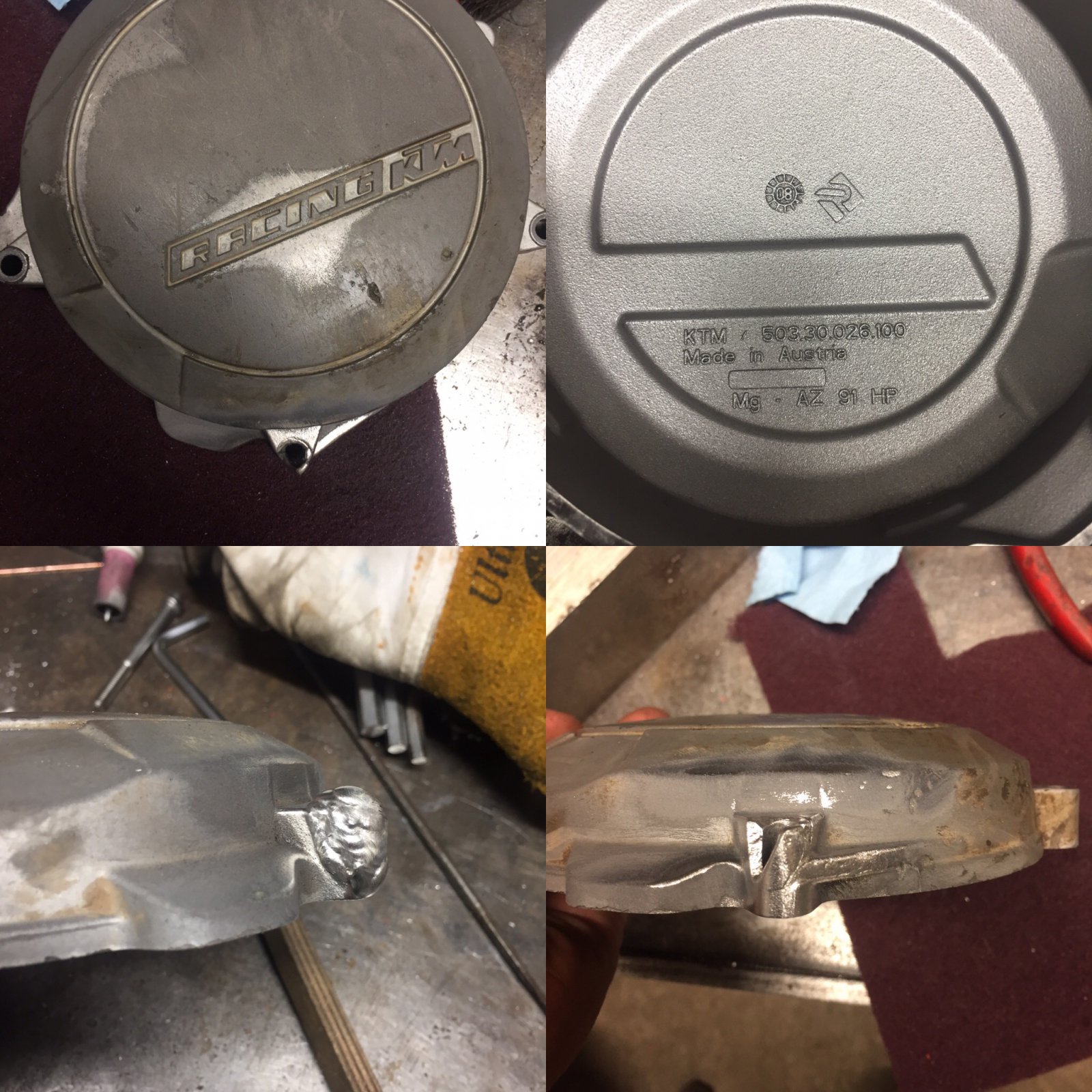

.I cant help wondering what caused it to break. It doesnt seem to have taken much force. >CLICK FOR LINK<So what I think the chain has got a bit lose and caught it on its way round
Yeah that looks a bit of a mess makes me happier knowing I should weld OK who did you get to do it
Hopefully my temp repair will last a few months then I'll do a rebuild and get welded
Get it off send me some pics and I'll quote you for it.Rich do you think you could do it when I get it apart
