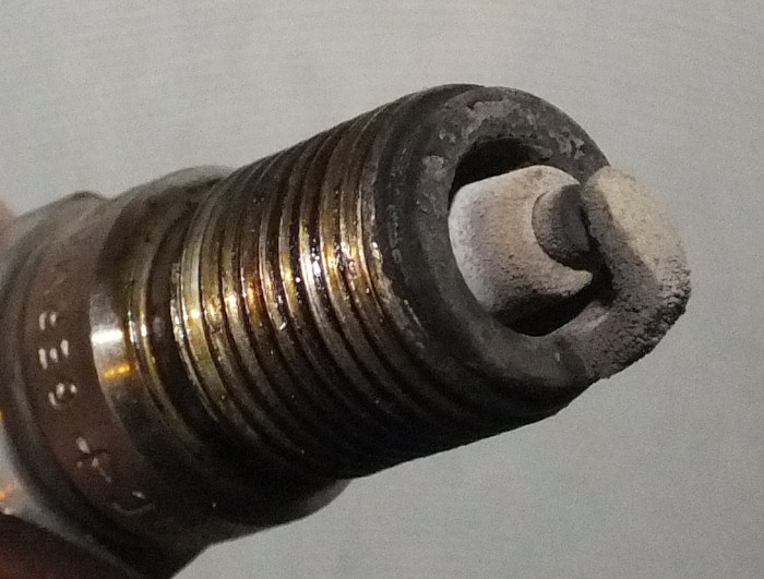

My Renault 4 has a Renault 5 Alpine engine. It has a crossflow hemispherical head with a 10:1 compression ratio. See http://www.r5gordini.co.uk/mediawiki/Renault_5_Gordini_Atmo - Output is 3 times the power of the standard engine which is nice.
I've changed the distributor for a 123-tune distributor (programmable using a laptop) and have it running way better than the standard distributor at low rpm. My worry is to get the thing running as well as the original distributor at high rpm I've had to set the maximum advance to 45 degrees overall.
I'm terrified by 45 degrees advance. Although the engine just dies on full throttle at under 40 degrees so it does need more. Internet suggests hemispherical combustion chambers have a slow burn and need more advance than your average 35 degrees.
@langy - you might should have experience of this sort of thing
I've attached a picture of a spark plug which looks reasonable after 10k miles under much the same conditions.
