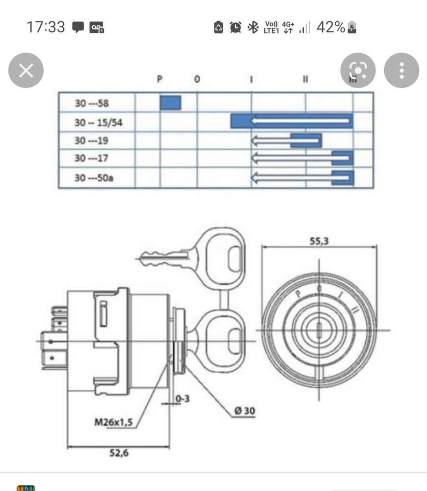

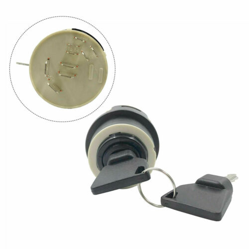

I need to replace the ignition switch on my compressor and if possible add a remote switch so I can start it from the blast room. I thought this one would be a direct replacement for the one that on there but no suck luck.
I need to test which pins do what - I thought a simple check with a multimeter would suffice..... I am getting no readings on any pins in any key position - before anyone says cheap ebay sh%t the original is giving the same readings. Any ideas? I have checked the meter...
