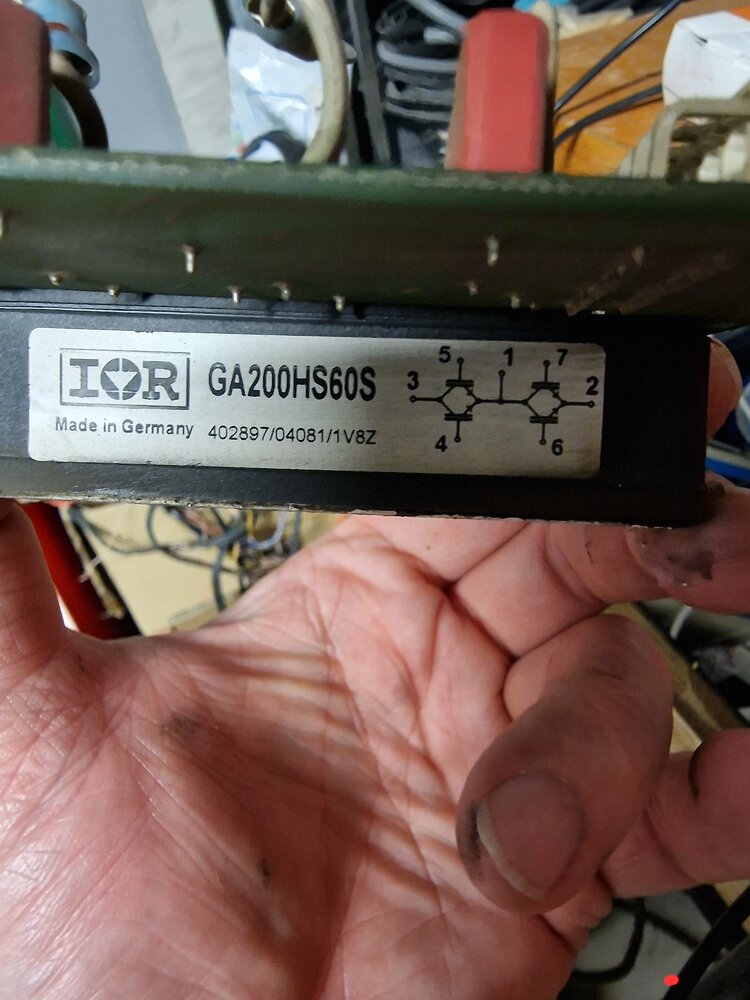

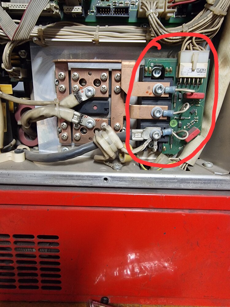

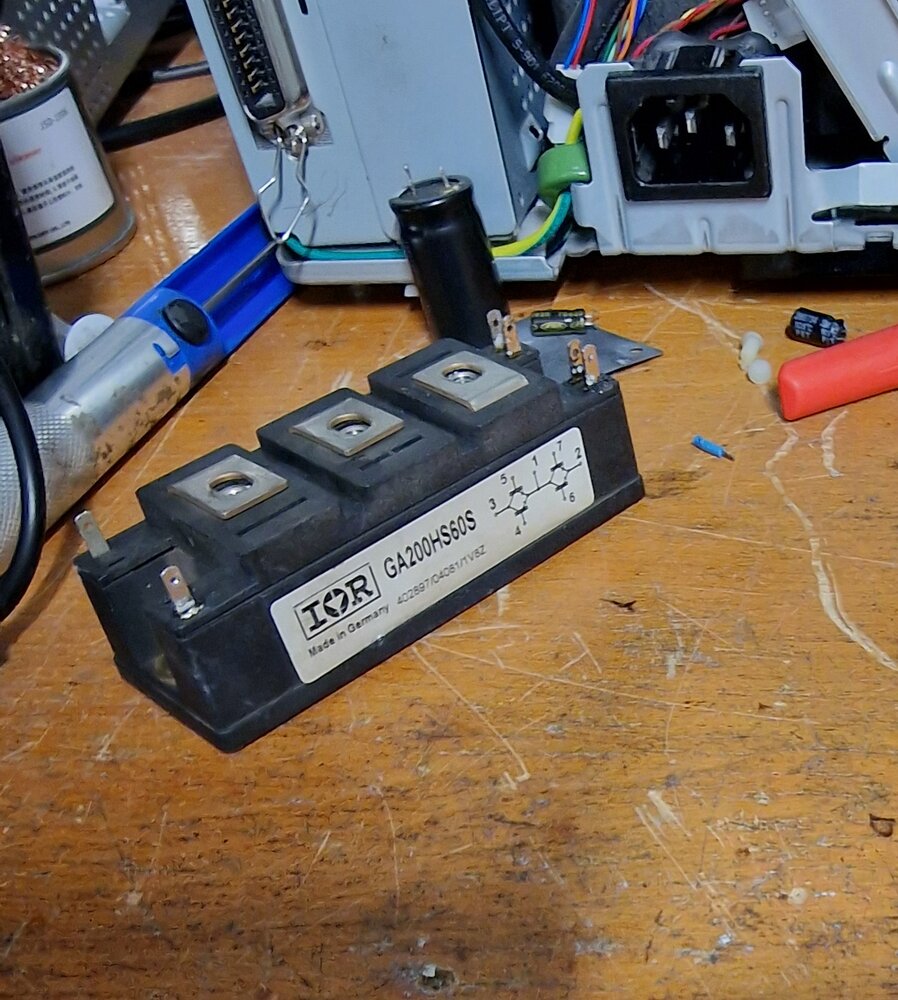

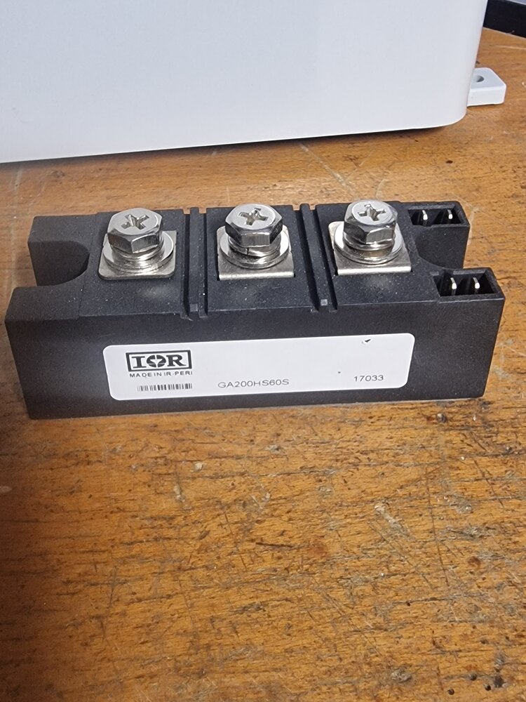

Hello everyone. I have a Fronius MagicWave 2200 welder with a faulty IGBT power module. Fronius quoted me €1,100 for a replacement, and I cannot find a cross-reference or equivalent from Chinese sources. Does anyone know of a compatible, more affordable replacement/substitute for this specific IGBT module? Thanks.
