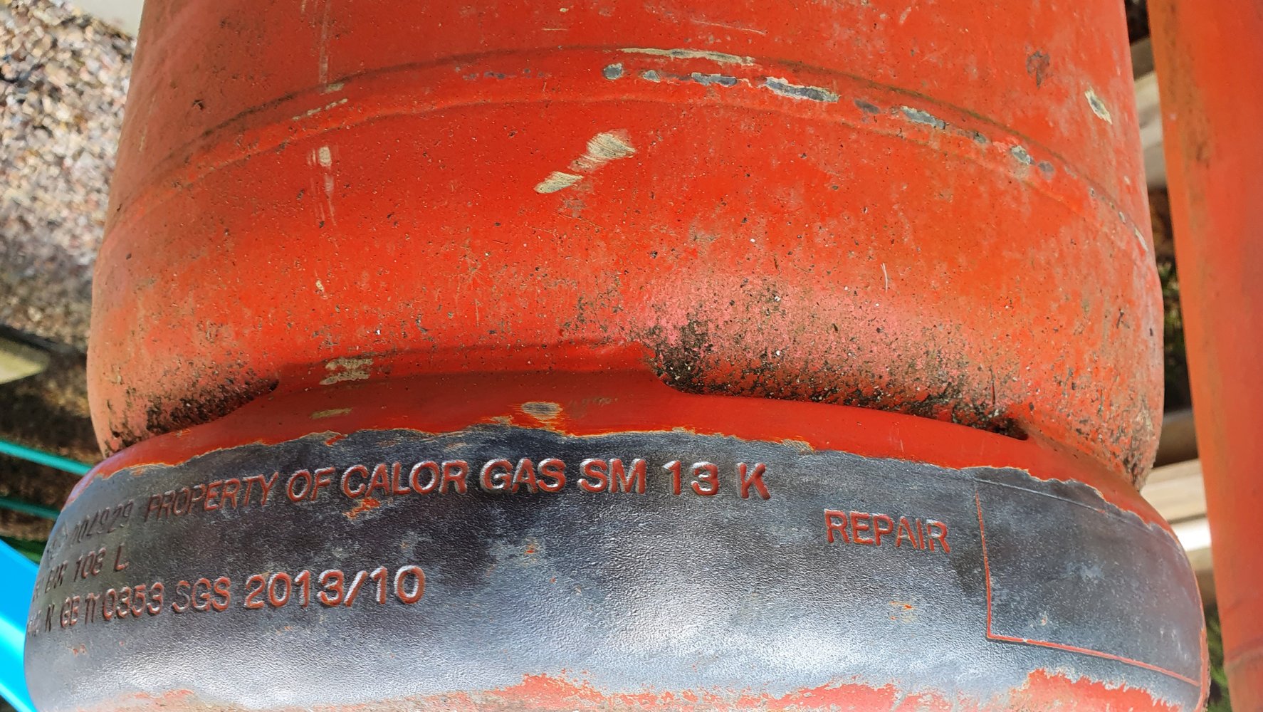

Sorry if this has been discussed to death previously.
I have sourced a couple of empty 47kg propane tanks that are in good condition.
I am then hoping to use these gas tanks to extend the air capacity of my 150 litre air compressor, thus allowing my media blaster to run effortlessly without the air compressor kicking in all the time
As things stand currently.
I have filled the Propane Tank to brim with water and left overnight (3/4 gas valve removed), to purge the remnants of any Propane left behind.
I have the drained this water out and left the tank upside down to drain any remnants of fluid out.
I have sourced a suitably rated 3/4 BSP M x 1/4 M fitting to replace the 3/4 gas valve I removed.
From there I am hoping to fit associated fittings to allow me to fit the following.
Tee piece(s) and associated M x M Nipples,
10 BAR PRV,
Air Inlet,
Air Outlet c/w air regulator and gauge,
Drain point.

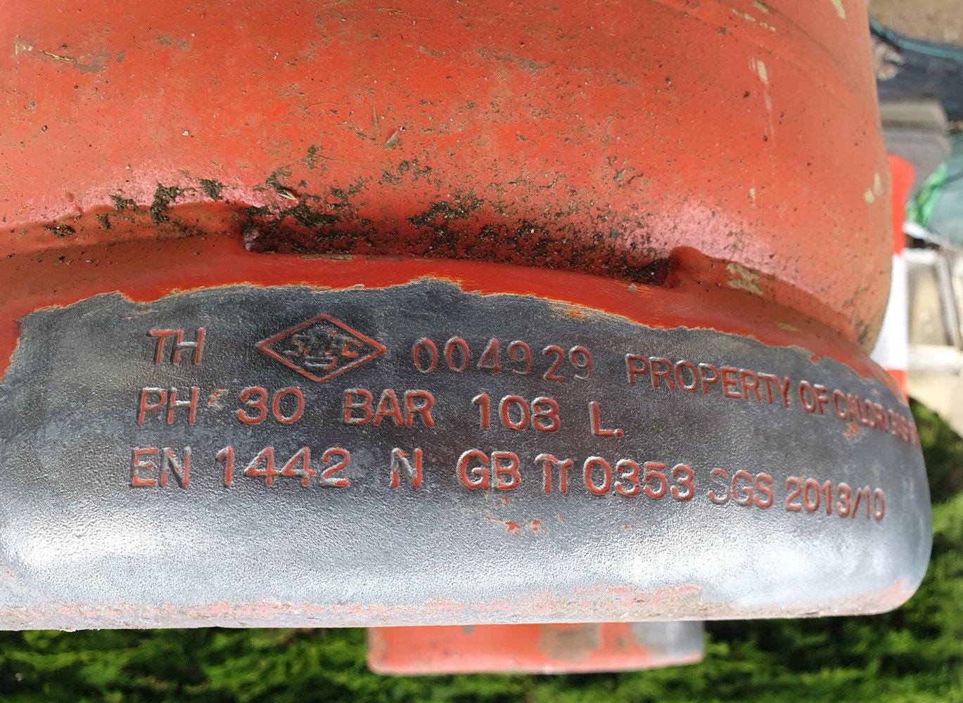

During this process I have came across the flowing markings stamped on the bottom cowling of the tank.
Does anyone have any ideas what each stamped marking refers to ?
I am guessing 30 Bar is the max pressure of the tank.
108 L is the tank capacity.
2013/10 is production date ?
EN 1442 Eu Standards ?
Any tips and advice welcome.
Cheers
Richard.
