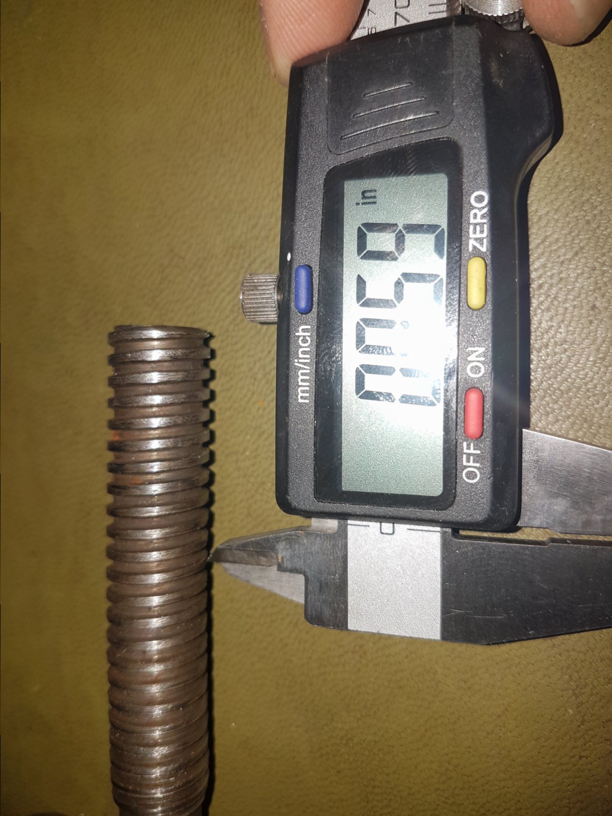

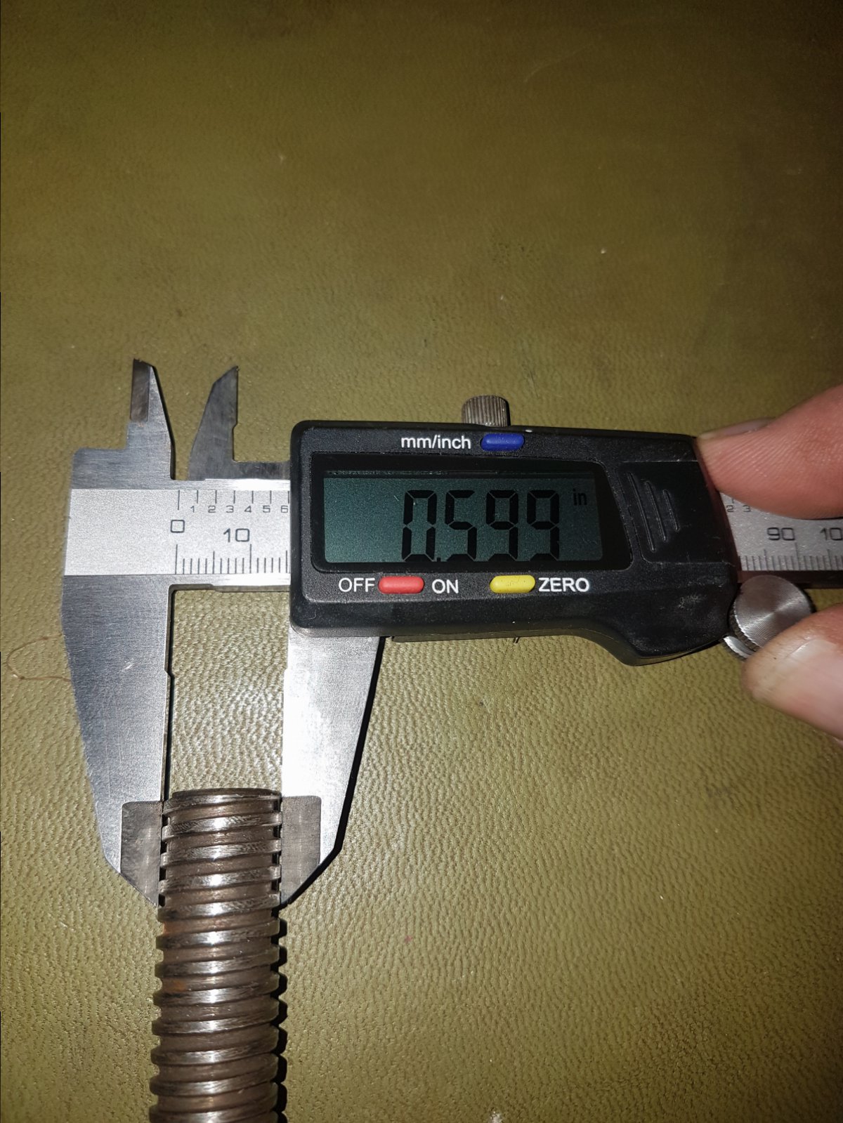

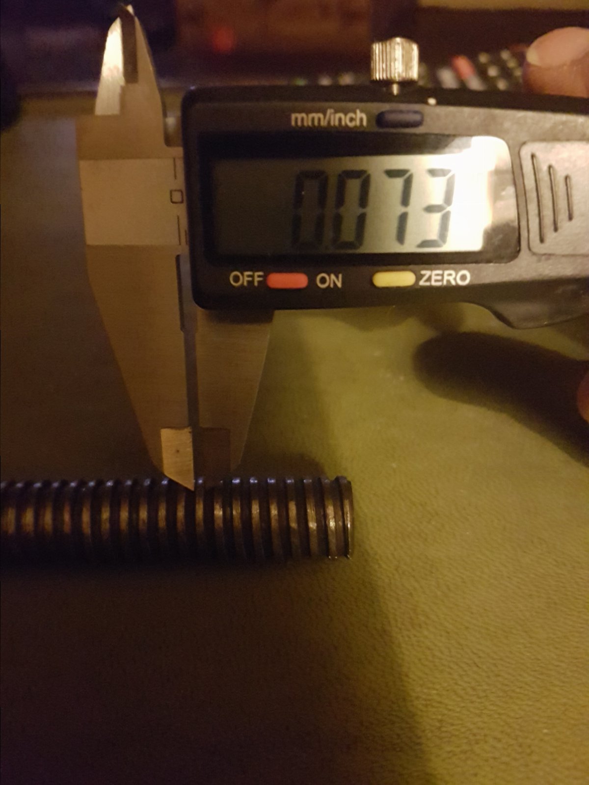

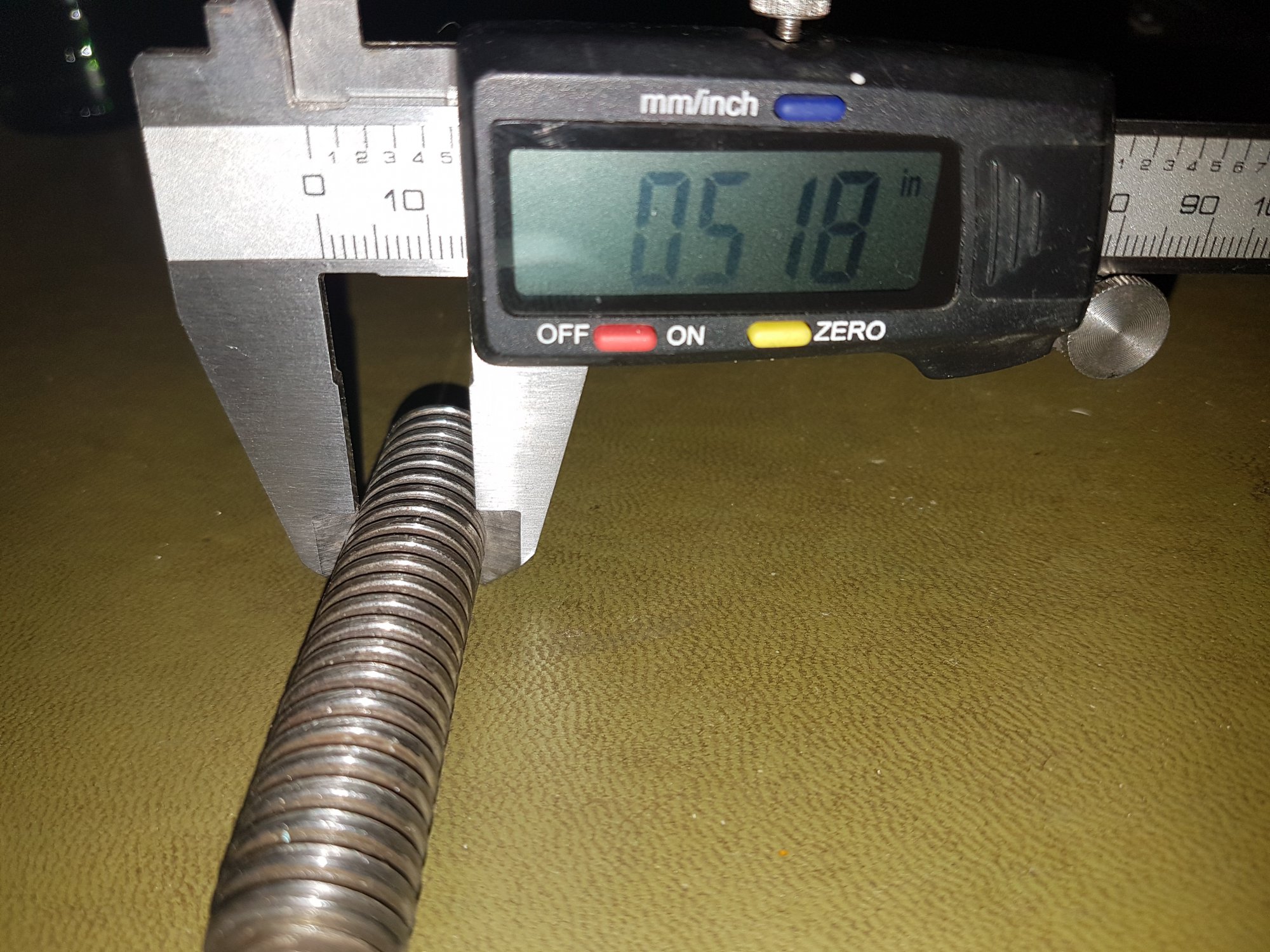

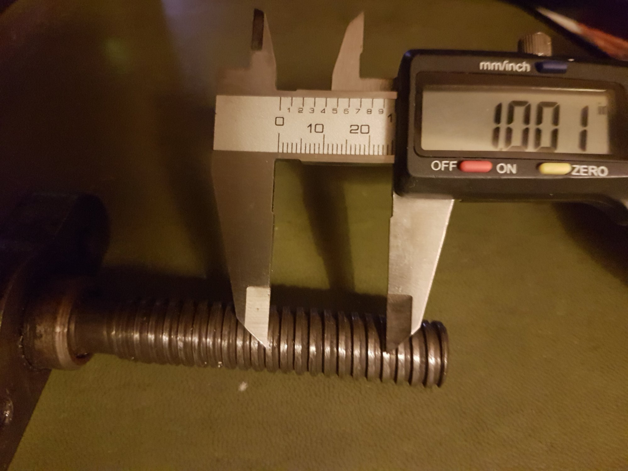

Hi, got a nice little 6" machine vice (possibly Elliot) but it is missing the leadscrew nut. So I am trying to ID the leadscrew to see if I can get a nut or if not have a go at making one.
From what I can tell the leadscrew is 8TPI ACME, but is 3/5th's OD minor dia = .518" which seems to be very unusual
Pics are below, (when I can get them to load
) am I looking at this right?
TPI
OD
Minor Dia
Thread hill & valley (technical terms
Cheers,
MM
