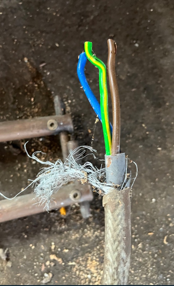

D Dave-sparks Member Messages 709 Location Woking Tuesday at 10:59 PM #41 Bornfree said: Did they give a reason why it shouldn't be earthed? Click to expand... It should always be connected to earth, but depending on the requirements for EMC screening it may need to be connected at one end only or both ends.
