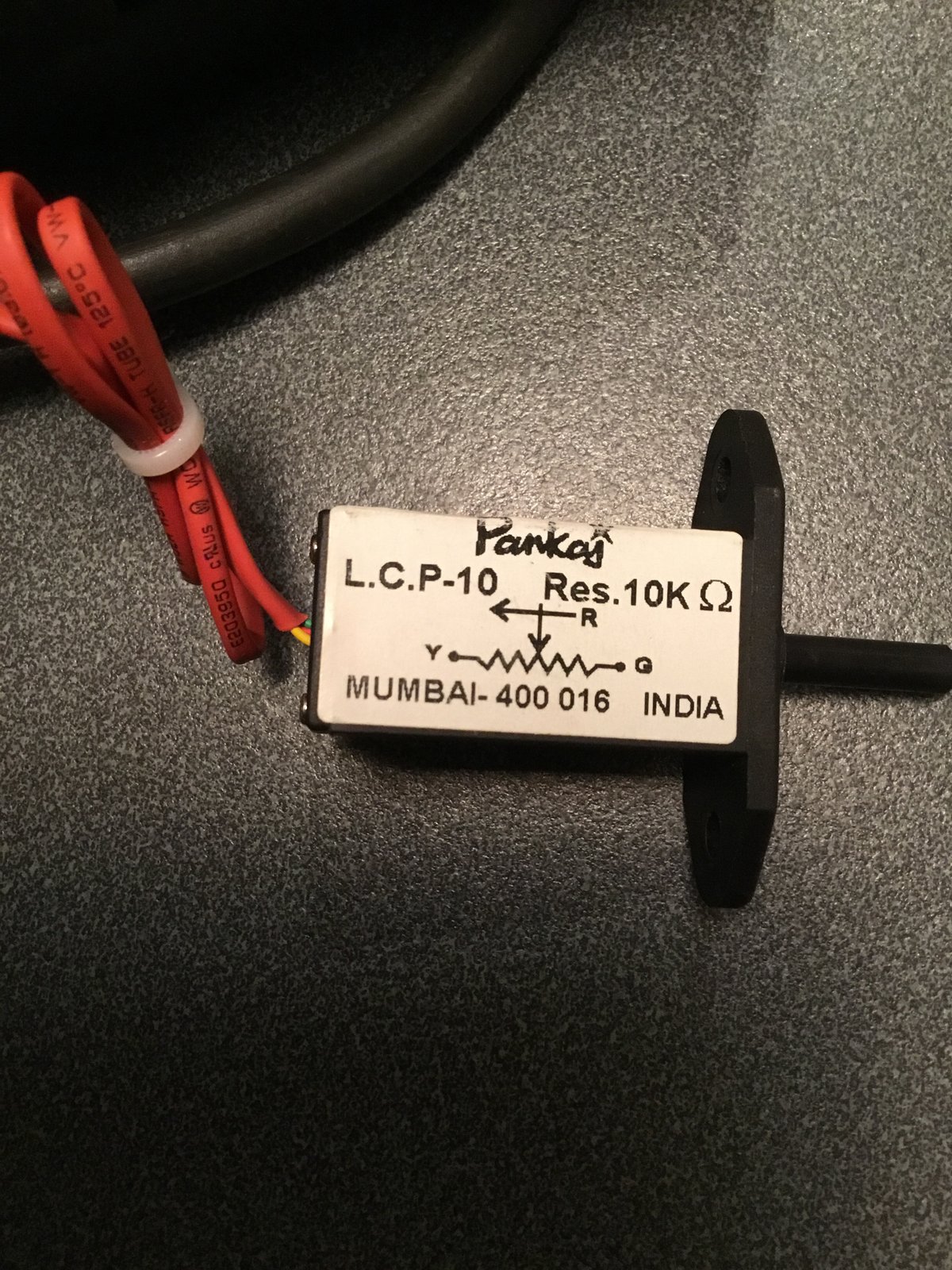

Shox Dr Chief Engineer to Carlos Fandango Messages 17,868 Location East Yorkshire Nov 6, 2017 #1 I think the pot in my pedal is noisy, so want to replace it. Cant find any info on this type of pot. I’ve tried searching for; linear, push, sliding, spring turn... with no success. So what is it

pedrobedro Man at Matalan Messages 13,119 Location CX near Chesterfield Nov 6, 2017 #2 Pankaj 10k short stroke according to google
Shox Dr Chief Engineer to Carlos Fandango Messages 17,868 Location East Yorkshire Nov 6, 2017 #3 pedrobedro said: Pankaj 10k short stroke according to google Click to expand... Well that never came up last night [I’m beginning to dislike google] I’d much perfer a better known make, along with hopefully better quality
pedrobedro Man at Matalan Messages 13,119 Location CX near Chesterfield Nov 6, 2017 #4 It is a linear potentiometer, what's happening they are supposed to have an infinite lifespan ?
Shox Dr Chief Engineer to Carlos Fandango Messages 17,868 Location East Yorkshire Nov 6, 2017 #5 Try using [linear] search criteria, nothing like that comes up
WorkshopChris Member Messages 4,987 Location South East Essex Nov 6, 2017 #6 Try plunger pot 10k https://www.4qd.co.uk/product/plunger-pot-10k/ https://www.4qd.co.uk/product-category/accessories/throttles-pots/
Shox Dr Chief Engineer to Carlos Fandango Messages 17,868 Location East Yorkshire Nov 6, 2017 #7 According to Contelec conductive plastic pots are no good for short stroke cycles such as found when used as a TIG pedal
Shox Dr Chief Engineer to Carlos Fandango Messages 17,868 Location East Yorkshire Feb 16, 2018 #8 Still no luck in finding one of these, so I’ve just emailed Pankaj.
Shox Dr Chief Engineer to Carlos Fandango Messages 17,868 Location East Yorkshire Feb 16, 2018 #9 WorkshopChris said: Try plunger pot 10k https://www.4qd.co.uk/product/plunger-pot-10k/ https://www.4qd.co.uk/product-category/accessories/throttles-pots/ Click to expand... Thanks for those, I’m still trying to find the oem part.
oilyneil Member Messages 171 Location Wiltshire uk Feb 16, 2018 #10 I can only find it in 5 k though https://uk.rs-online.com/web/p/potentiometers/0317780/
