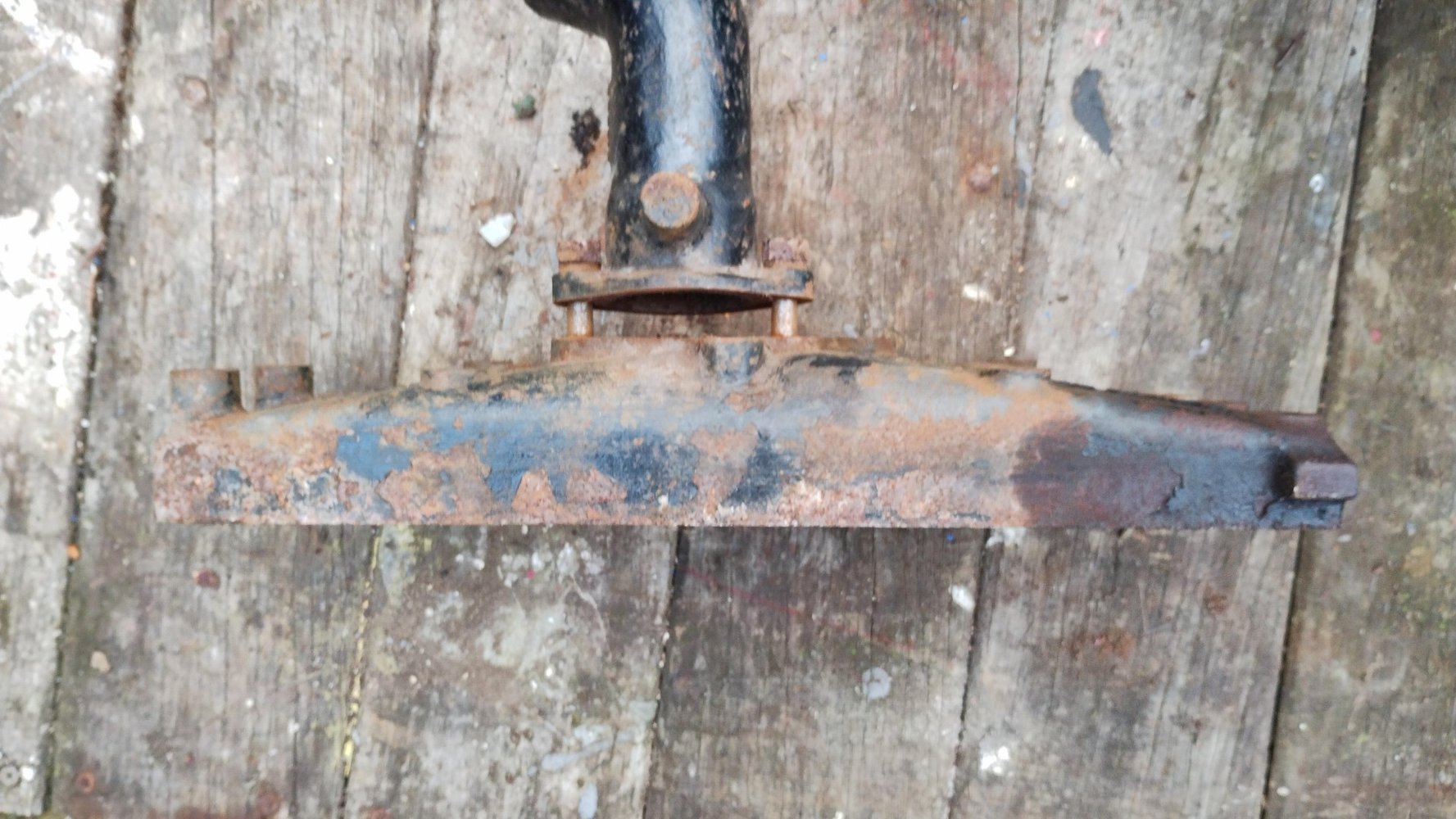

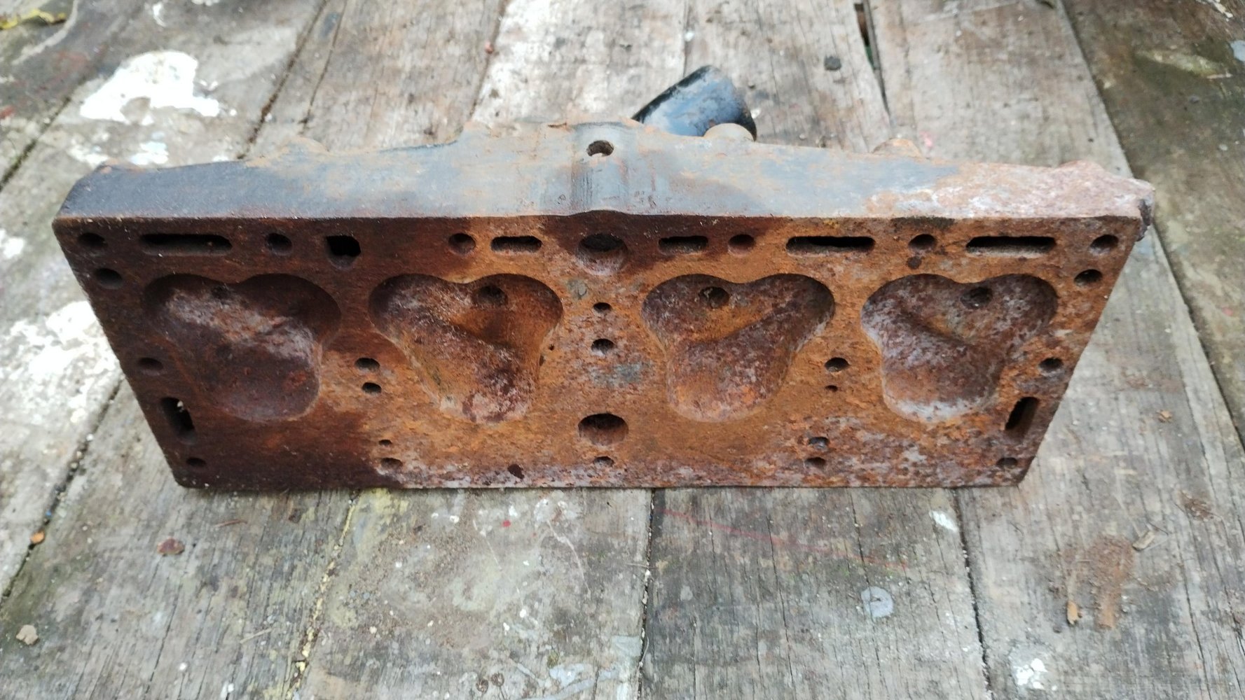

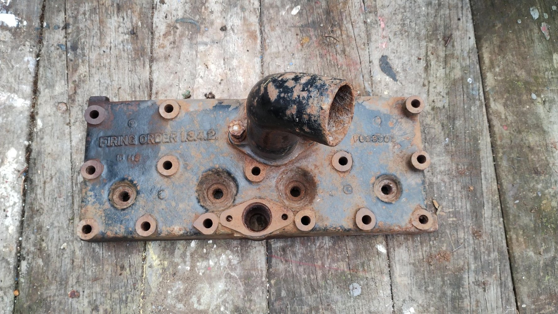

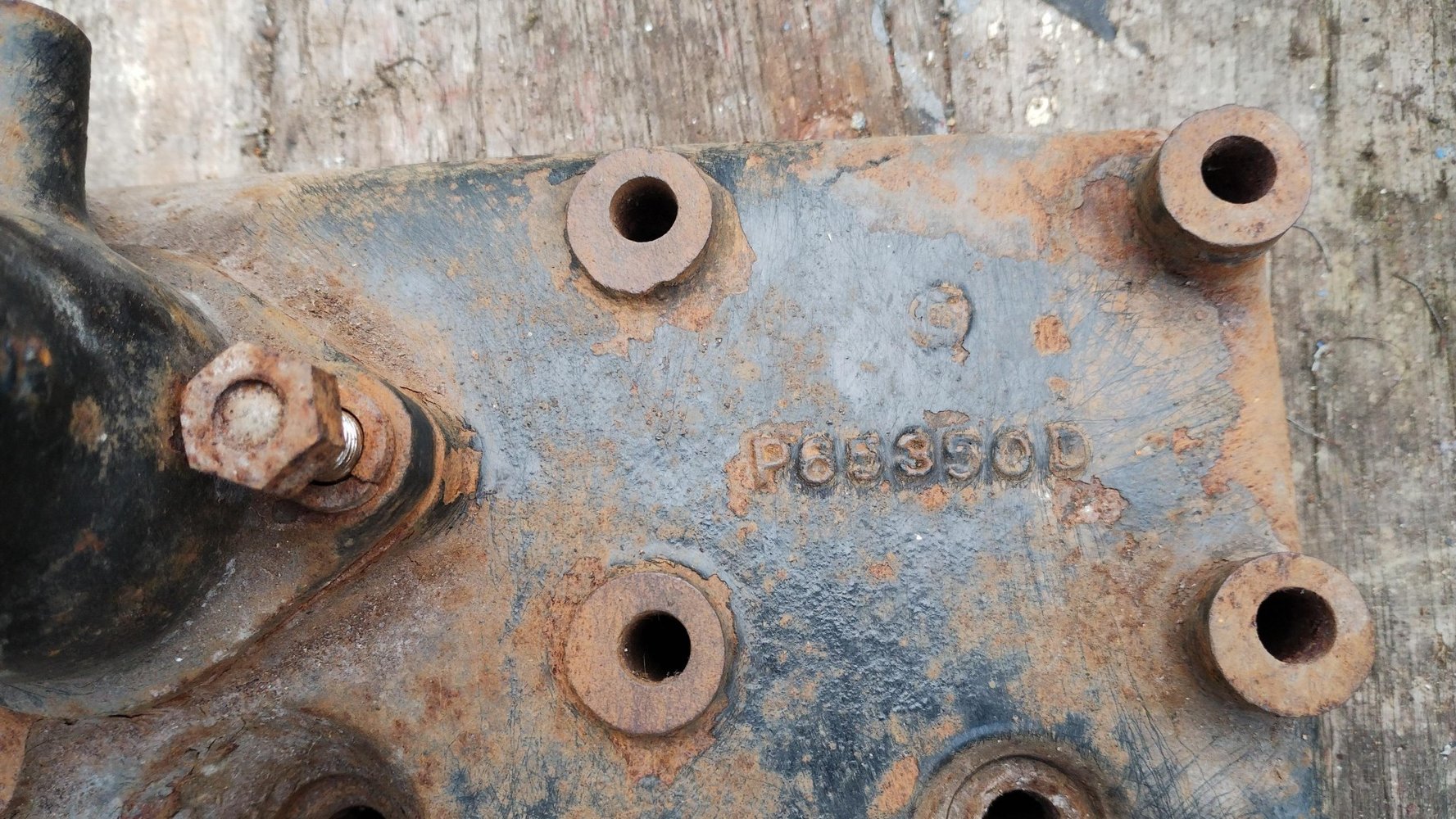

I have a vague memory of Fords using a firing order of 1,2,4,3 , I don’t think that’s a Ford head but I stand to be corrected
It looks like a Ford side valve head, I'm not sure whether it's 100E or earlier.
Look up the v8 flathead stuff reminds me of those, i'm really not into old stuff !
Not with a distributor hole........Look up the v8 flathead stuff reminds me of those, i'm really not into old stuff !

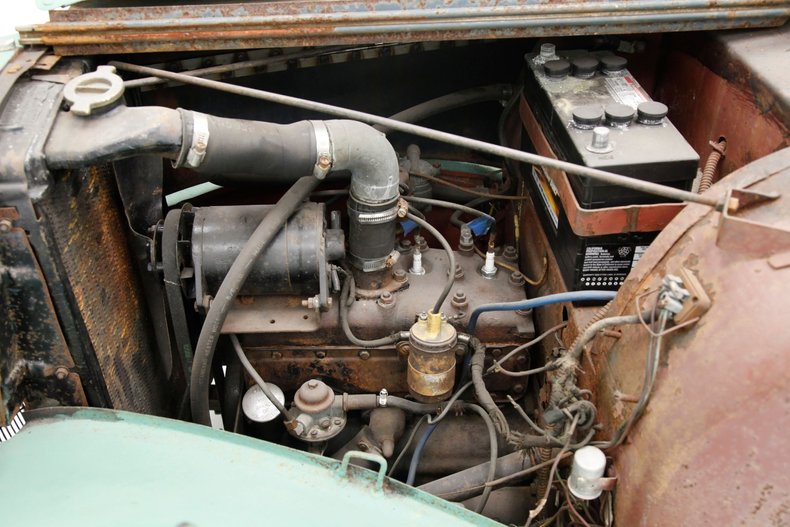

I think you could well be correct - the photo of the other side of the engine clearly shows the distributor on top of the head as pointed out by "Ton-up" in previous comments.After a bit more research, I think it's a pre war Hillman side valve head. It's difficult to find a conclusive photo of one, the best I can find is this -
From here.-
https://www.allcollectorcars.com/for-sale/1937-Hillman-Minx-Magnificent-Drophead-Coupe/2604778/
From here.-
