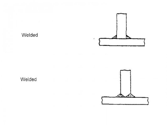

Robotstar5 Casanunda Staff member Messages 24,079 Location Birmingham Feb 21, 2009 #1 Some of the guys at work are doing a training course while work is slow, a lot of them got the answer wrong for the second joint (see attached) must admit the answer surprised me too.

Paul. Moderator Messages 7,010 Location Northampton. UK Feb 22, 2009 #3 Double Bevel T butt, at least thats what it was when i did my c&g, a long time ago, sometimes incorrectly called a double vee fillet, Last edited: Feb 22, 2009

guzziguy Member Messages 36 Feb 22, 2009 #4 double tee fillet double tee bevel fillet Last edited: Feb 22, 2009
shenion Tool Pack Rat Messages 7,582 Location Stone Mountain, GA USA Feb 22, 2009 #6 Double-bevel Tee joint.
Hitch Moderator Staff member Messages 13,495 Location England Feb 22, 2009 #7 Full penetration fillet?
snowcat back in black Staff member Messages 6,302 Feb 22, 2009 #8 AWS defenition would call em square T joint and a double bevel T joint, the fillets the weld not the joint......

Robotstar5 Casanunda Staff member Messages 24,079 Location Birmingham Feb 22, 2009 #10 Well, TIG Paul came the closest to the training company's descriptions 1 - Fillet welded T-joint 2 - Butt welded T-joint I would never have thought the 2nd was a Butt joint of any description Thanks for the responses, will take the info to work tomorrow.

Paul. Moderator Messages 7,010 Location Northampton. UK Feb 22, 2009 #11 If you want Ive got the BS499 chart I used to give to students, PDF File
asmeix6g Banned Messages 298 Feb 27, 2009 #12 i agree, the 2nd one to me would be a double bevel T, and the 1st a square butt T!?? but hey what do i know! im just a welder
