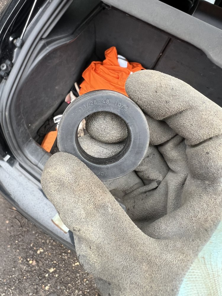

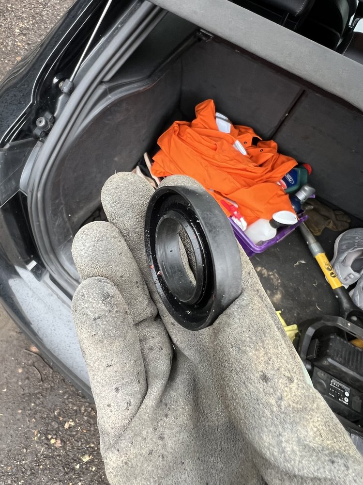

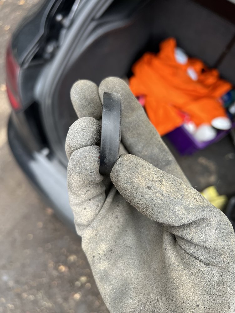

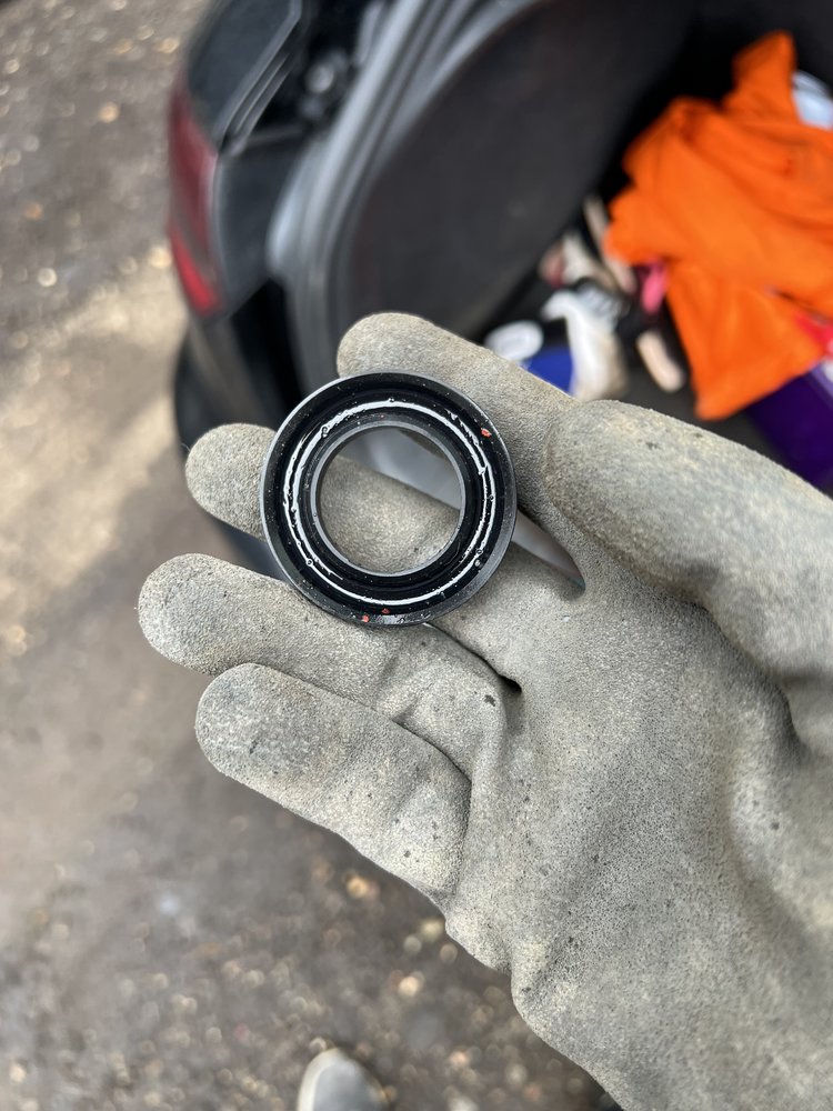

Am I seeing things or is outside tapered?
strange reply? , most are parallel on the outside even when removed its unusual to see one that goes tapered out side thats all ,as most are on a steel rim that holds the shape , I think we all know how seals fit and work ,obviously there is good reason why its outside is tapered ,well hopefully anyways , either way hope @KimB gets one found.No. Yes. So what.
Seals are dimensioned and made so that when installed in the groove in which they reside, they do the job they are supposed to do. When free of that groove, it is entirely possible their natural elasticity may cause them to assume a different shape.
That would be an axle or shaft seal with the steel outer band.strange reply? , most are parallel on the outside even when removed its unusual to see one that goes tapered out side thats all ,as most are on a steel rim that holds the shape , I think we all know how seals fit and work ,obviously there is good reason why its outside is tapered ,well hopefully anyways , either way hope @KimB gets one found.

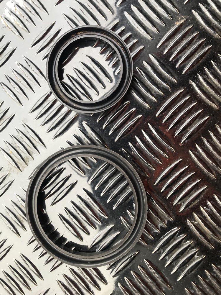

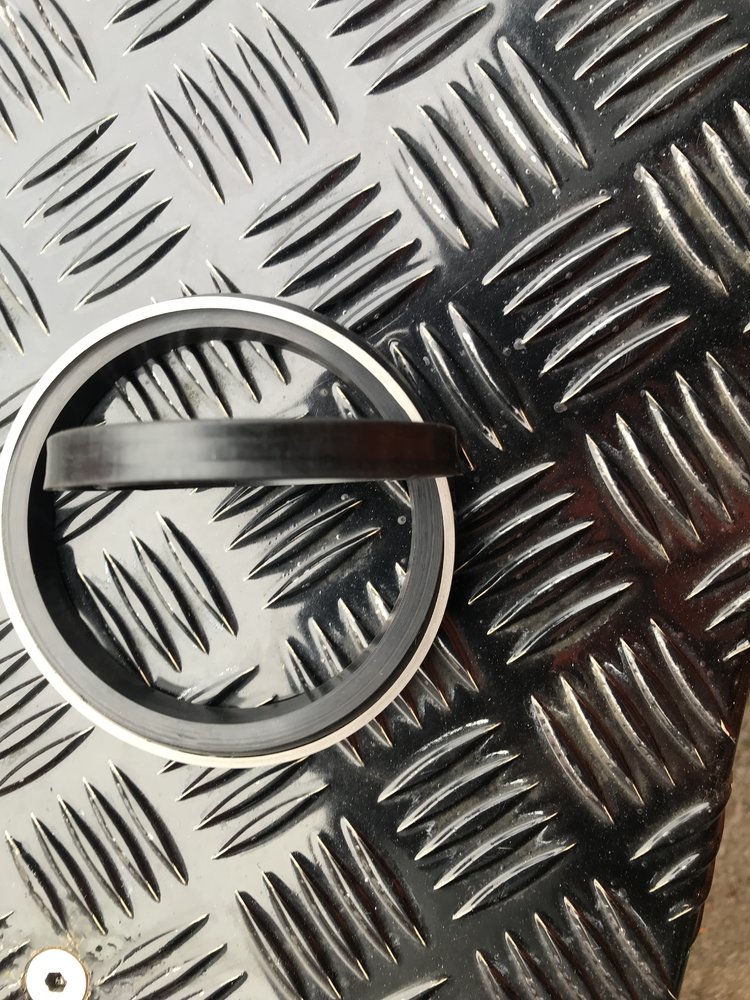

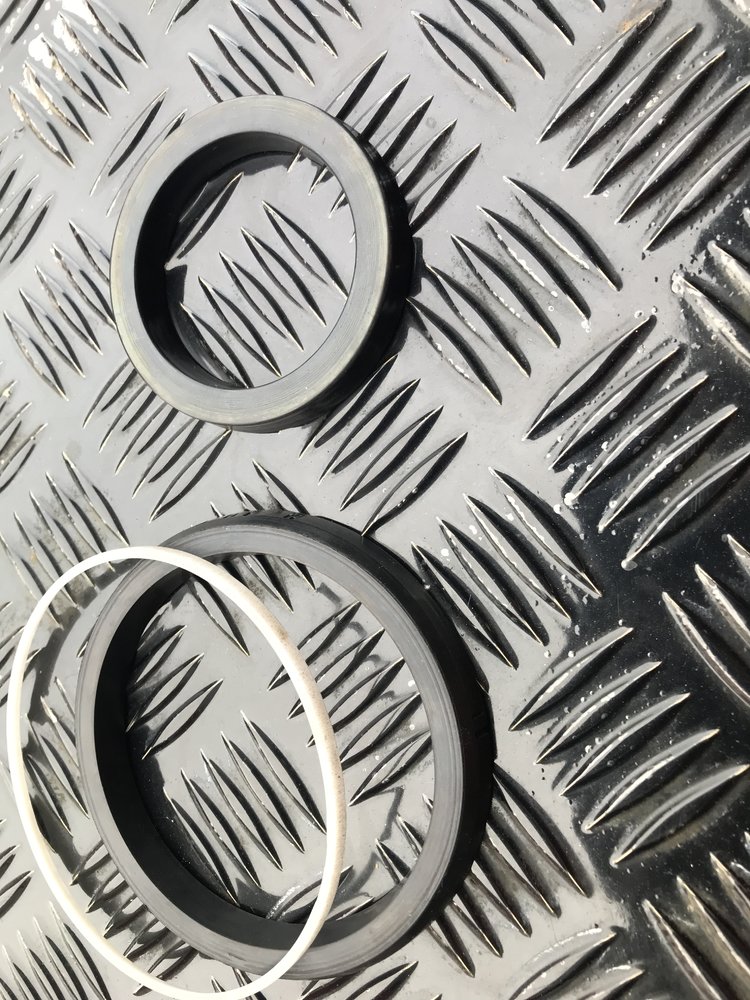

A u seal or u cup is a standard hydraulic cylinder seal fitted in single acting rams. Here are two examples from jacks I repaired recently both are tapered in section, but having slightly different features.most are parallel on the outside even when removed its unusual to see one that goes tapered out side thats all ,as most are on a steel rim that holds the shape
steel rim in" normal" seal is covered in rubber , but that taper makes sence in a hydraulic seal , appreciatedA u seal or u cup is a standard hydraulic cylinder seal fitted in single acting rams. Here are two examples from jacks I repaired recently both are tapered in section, but having slightly different features. View attachment 470978View attachment 470979View attachment 470980
No steel rims in sight
Looks like a cup (pressure) seal not a wiper/oil seal.
FPE Seals are the hydraulic industry supplier
it may be it can got to a 33mm shaft as a max?Also as a point of reference the 28mm is the ID but I’m not sure what the 33 is meant to mean next to it? Maybe that’s what it’ll stretch to?
The 48mm is the od
And it’s 10mm thick but I don’t know what the 5 denotes?
Oh brilliant. That looks about right doesn’t it! Thank youit may be it can got to a 33mm shaft as a max?
here is an option for a 28x48x10 cup seal for hydraulics
https://www.123bearing.co.uk/seals/seal/hydraulic/us-28x48x10-11-pu94
