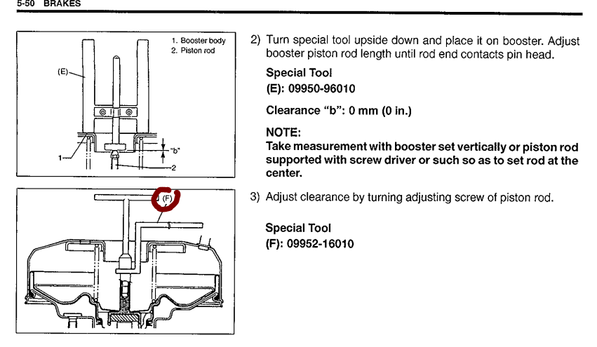

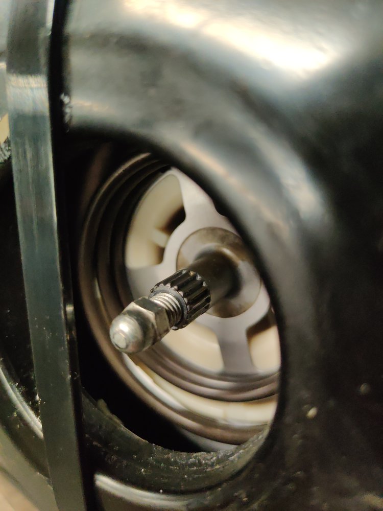

The pushrod on my buggy's brake servo is out by 3mm as I've mixed servo and master cylinder from different donor cars. Do you have any ideas on how to reach inside and hold the pushrod to turn and adjust it? It's pretty deep in the servo. I've posted a pic of the official tool, not too keen on the £50 price tag !
Edit: The rod has 19 splines so it's not a standard splined fit.
