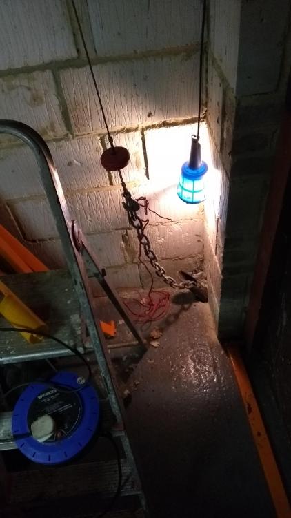

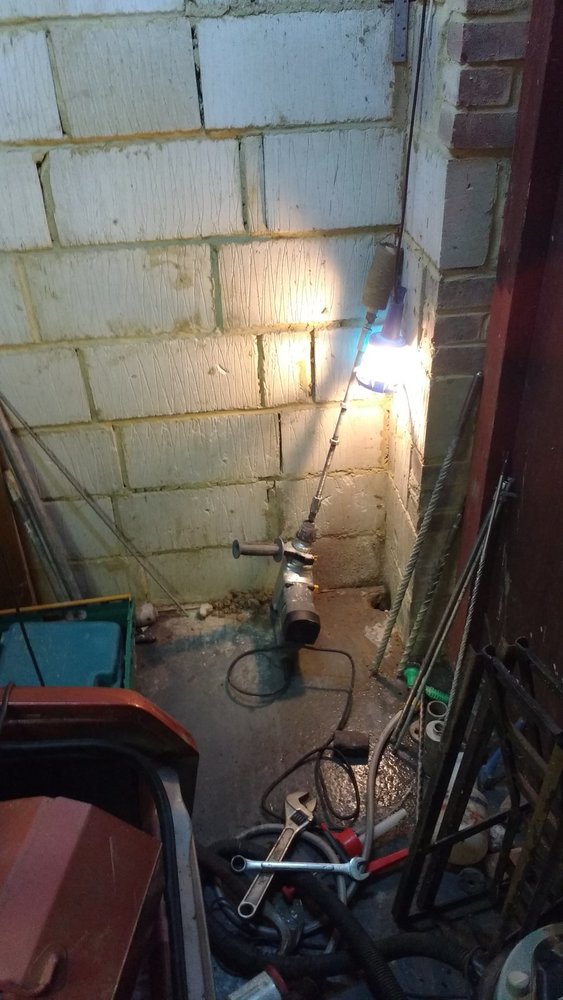

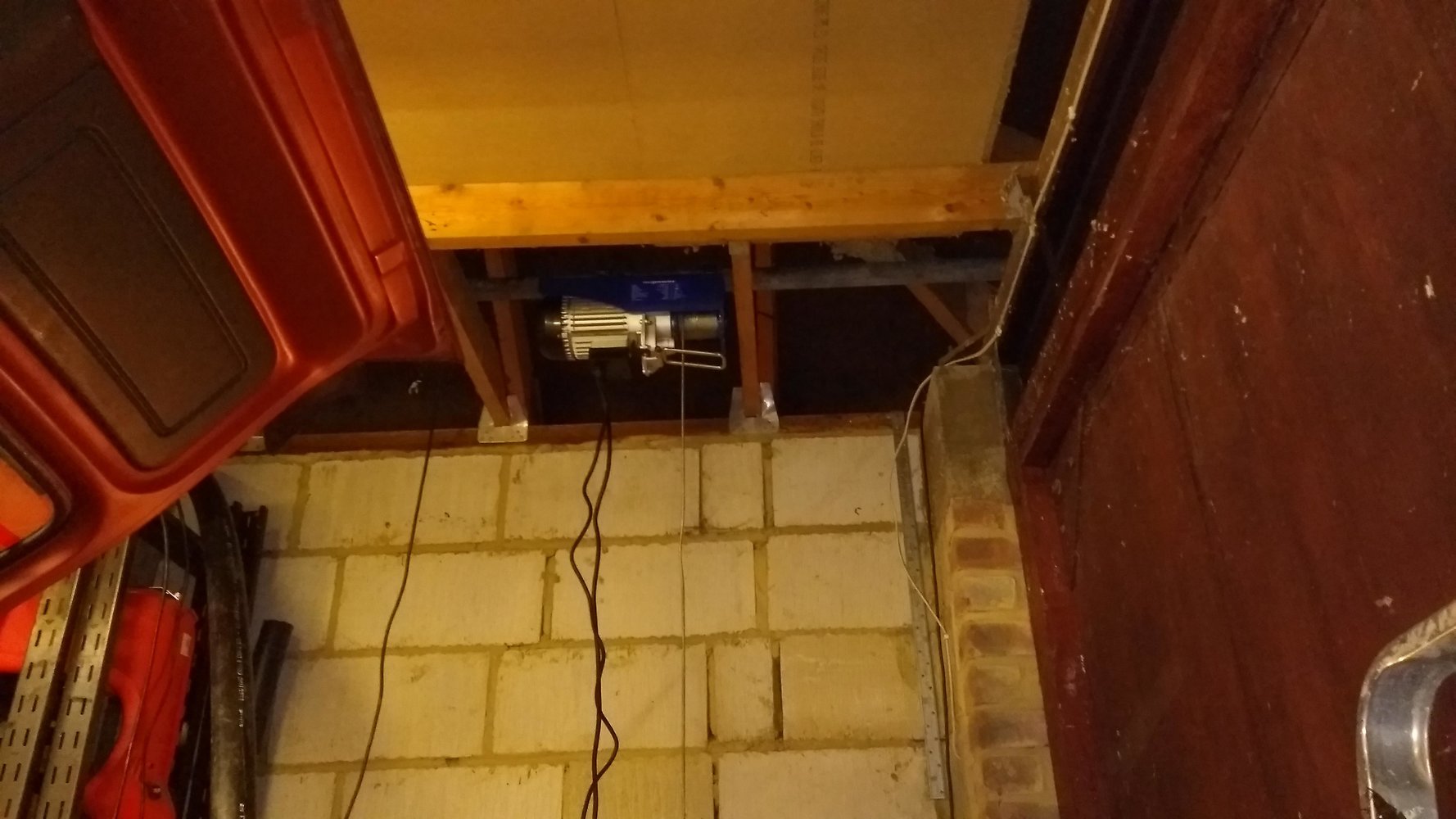

After a mega drilling session involving much cursing and stuck / broken SDS bits, I finally cored through my garage floor and footings. Then, involving an engine hoist I managed to pull through a length of DNO ducting. This goes all the way to the gate in a 700mm trench, hand dug, some 13m long.
Coming up inside the garage then I have this duct right in the corner of the floor. Its cut flush with the floor now:
Coming out of it now is a 3 core, 2.5mm SWA, a CAT-5 and a random 4 core screened flex for good measure. The two smaller cables are in their own 20mm corrugated ducts within the big duct.
Up top are the roof trusses and a 4x2 wall plate runs round 3 sides of the garage.
Looking for ideas how to bring the swa and two cables up in that corner then around the wall plate to the other side of the garage where there'll be a new consumer unit going.
50x50 galv trunking I'm thinking? Needs to be vermin proof.

if u have rats in the building bait the place up .i used to have a few but bait all round the buildings twice a year and got rid
