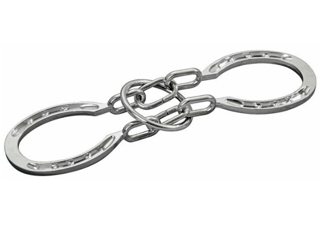

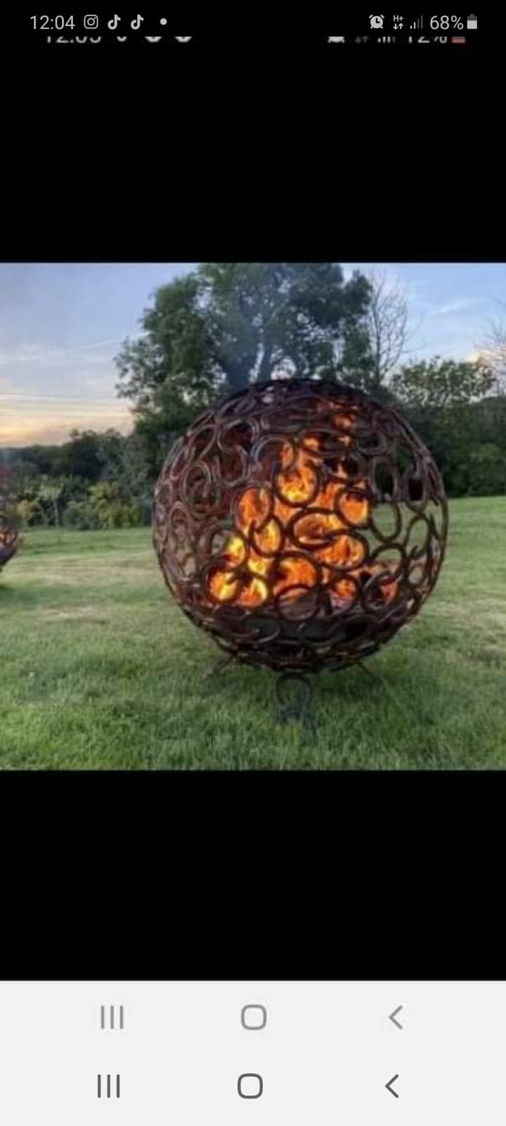

Is someone going to enlighten me then as it’s foxed me
OK, then...here you go. It's all in the twist when you fold them over on each otherSoak them in a citric acid solutionThese are just brilliant!

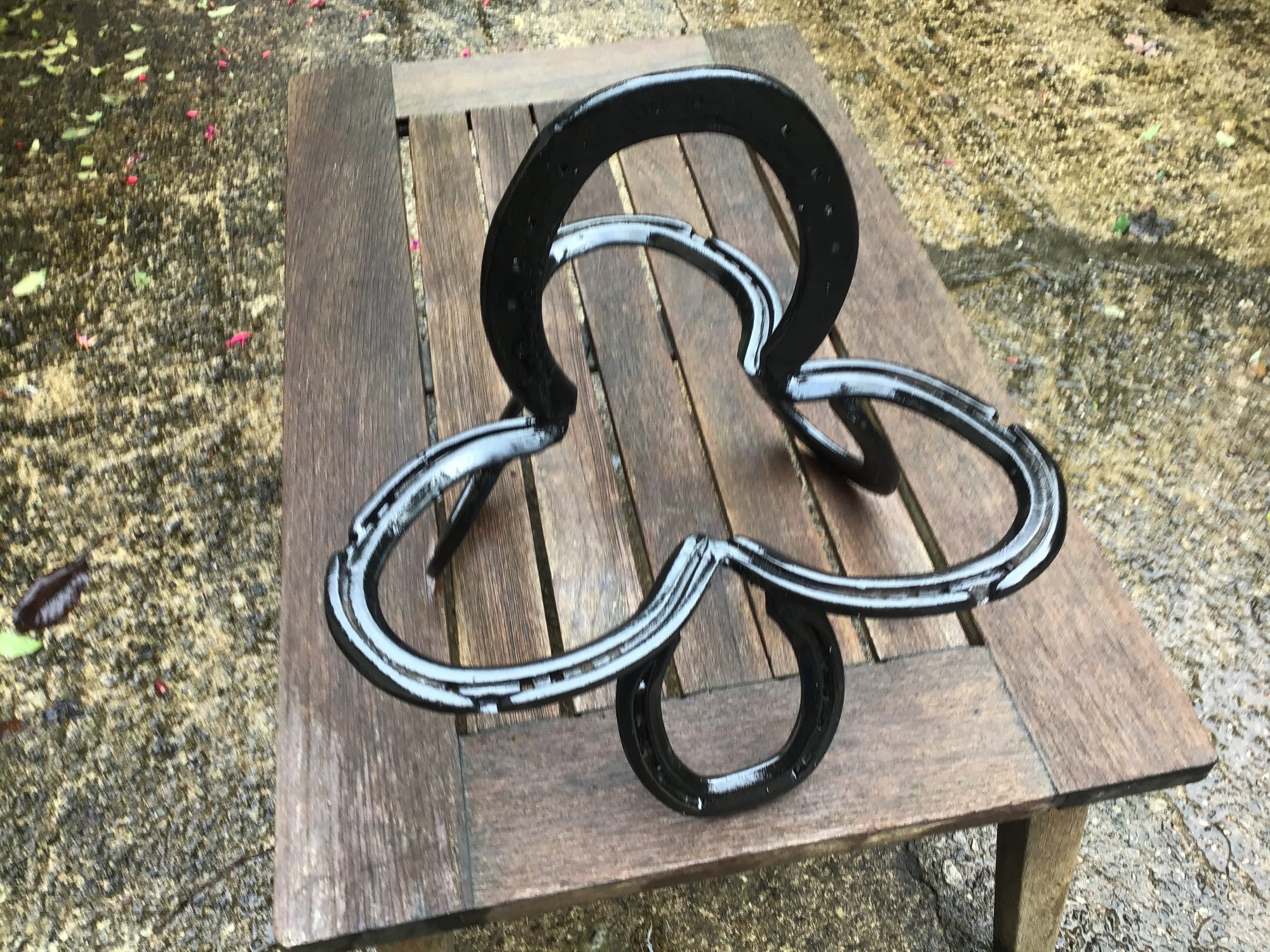

Best way to clean these dirty horseshoes? Grinder with linishing disc?
Well this has just blown me away!!!!!!Electrolysis, simple to make a bath and any old phone charger will give 5v for the thing to work, various solutions available cheaply which are added to water and you use scrap pieces of steel for the anode and connect the cathode to your metal parts being cleaned.

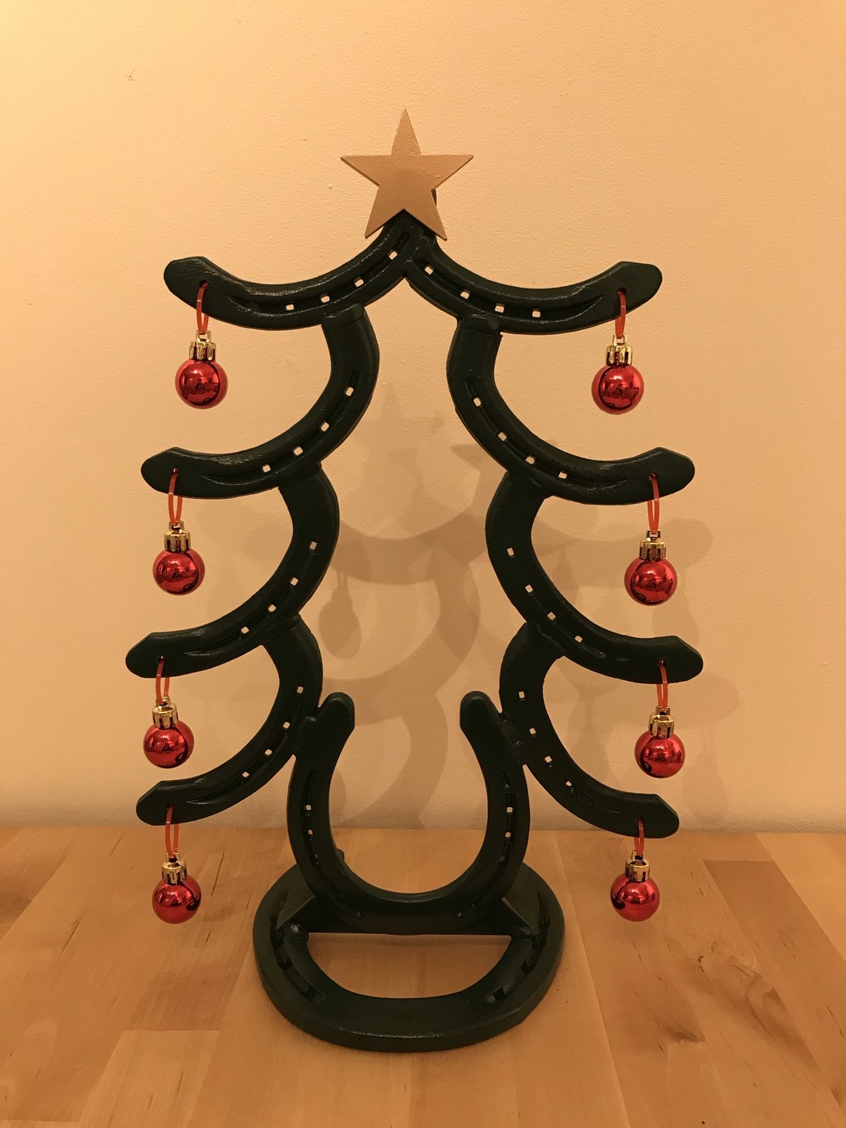

As above any ideas for stuff to be tacked or welded in a Christmas-theme but not horseshoes (don’t have any)? Any ideas, please?
Would happily send you over up to 20kgs worth of em for paotage cost 10-20kg is €32 but look round the neighbourhoodLocal farriers are generally delighted to get rid of horshoes....I got about 160 left at home from people I know just giving em to me
