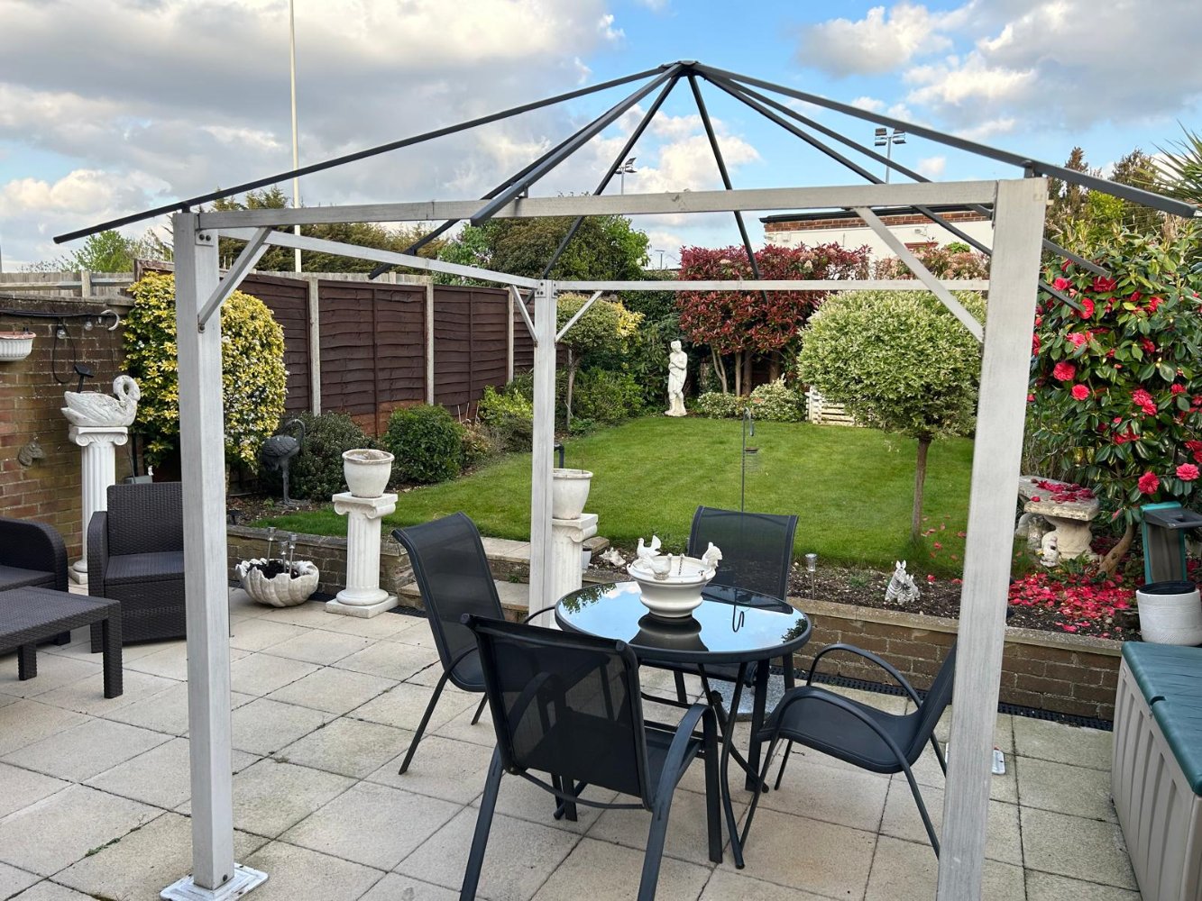

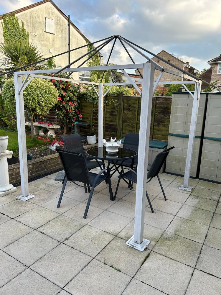

ok so we are going with the willow screening for this roof. I am planning on drilling the frame and wiring the willow into place
Are you meaning to run this up the fair corners kind of thing.can you get any metal trim like this
Metal Edge Shed Roof Trim - 25mm x 50mm x 3m
Designed to prevent wind uplift and keep the roofing membrane secure, the Edge Trim for Shed Roofs can be used in place of a piece of timber to...www.roofgiant.com
you want 4 pieces as it will give you something to fasten too the trims need to be at the 4 corners
you will need to flatten it off and rebend it to another shape or if you can get the 50x50 same material but you will have to slight flatten it to shape
yes it will give you something solid enough to fasten too at the corners between each run of the roof slopeAre you meaning to run this up the fair corners kind of thing.
the one you linked too is 1mm not 3mma mistake just noticed get the 0.8mm stuff not the 3mm as quoted above
bambo canes can also help with keeping the roof straight and you can drill them to fasten through them on the underside of the sheet trim used more as a support of those cane things your fine at the front edge by the look of it but you need another support higher up
use copper wire and twist it cheaper or stainless steel wire garden wire stuff its not that dear in a roll
