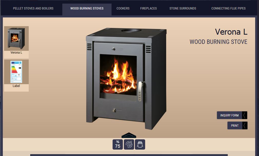

Looking at buying a tecnik stove in preparation for next years winter, 8 or 12KW.
I am looking at also heating the next room along from my weld shop.

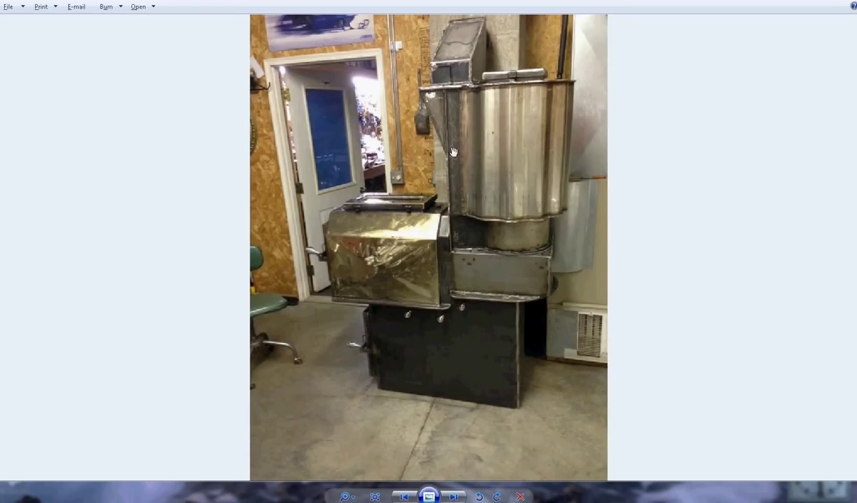

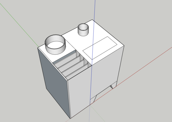

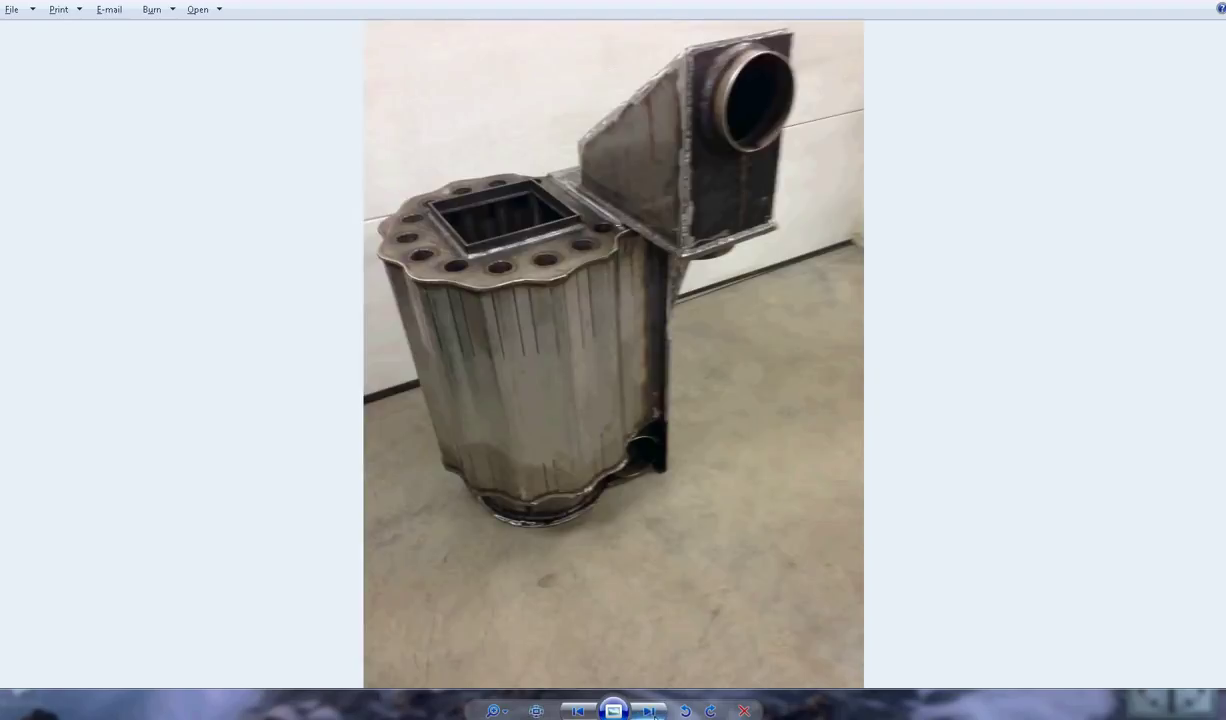

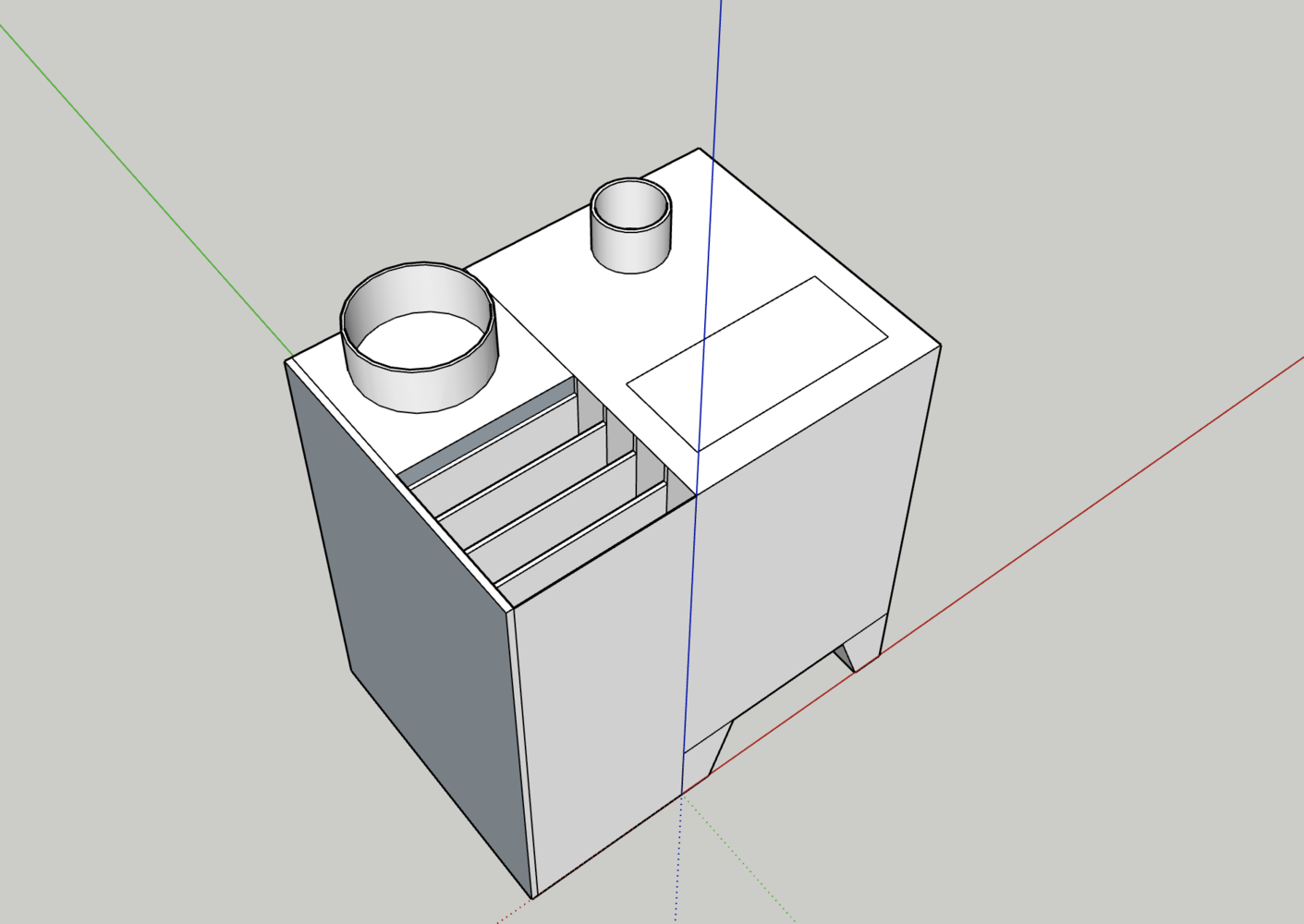

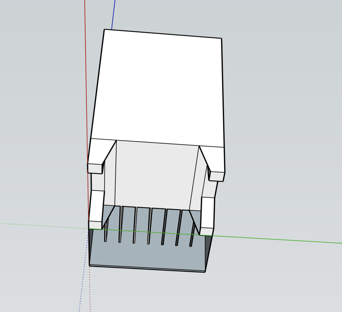

Had an idea to weld on to the side of the burner a steel box, with 6mm steel plates as fins, then having the outlet going to 200mm ducting. The inlet would be from the underside of the stove. I have seen inline heat resistant ducting fans which are fairly affordable i could add into the ducting.
What do people think?
