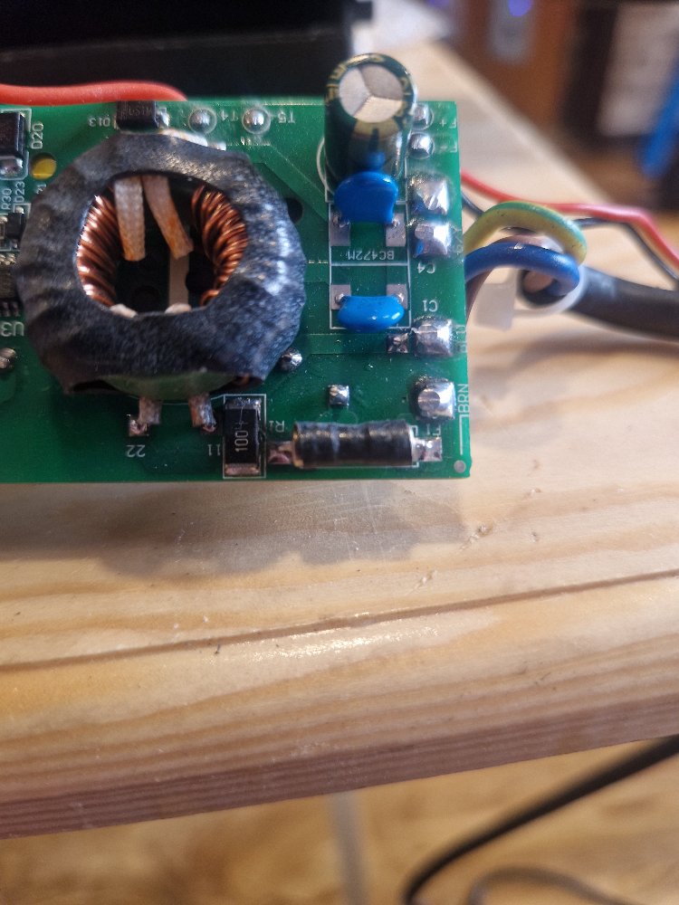

Black component bottom right of the board, labelled only as F1 and appears (although there are no visible tracks to or from either side) to be the main incoming fuse...it is soldered on one end right next to the live 240v ac and the other end has a resistor labelled 1004 and measures at 920k ohm on my admittedly amateur meter...
Component F1, that i have to assume is a fusible link, is showing no continuity, OL on resistance...haven't tested it hot but can if needed although being Chinese im not too keen to get where near it when its plugged in
Question is, what value fuse do I need?
Its an 1100w induction heater board from a hand held nut buster type heater. 240v AC raw into it at this point, rectification happens afterwards from what I can see.
I'm not fantastic with electronics, but I can solder and do basic testing
Edit, looking st the photo I can now see there are tracks, although difficult to see by eye...fuse is definitely connected to main 240v brown wire, and then the fuse mentioned which then goes on to feed the torroidal transformer, that then feeds back to neutral on the 240v
