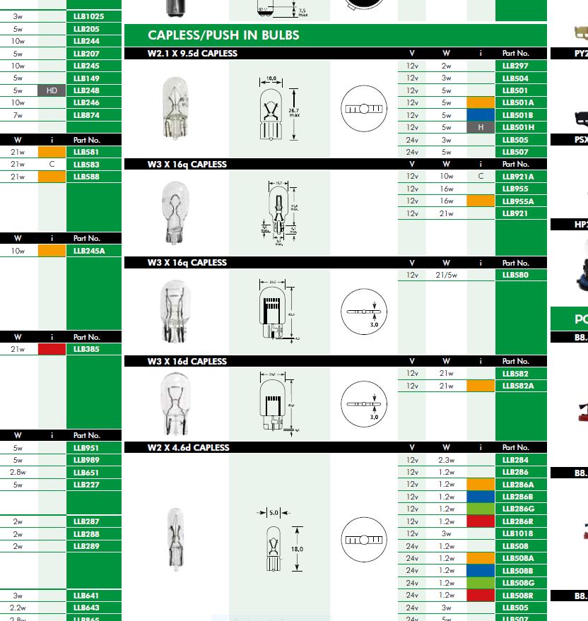

There's also a 297, which is 2.2W.As said before either a 501 or a 504. 501 is 5w and normally used as side light bulb. 504 3w and normally used for dash lights etc.

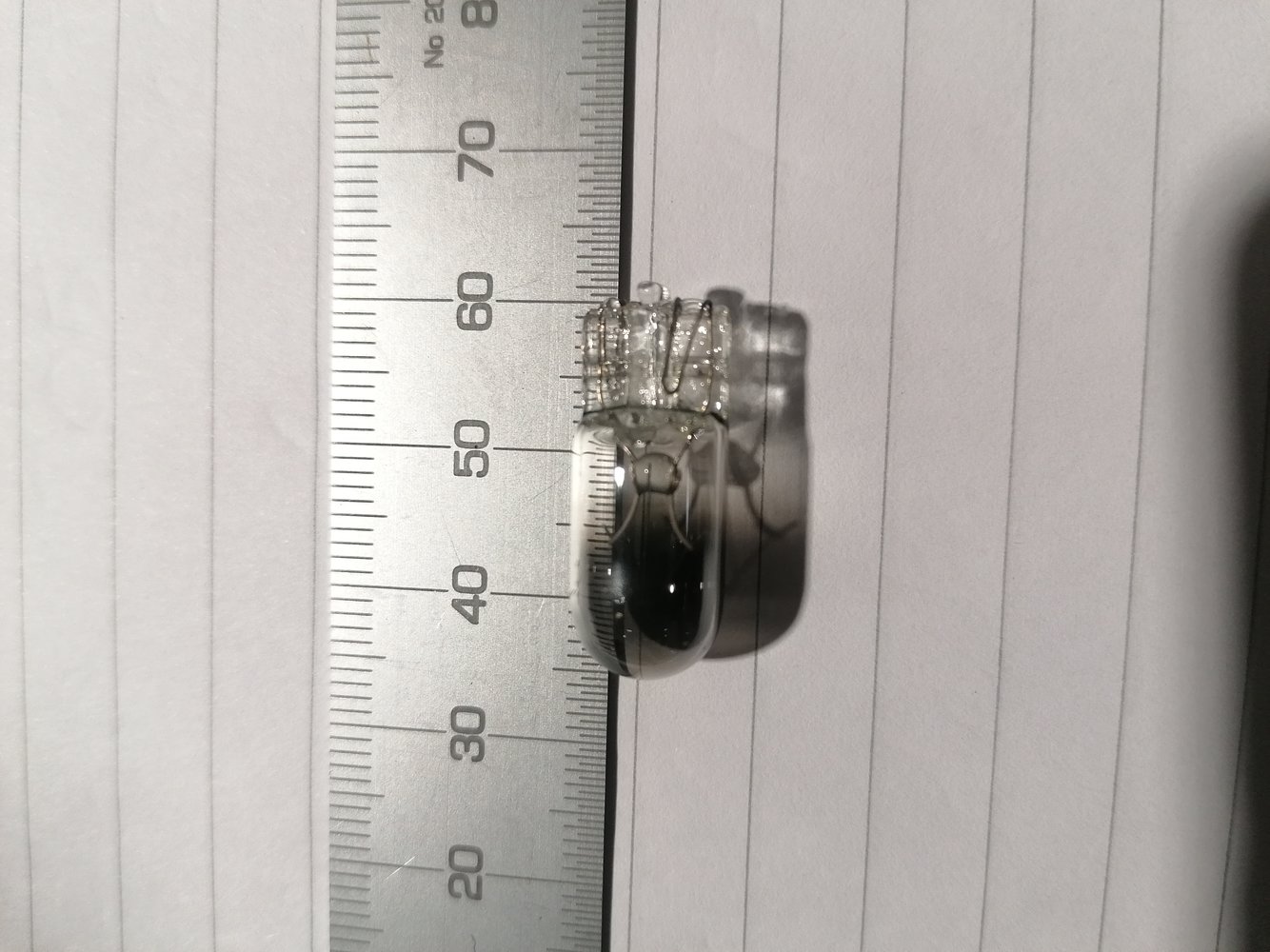

Thanks, been at it with the magnifier but no luckThere's also a 297, which is 2.2W.
The markings on these bulbs often come off all too easily. Sometimes it's possible to make out seemingly invisible markings, with the right lighting and a decent amount of magnification.
Sorry I should have given all this info in the op.What vehicle is it from, and which bulb? Instrument panel or sidelight? It could also be a 504.
Never seen a 297. I used to sell a lot of 286 bulbs which were smaller than the 501 and only 1.2w.There's also a 297, which is 2.2W.
I've a couple here, which might be 297. The same physical size as the 501 type, but marked 12V 2W. I think they were bought for an older style car instrument panel.Never seen a 297. I used to sell a lot of 286 bulbs which were smaller than the 501 and only 1.2w.
