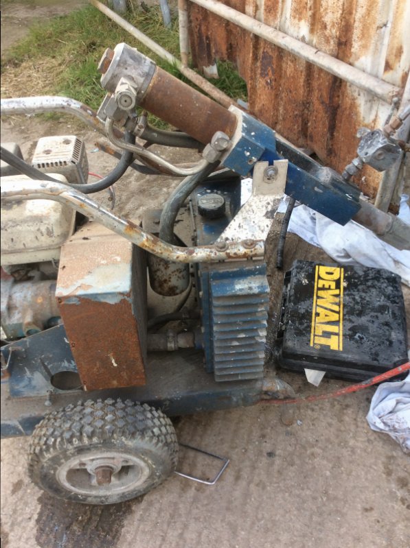

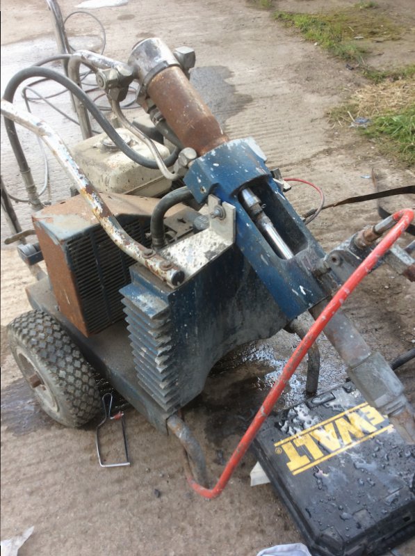

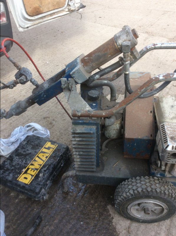

A bit of a long shot but I've just got a airless sprayer but it's got no name or markings on it . I was wondering if anybody could identify the make ...all I know it's Italy on the filter ...
Any help would be great fully received ..
Cheers Keith

The gun isn't to bad I gave it a clean as well as the filter, but the seals on the rod that's goes up n down have gone because when I tried it this morning there was thinners coming out ..
not sure where you'd get seals for that exact model, but once its clean i expect there will be a name on it.
