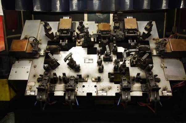

The state of the robot welding fixtures even though the operators are supposed to clean them at end of shift

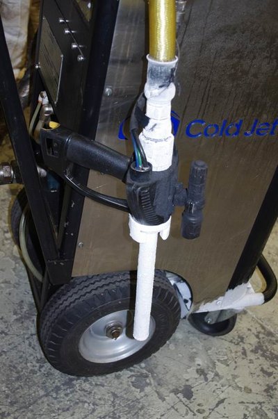

The "business" end, different shape/size nozzles used depending on application, the top attachment is a torch.

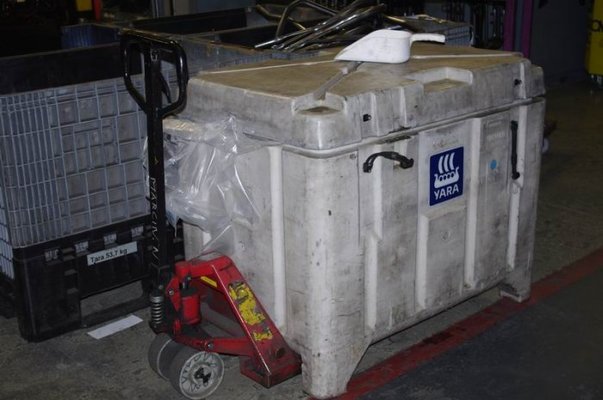

Pellets come in an insulated box, also handy for big picnics

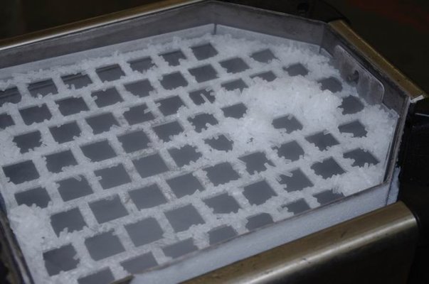

Different size pellets available, but using 3mm for this job, being loaded into machine hopper.

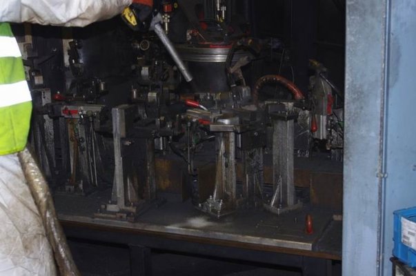

A couple of pics of blasting process

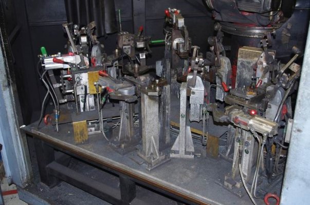

A different fixture, but before...
...and after
I'm sure they'll all be looking a lot worse by the end of next weeks production
...and after
