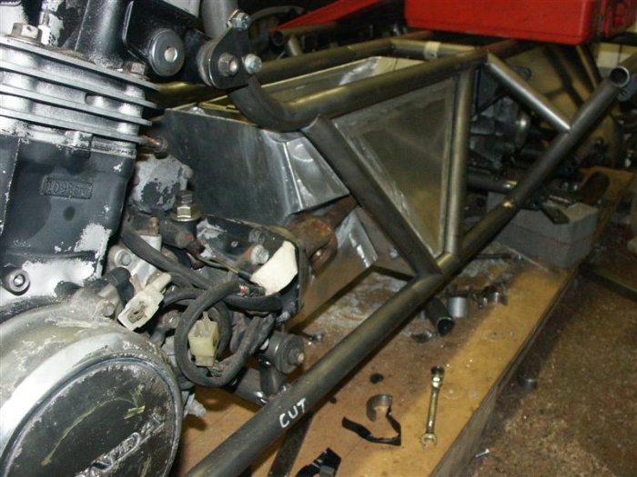

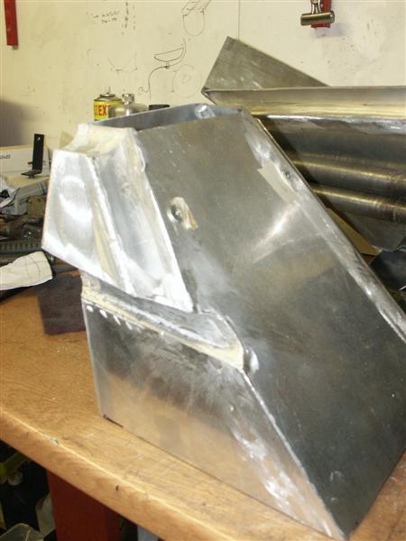

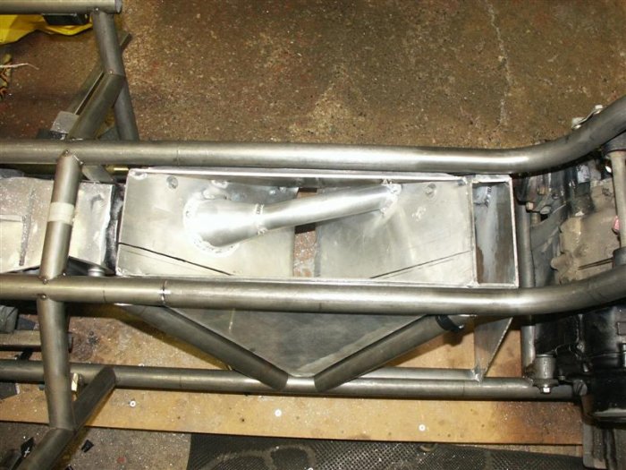

If someone came to me and asked me to do this, I'd of either sent them off with a flea in their ear or laughed all the way to the bank. However this job was all my making

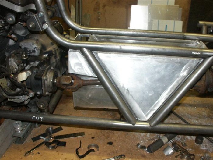

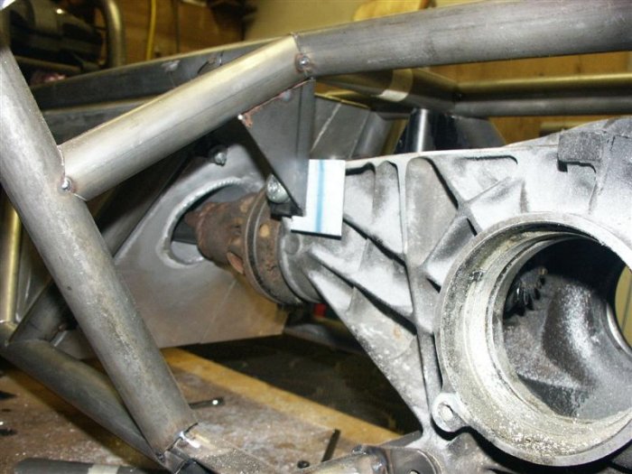

It's a battery box for a VF1100 Trike I'm building (don't ask) anyway the propshaft intersects the secondary petrol tank and goes through the battery box, not happy with that little conundrum I decided they would look better if the corners followed the frame tubes (1.125") so they are convex

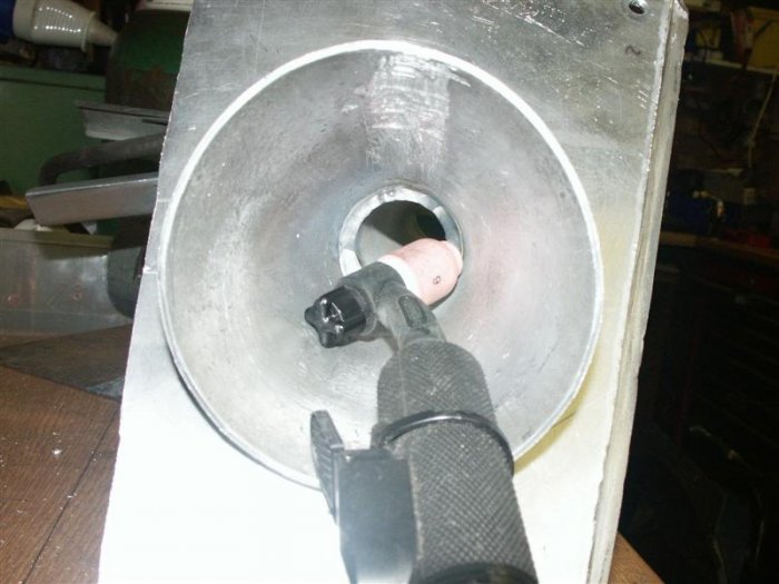

Torch in the pic is a WP9

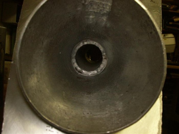

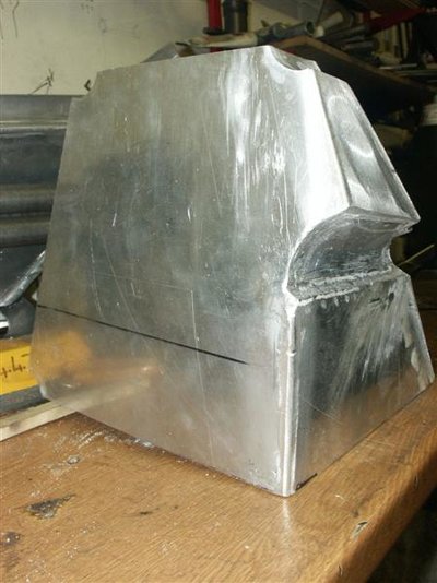

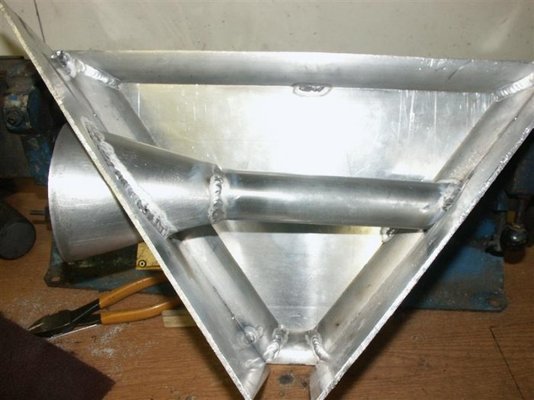

The last few are of the petrol tank, oh and the bit of cone sticking out will be cut off
So here are a few pics, it's still a bit hot to offer back into the frame, I'll take them later tonight
