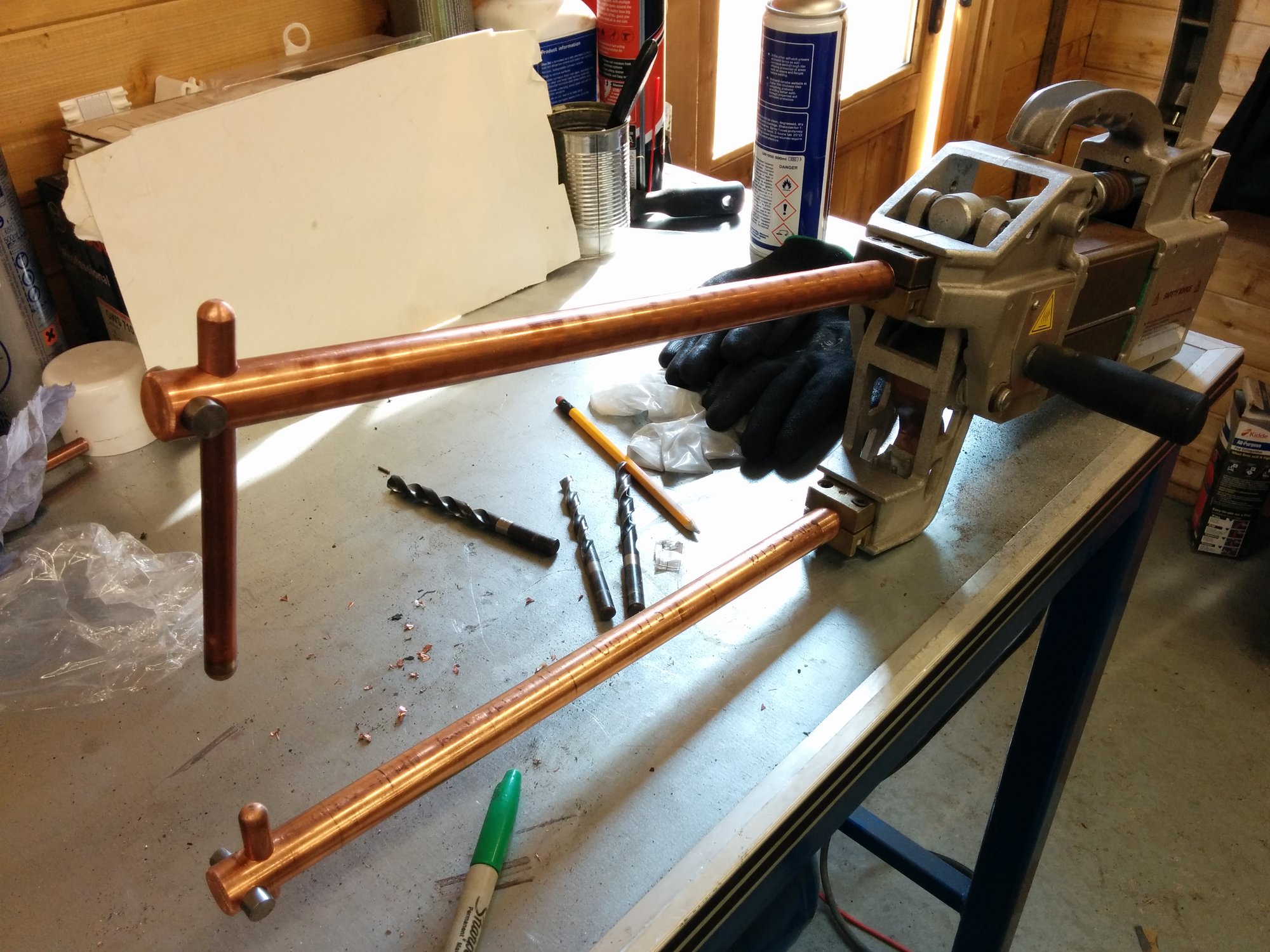

Those are made from copper zirconium alloy which is the correct stuff for welding electrodes. You buy the rod stock, cut to length and drill and shape electrodes. On my welder the stock for the arms needs to be turned down on a lathe where the welder clamps it but it's a simple job so so shouldn't be too expensive. All materials available from JayMig welding supplies.
