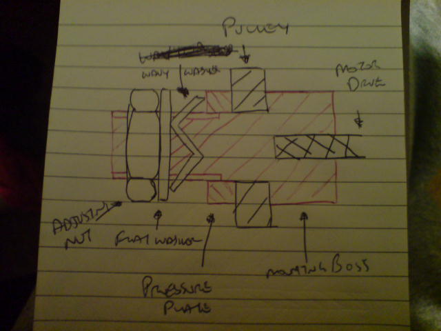

This is for an audio project, so i may as well describe it in those terms, although the job will be much smaller...
On one of these record players -
the motor is directly coupled to the platter. There's normally a felt style mat between the platter and the record, so, when the DJ wants to adjust the record, the platter and record slip, relative to one another.
Hence the felt thing being called a "slip mat"
All well and good, but i want to do this kind of thing, but on the vertical. The motor will be way smaller, probably one of these -
https://www.rapidonline.com/rvfm-my355-2-phase-bipolar-stepper-motor-12v-37-0507
(cant link to the image)
Or similar.
The stepper will be controlled by an arduino, but i need the end user to be able to stop the rotation without stooping the motor. Of course, if this were horizontal, i could just use a felt mat, but its not, so i cant.
Is there a sort of coupling that i can use that slips when the torque rises? But that would slip at really quite minimal torque, as the stepper will be small.
The alternative is to to it in software, with a momentary button, but that's kind of not as nice.
