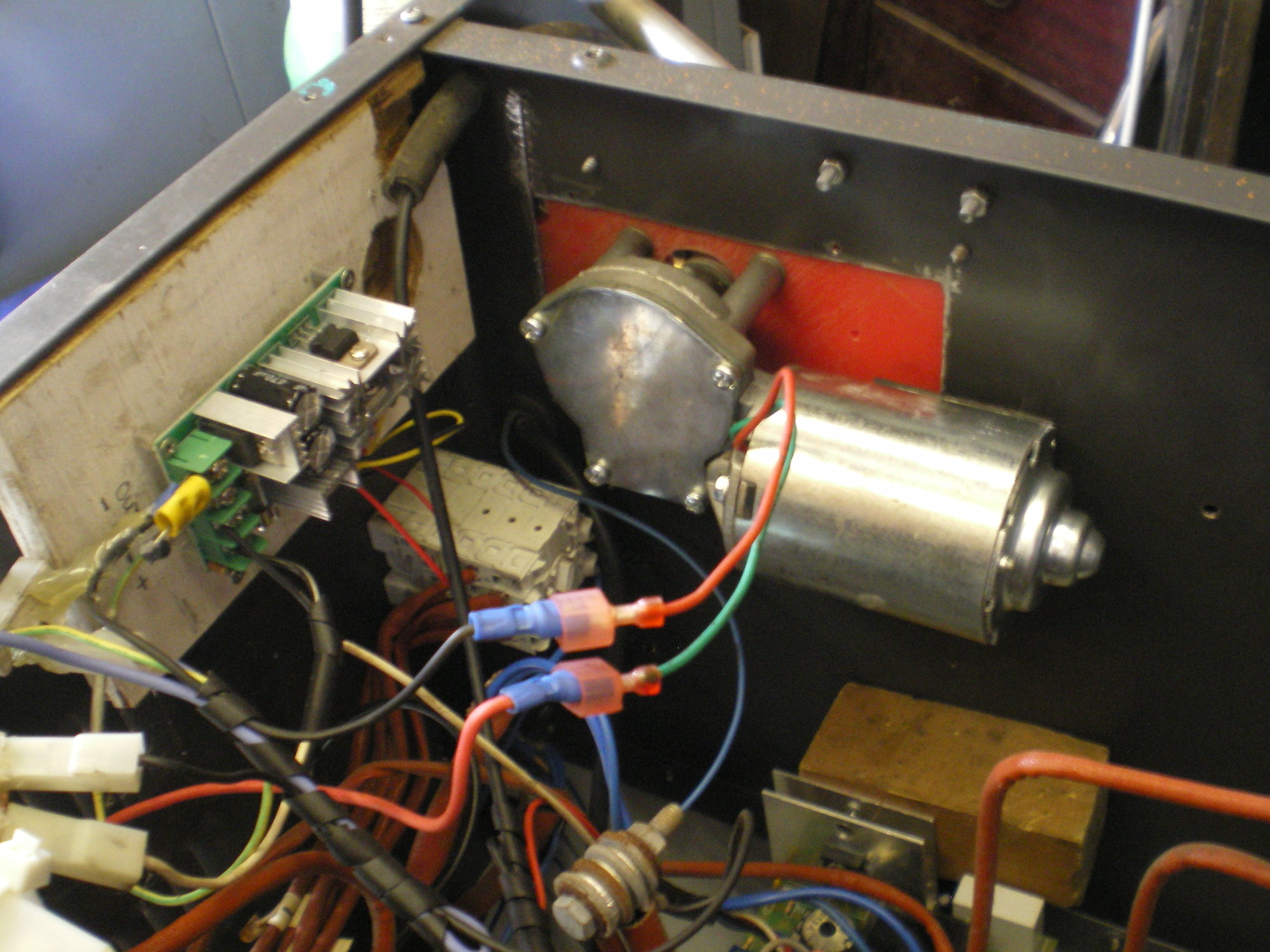

I bought an Autoplus 150 a while ago and did the seperate wire feed PSU and pulse width modulation motor controller mods. It now performs very well and is my go-to machine.

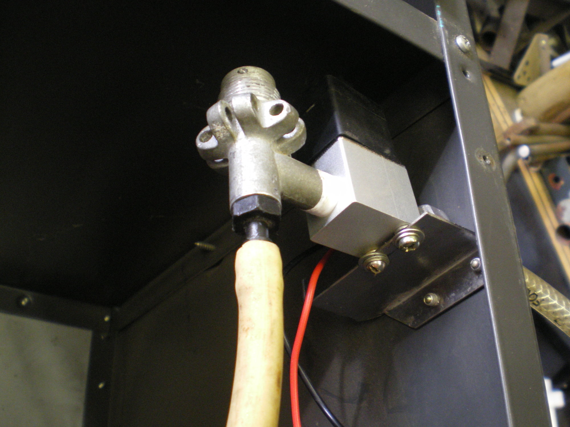

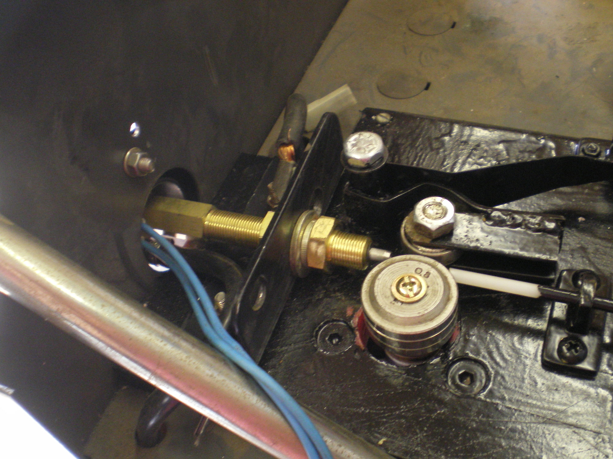

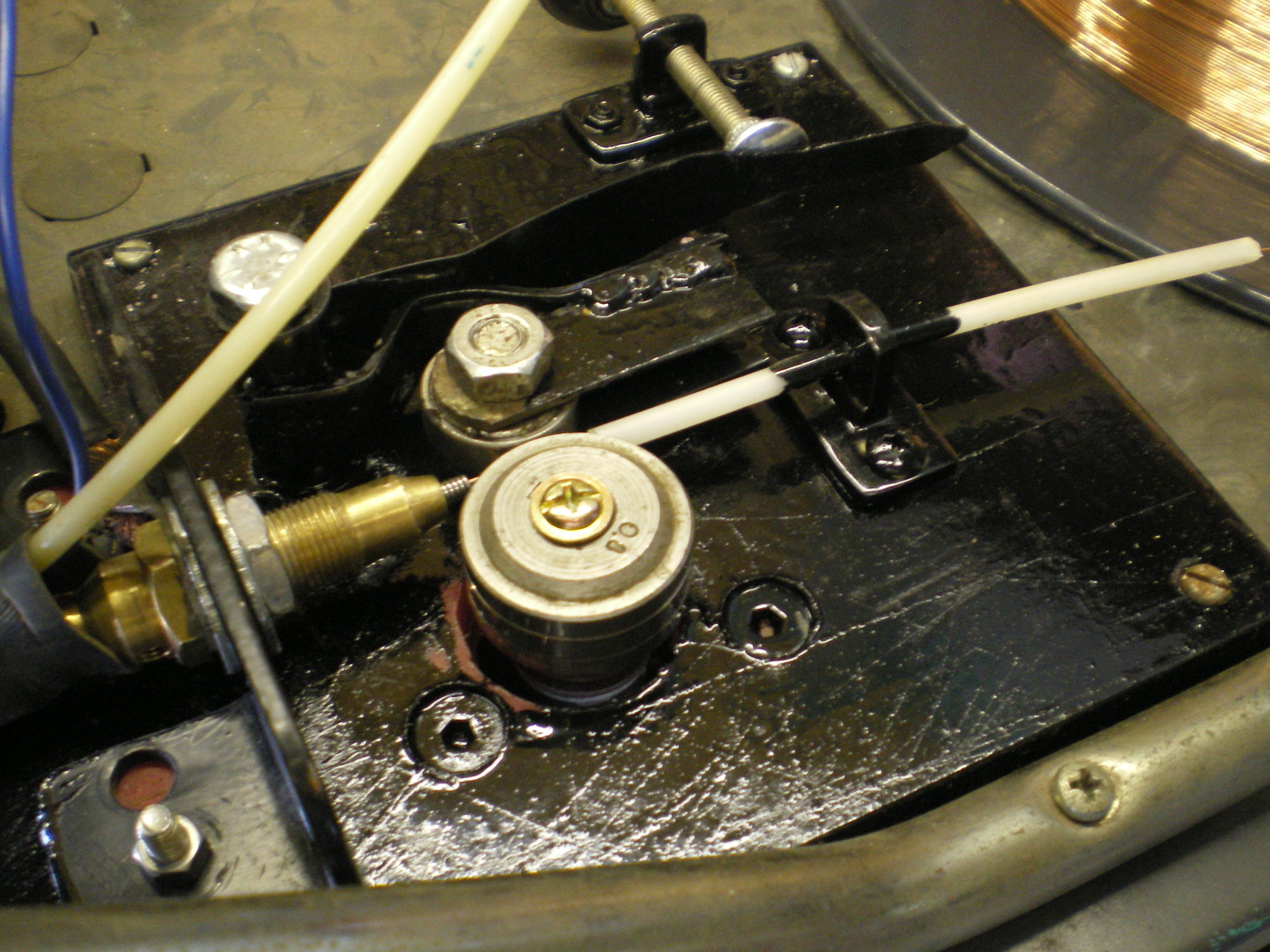

So I decided that while I am in forced isolation at the moment I'd have a go at making a new feeder. I'm a bit of a collector and have accumulated a few different motor/gearbox combinations since I started playing with SIPs a few years ago 'just in case'. One of them looked to be a good candidate and so the feeder in the pics was put together.
Built on an industrial kitchen cutting board (shenion idea I think) and using a spare feed roller which just happened to fit the output shaft it isn't pretty but it works very well indeed. Smooth and powerful and glitch-free. I am pleased as punch.
A quick coat of black as it was a gaudy bright red board and also
