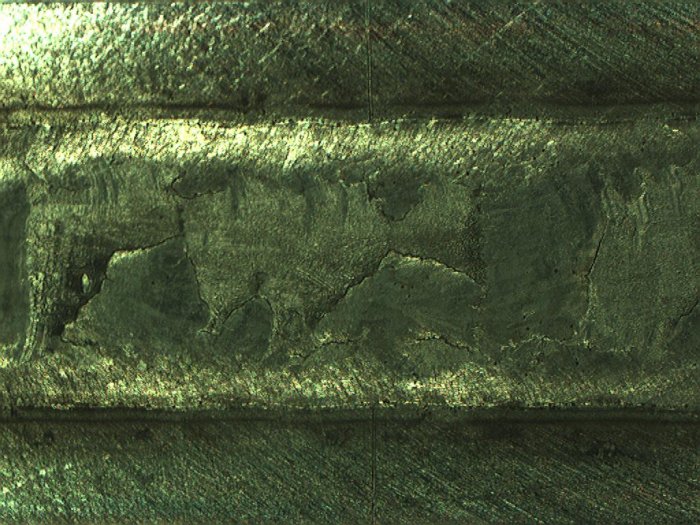

Mmm.....thanks for your advise. but can I consult you,why the weld pool of the high carbon steel after Tig process ,it very uneven??because of the electric current parameter??or..................
Have you done TIG before? If you have not, it may be your technique. Are you managing to keep the electrode gap (distance between the torch electrode and the weld) small but constant?
There are several other potential causes, it could be:
- Fault of the welding machine
- Shielding gas (argon) problems
- Cleanliness of the metal being welded
Hve you cleaned the metal with a wire brush before welding?
Then wiped the metal with a degreasing solvent to remove any oil/grease/dirt?
I usually welding the stainless steel .Today I try to welding the high carbon steel after i found the weld pool was very inhomogeneous than stainless steel. I know my english is very poor and I will keep learning. Thanks..
It looks like it needs preheating, 6mm is pretty thick and high carbon will turn brittle when it is heated and cooled quickly and that is what happens as you weld. What filler rod are you using? EWTh-2 is the tungsten, 2% Thoriated which should be fine for your job.
You need a gas torch or an oven to heat your metal before you weld it, it is not part of your tig machine. Heat it till the metal turns blue and it needs to cool slowly.
