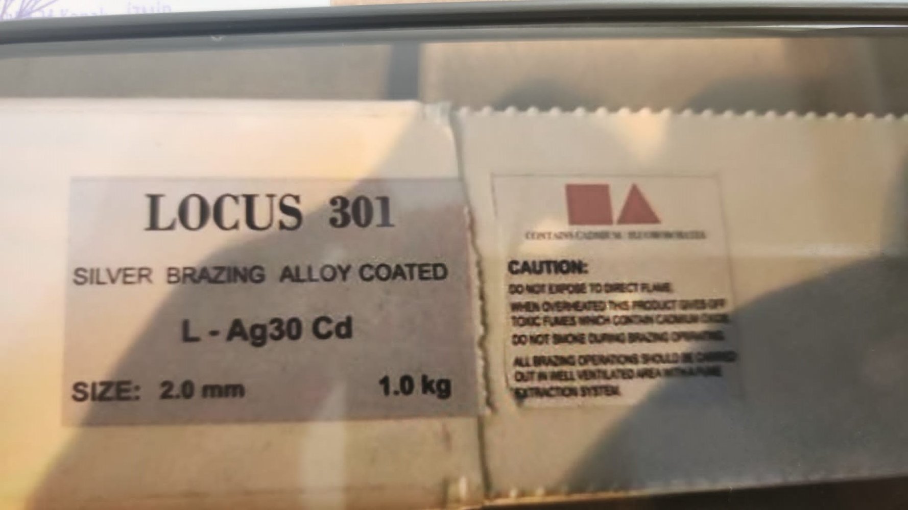

K kurtech New Member Messages 1 Location Turkey Oct 23, 2023 #1 Hello everybody, I'm Bahadır form Turkey. I need a silver brazing wire. It will be "L-AG30 CD" and the brand or model name is "Locus" as you can see on the attachment. Have your heard this brand before and how can I find this brand?

Barking Mat Cuddler of hedgehogs. Messages 13,482 Location France, Brittany. Oct 23, 2023 #3 Lots of things on the internet, what welding style do you require ? Mig / O/A ?
500e Always buy fire insurance a flood is a hard start Messages 9,279 Location South West Oct 23, 2023 #4 Could it be a local suppliers name ? high temp =301 Here is a AG40 sheet https://www.springwelding.com/pdf/Ag40Cd.pdf

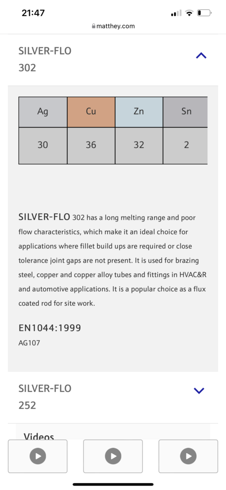

V voipio Member Messages 3,956 Location Not Cambridge Oct 23, 2023 #8 Hmmm, Silver-Flo seems a bit of a misleading name for something that doesn't flow very well.
