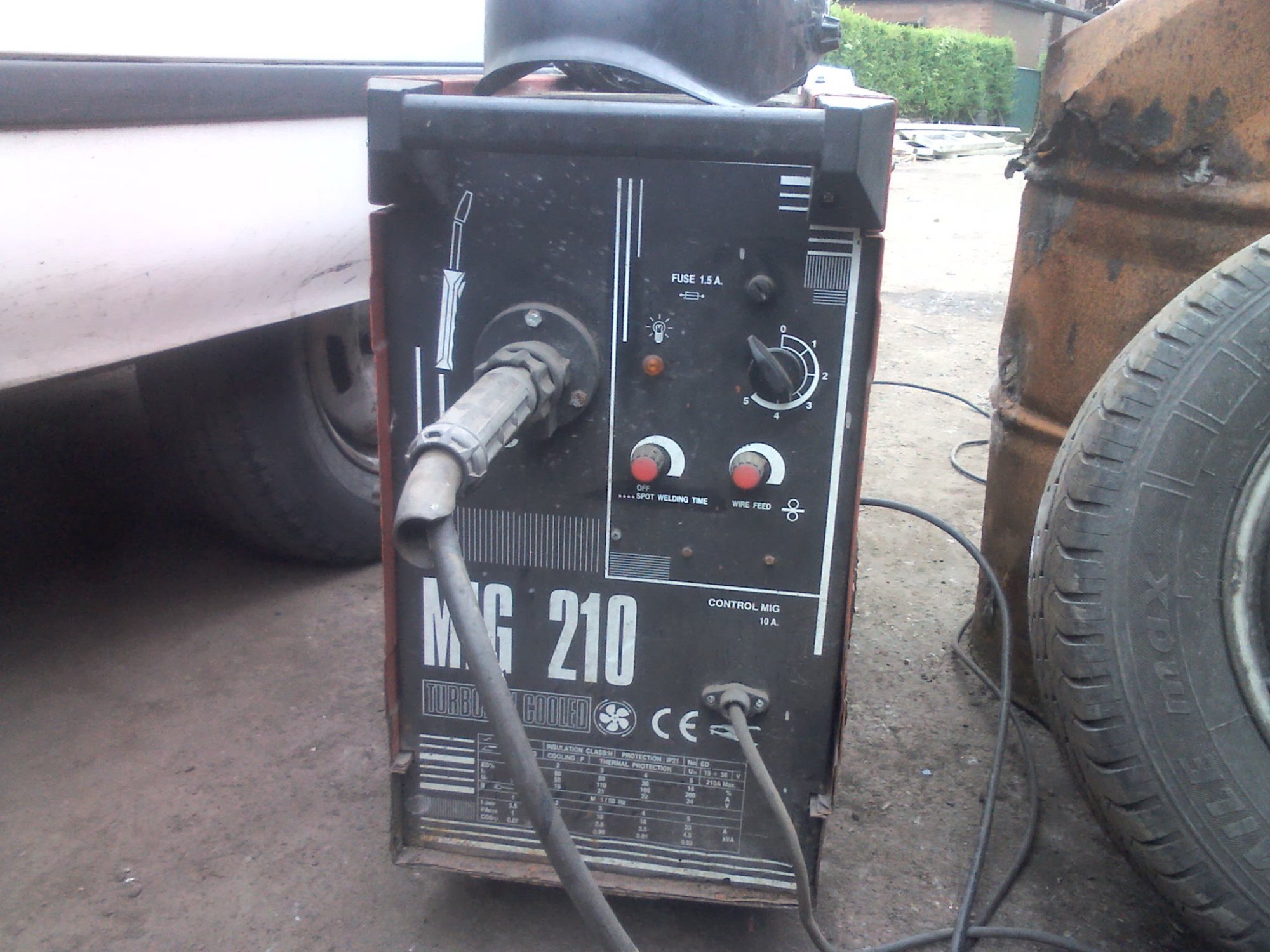

Karl83 New Member Messages 6 Location Manchester May 30, 2016 #1 which i cant identified it a great welder and only paid £100 for it with a full bottle as well IMG00318.jpg 390.6 KB · Views: 150
skotl Forum Supporter Messages 10,331 Location Edinburgh, UK May 30, 2016 #2 Good work! Might be a SIP but then it might be any one of a dozen makes
Karl83 New Member Messages 6 Location Manchester May 30, 2016 #3 work a treat but the cooling fan doesn't work hence need to know the welder to but a new one
WorkshopChris Member Messages 5,049 Location South East Essex May 30, 2016 #4 Welcome, The fan will be a standard part just need to know the voltage and dimensions. Any chance of a photo.
addjunkie Member Messages 14,058 Location Northumberland. Reet oot in the sticks May 30, 2016 #5 Ive one looks similar with ERP on the side, they were a box importer from hull, if memory serves me correctly, but as said above, any fan will do as long as voltage etc is the same
Tiggy_dorset It looks just like a bought one! Messages 1,970 Location Weymouth, Dorset, UK May 30, 2016 #6 As above, ERP is a good start. See link below. https://www.gumtree.com/p/welding-equipment/erp-mig-210-turbo-welder-230-volt-3-phase/1166131239
Wozzaaah The wizard of woz Staff member Messages 17,594 May 30, 2016 #7 I believe a lot of ERP stuff was made by Telwin and was fairly decent stuff. Telwin machines are sold under many names including Sealey.
gordon stephenson Member Messages 7,468 Location Skelton in Cleveland U.K. May 30, 2016 #8 Are you sure that its not a fan on demand, Ie: fan only runs if the machine starts to get too hot?
Wozzaaah The wizard of woz Staff member Messages 17,594 May 30, 2016 #9 Being a transformer machine it's unlikely, normally the fan runs as soon as its powered up.
xmetal Member Messages 301 Location Solihull, UK May 30, 2016 #10 Time to open up the case, check the fan to see what voltage it is and then try running it off an external PSU if the fan spins freely.
The_Yellow_Ardvark https://www.death-clock.org/ Messages 19,988 Location Going Away. May 30, 2016 #11 Open the case, measure voltage to fan. go to Maplins by a replacement and fit. Aprox £20, if that.
