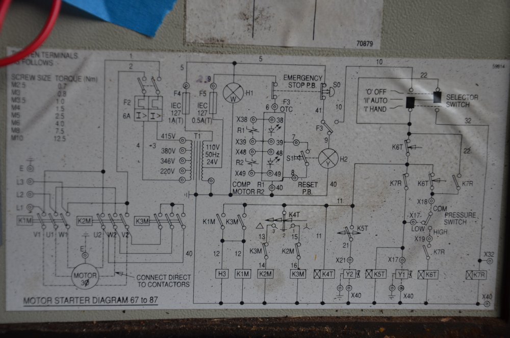

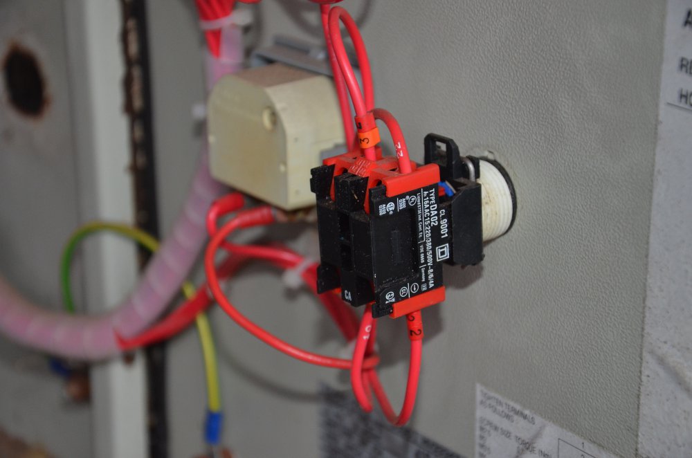

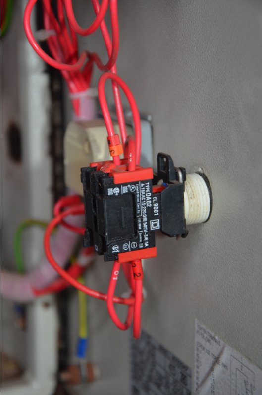

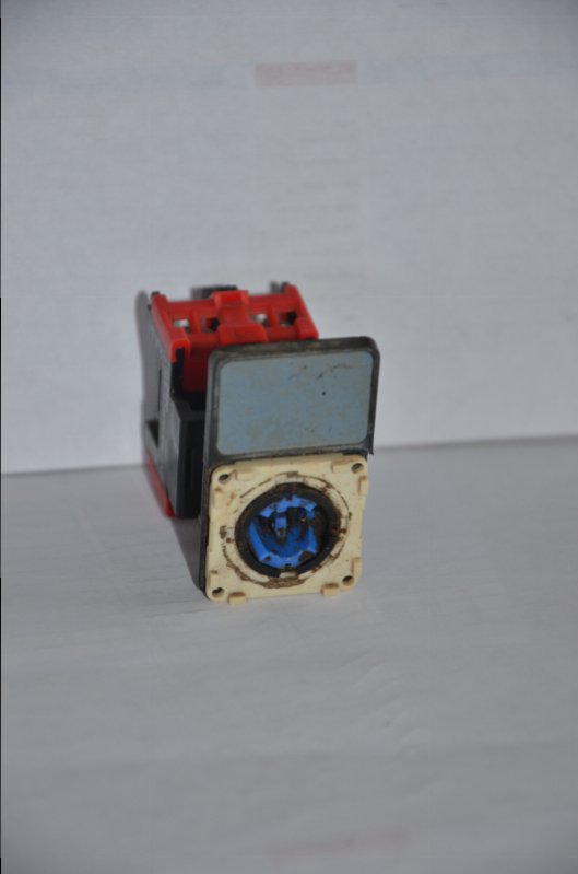

The contact block will have terminal numbers on, either 1 & 2 indicating N/C or 3 & 4 indicating N/O contacts. Assuming it is N/O contacts buy one of these (2 N/O) and connect wire number 22 to both terminals 3 (link together) then wire number 10 to one terminal 4 and wire number 32 to the other terminal 4
