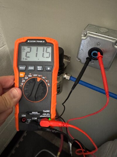

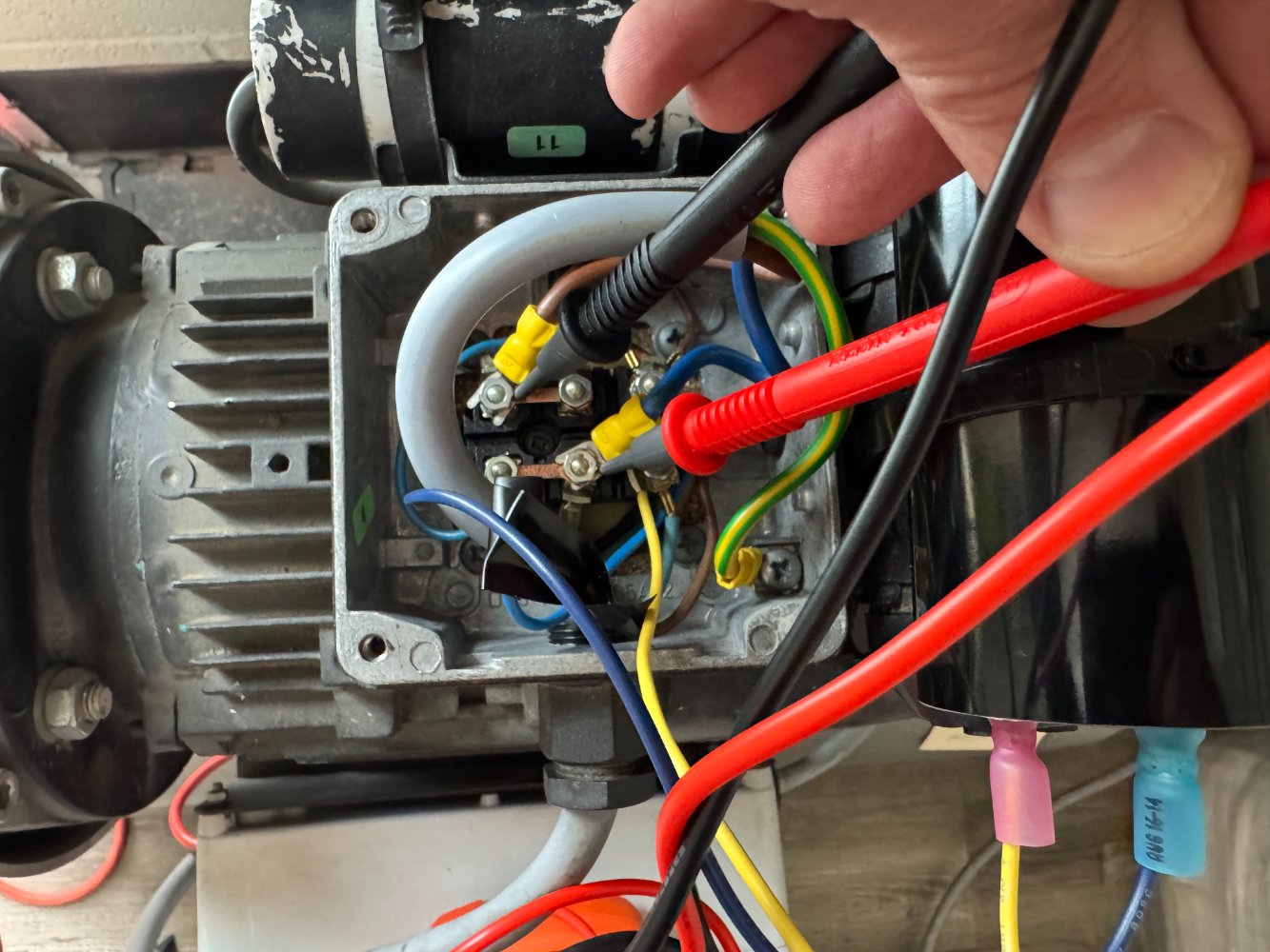

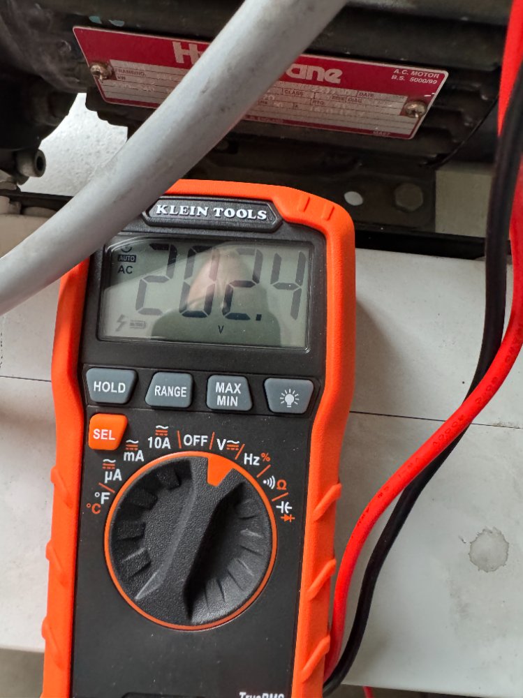

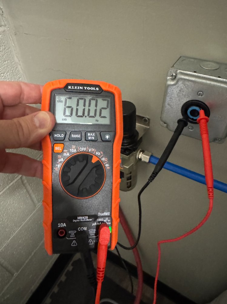

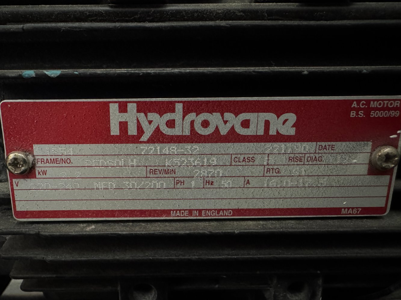

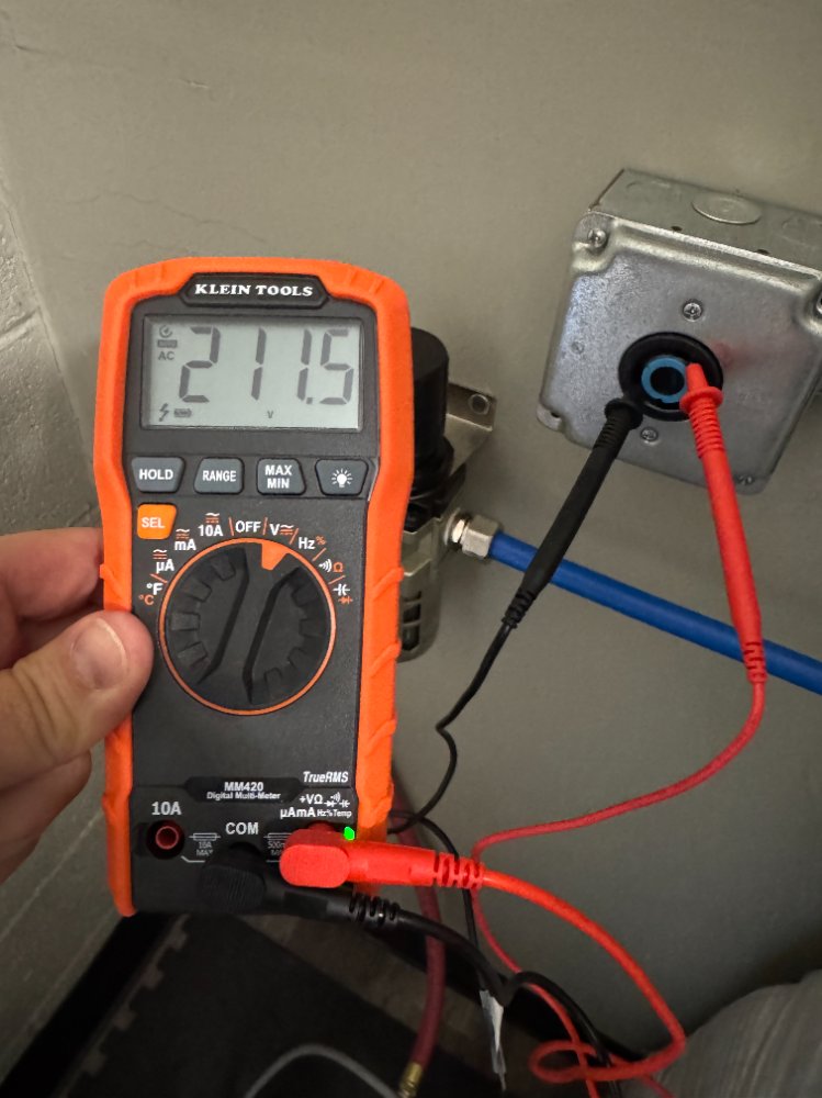

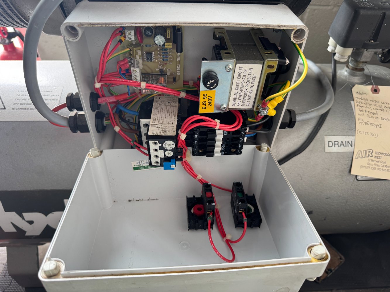

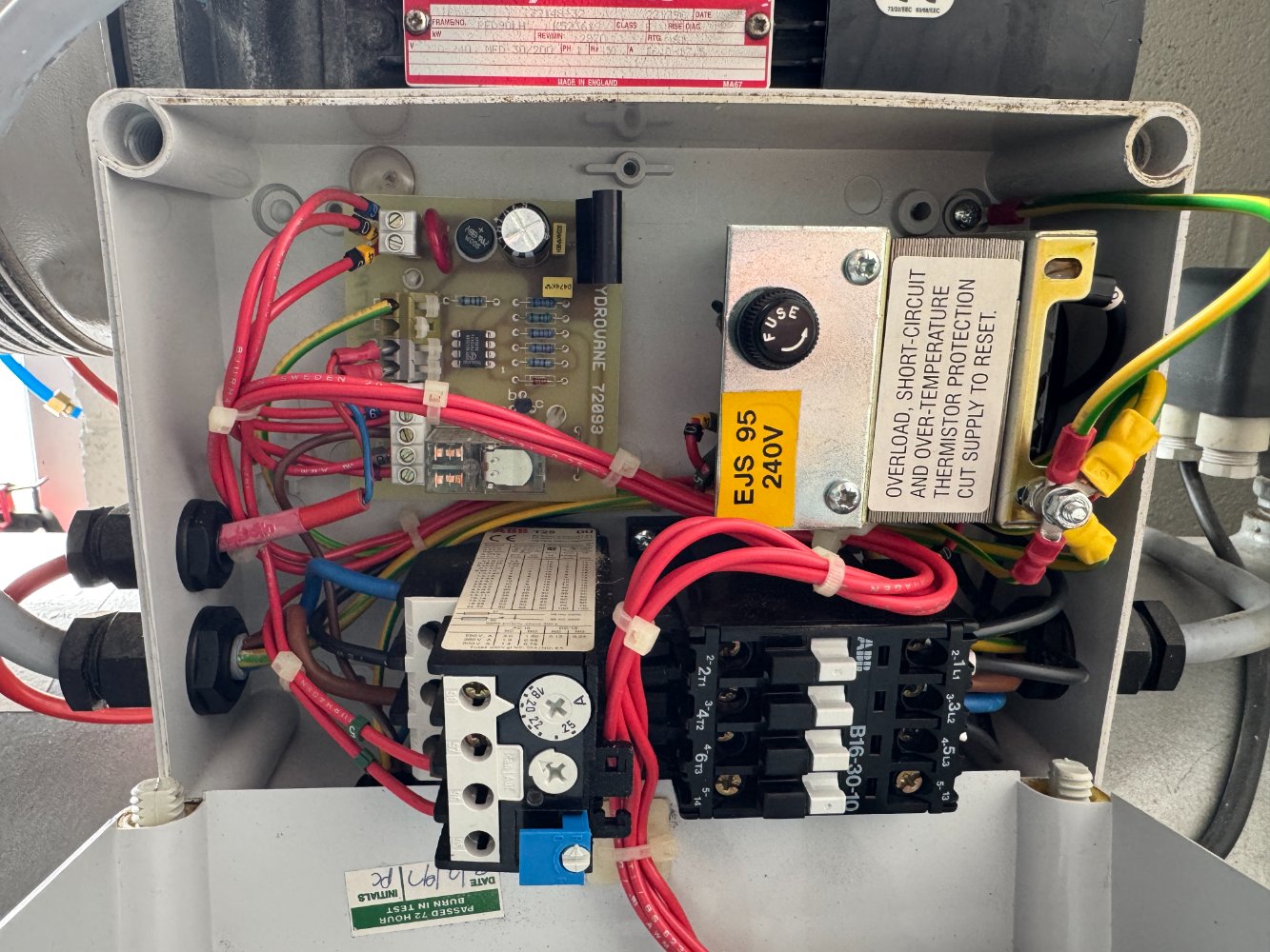

Hi all. I've got an older Hydrovane 502 compressor. This compressor worked flawlessly with my Haas Super Mini Mill for several years after I got it used. Then for various reason I had to put it in storage for a couple years. I recently dusted it off and wanted to get it back in service. I did a full filter and oil change on it. For some reason though it's having intermittent startup issues. I made a video of the issue: link here: https://tinyurl.com/nhfamdyt.
Sometimes the compressor will fire up fine. Other times it will hesitate and then hit full speed (this is shown in first startup in the video). And other times it will just "waver" and never hit full speed (shown in second and third startups in video). Note that I wait a little while between startups because I'd read somewhere it was bad for the caps to power-up in rapid succession. Again, the startup is erratic - doesn't seems to matter if there is already air in the air end or not.
A local tech thought it might be a faulty check valve from the air end into the receiver. I replaced that and it's still erratic starting. (And it will do it if I disconnect the air end from the receiver and just blow directly out from the airend, so no check valve involved.)
I also just replaced the start capacitor. Again, erratic - sometimes will fire up fine. Other times will waver.
Any other ideas? Could this possibly be a bad Run capacitor? Thanks for any input. Cheers!
